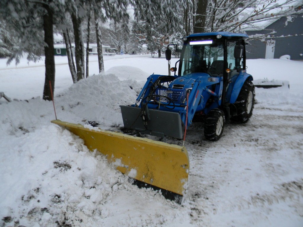

In the past week we had a couple of 2-3" snowfalls but ground was warm so it settled down to an inch or and I didn't bother to plow. This morning I got a chance to try the newly modified plow. Had about 6" of snow last night. Plow worked well on gravel driveways but digging up some gravel. Had to adjust the tilt a little on the paved driveways so the cutting edge was touching. Blade floated just as it would if on a truck. In the garage I initially set the loader arms so the A frame is level and adjusted the skid shoes so the cutting edge is an inch off the ground. That way when the blade is lowered on gravel drives the blade sits on the shoes and skims snow just at the gravel level of the driveway.

Got another 6" since this morning, about 12" since last night with more on the way. Lake effect snow warning is in effect here until Sat 7PM. Could be anywhere from 18-28" depending on which way the wind comes off the lake. Plow blade / shoes are still digging in the gravel because the ground is not frozen. I guess its job security as I'll have to rake it all back come spring. Here's a couple pics.

Same problem if the ground is not frozen.I use my seven ft.rear blade when conditions are like they are now.
