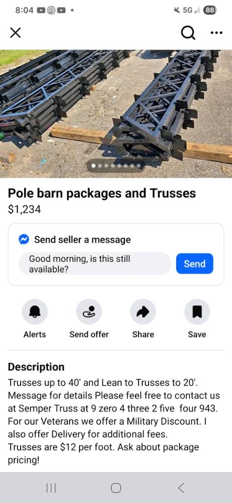

With the prefab metal pole barn roof trusses, you can get 12 ft wide bays. You use 2x6 purlions, attacked to the truss flange, in the upright position to get the 12 ft span. It does work, but in the kits; i dont like the idea of walking on 29 ga metal, with 12 ft spacing; just from an installation stand point.
So, the trusses for a 16 ft building will cost right around $200/ea; and you can free fly atleast 12" of metal past the last attachment; so; thats easily 18 ft of cover. The same truss for a 14 ft building is about $170. Unless there is a specific, hard, property/placement issue; I would go atleast 16 ft

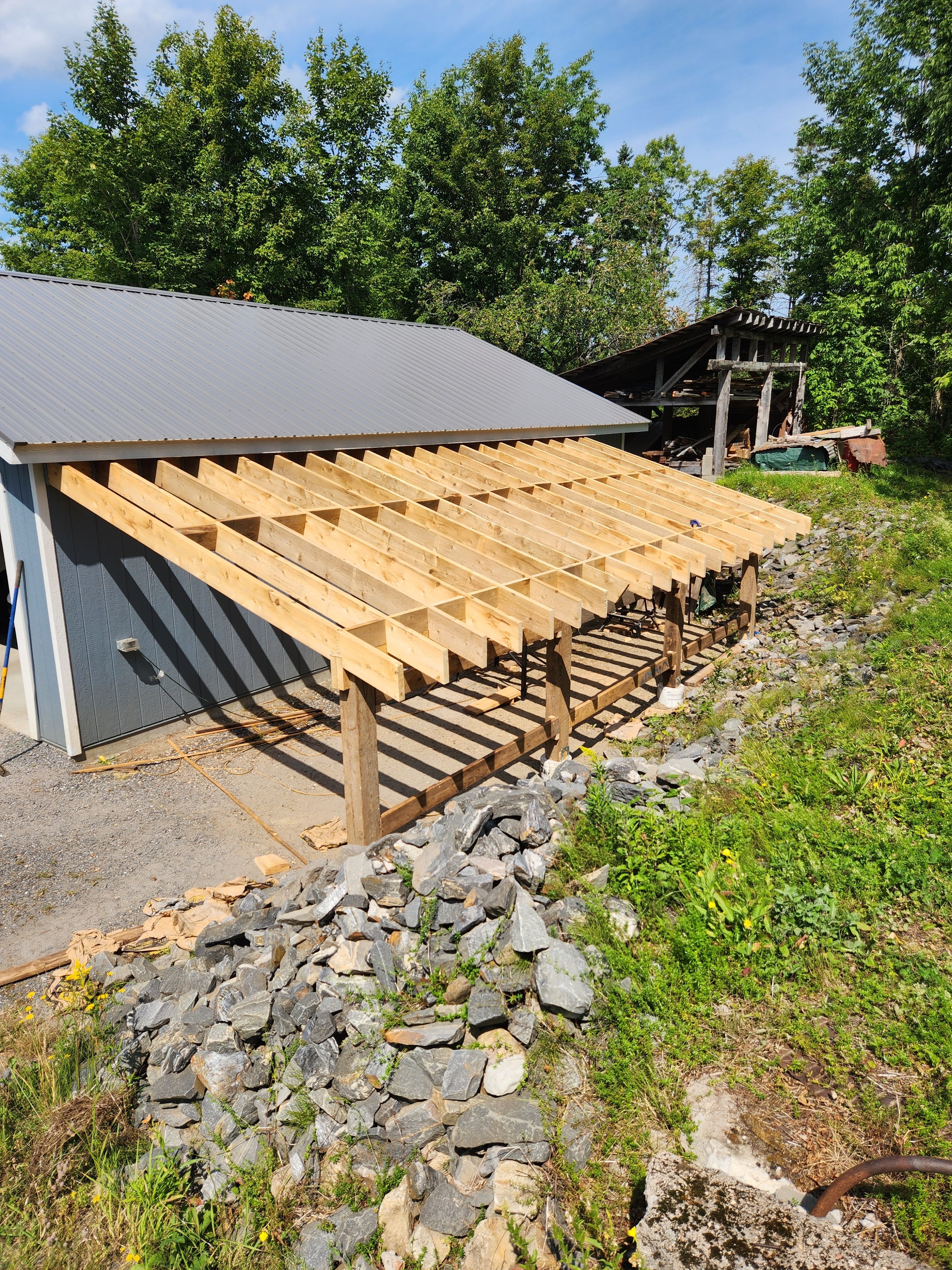

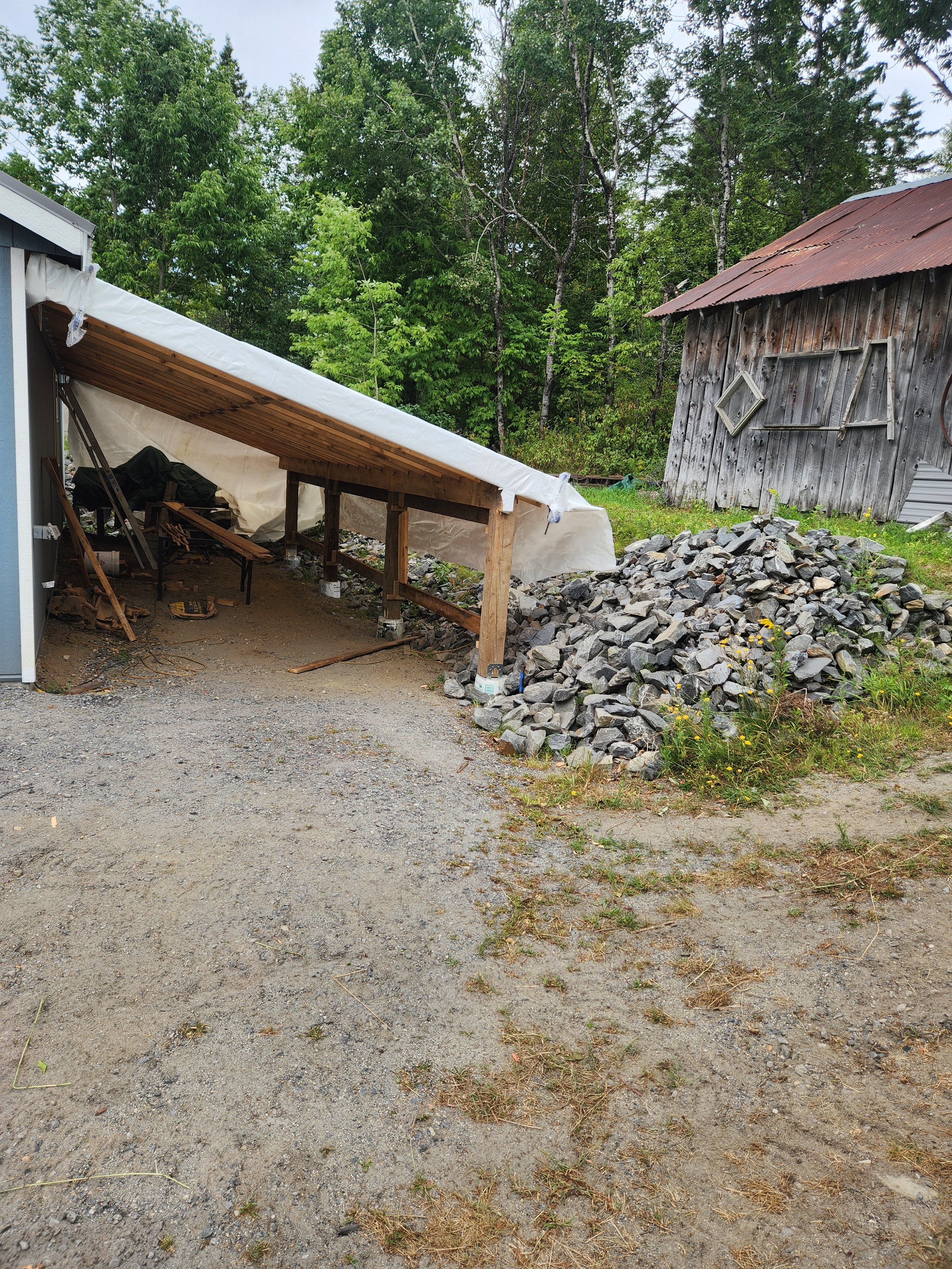

I wanted to keep tractor closer to driveway for snow clearing in winter. My neighbor gave me wood that was sawn on my property sawmill, new old stock, 40ish years ago. (was for a garage for his wife) While it will be a tight fit with ROPS down, it will fit. Still deciding on door style to keep snow out, as wind drifts it in front of garage and now lean to. Garage to inside post is 10'. 8' tall at garage down to 58" at post x26 feet long, as I can keep implements inside with plenty of room. Will have a temporary plastic sheathing on roof until that material is purchased. The best I could do with existing topography is 4:12 pitch, so I will have to do some snow raking if the snow doesn't slide all the way off. Garage is 5:12 with no issue of snow shedding on it's own. There is a 4+' rise going up to barn. Once I gather enough metal roofing, I'll lay purlins down on top of HD plastic.
