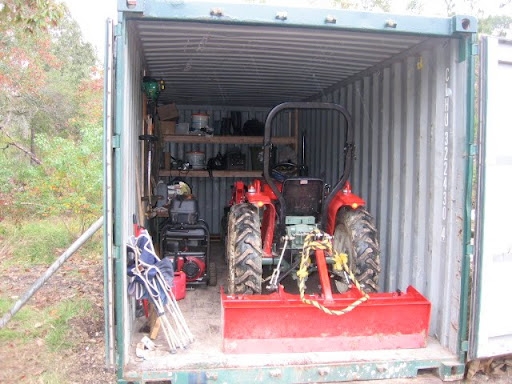

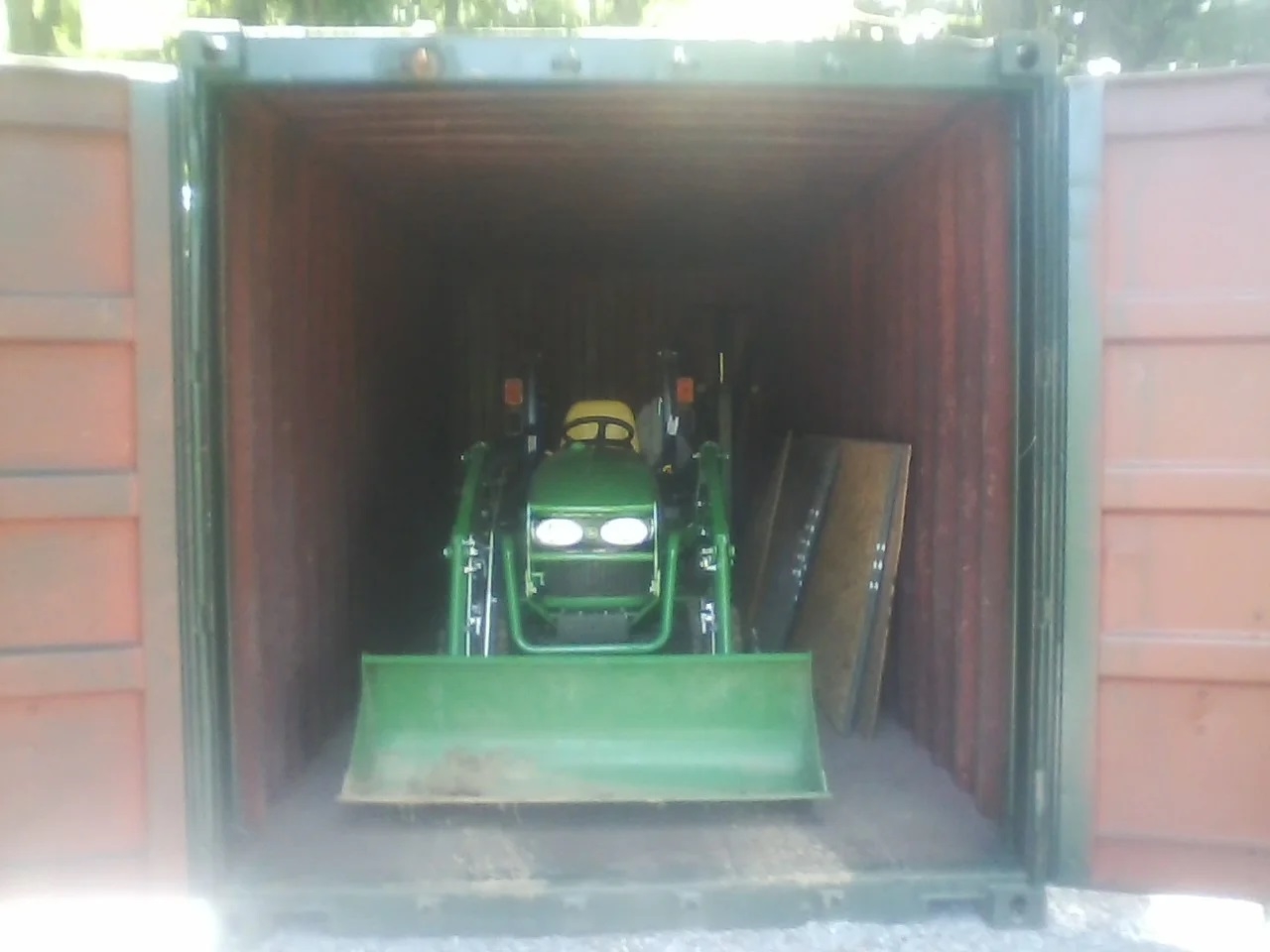

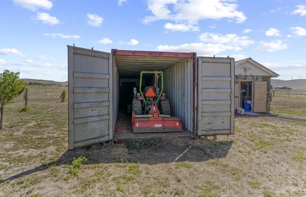

   / Advice on building a tractor shed? #67
With today's prices, being cost effective now, these units are in high demand,
8x20 run $1,800 to $2,500 right now. A little clean up, primer and paint, it makes a great sealed storage solution.
Benefits are air and water tight. Keep the critters from making nests or chewing on the wires.

Was just thinking about doing this now that that the prices have come back down. Place one along side the pole barn with enough space to park the trailers, then build a lean-to type roof over the top using the container as the outer wall.
