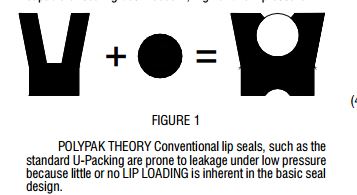

So I decide to repair my leaking front end loader tilt bucket cylinder on a Ford 770 FEL. There is a photo of the seal I'm discussing at the forum link below:
http://www.tractorbynet.com/forums/...70-loader-cylinder-rebuild-2.html#post3906279
My mistake is ordering a kit on EBAY. Everything fits except for the one seal. Our machinist at work says they've sent a seal that is 250/1000 thick, and it should have been 200/1000 thick.
When you look at the parts breakdown online or even calling the Ford tractor dealer, it simply says 'Source locally' for this seal. So I'm confused how the seller even knows what to supply without any dimensions provided?
The original parts callout is for an O-ring and a 'leather washer'. What came out looks like the seal I was sent, though the original was totally disintegrated so hard to compare.
I tried calling some local hydraulic hose shops for advice, but have struck out. Next time I'll just buy the Ford kit and forget about it. I guess I know two of the diminsions already ID= 1", Thickness = 200 thou.
Are these type seals readily available?
Do they need to be a special material to stand up to hydraulic fluid?
Any advice on how to proceed appreciated, Dean

Thanks to everyone for the comments. What I ended up doing was buying the Ford OEM kit and had it mailed to my house, as I wanted it back together. But I couldn't return the old kit, as I'd driven in the outer seal, so no way to take that out that seal without leaving marks. FYI: Ebay kit from what appeared to be a reputable dealer who had a lousy parts supplier $38, Ford OEM shipped from my local tractor dealer $60.
wdchyd: I can see why you're confused as to sizes listed, as that was a lousy post on my part. In the end what I needed was ID= 1.0", OD= 1.25", and H= measured .2" or 200/1000".
So then I figured what the heck, if I can't return the EBAY kit anyway, I'd go ahead and get a replacement seal and rebuild the other side as well. Attached is a photo of the seal in the EBAY kit (thicker) compared to what came in the Ford OEM kit. So I looked around and found out what most of you already know, the seal is a Polypak type, which I assume is a Parker trade name. It is a combination of V seal and an O-ring, as shown below. I found the seal at Hercules Seal, which was referenced somewhere on the forum. Delivered $12. The Ford OEM seal does not fill the entire groove, and seems like it's more on the H= 1/8". What I ordered was 3/16" which should fill the groove, though it apparently doesn't matter.

Seems the key is finding a shop that will work with you on the parts. I had asked the lead machinist for recommendations on such shops, but when I called the ones referenced, they were $100 minimum. Glad to hear that the seal being too thin is not an issue.
wdchyd: I had seen the seal you reference, but have to admit I'm out of my element here (I'm an electrical), so stuck with the basic O-ring style as was sent in the EBAY kit. I do like the Hercules site, as they had more information than I could find elsewhere on the individual seals.
Thanks for the help, Dean
