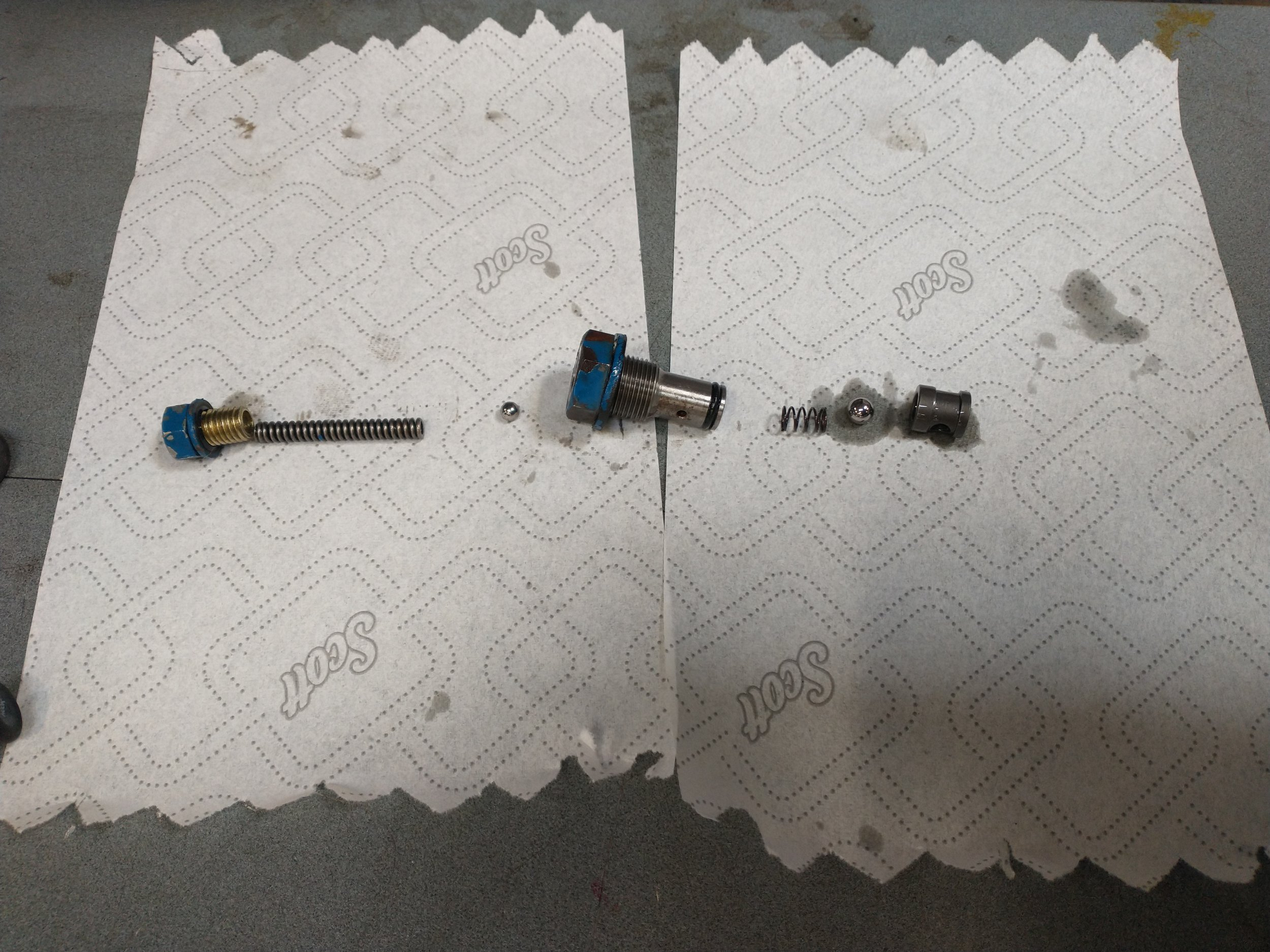

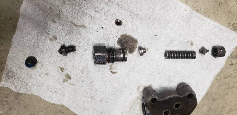

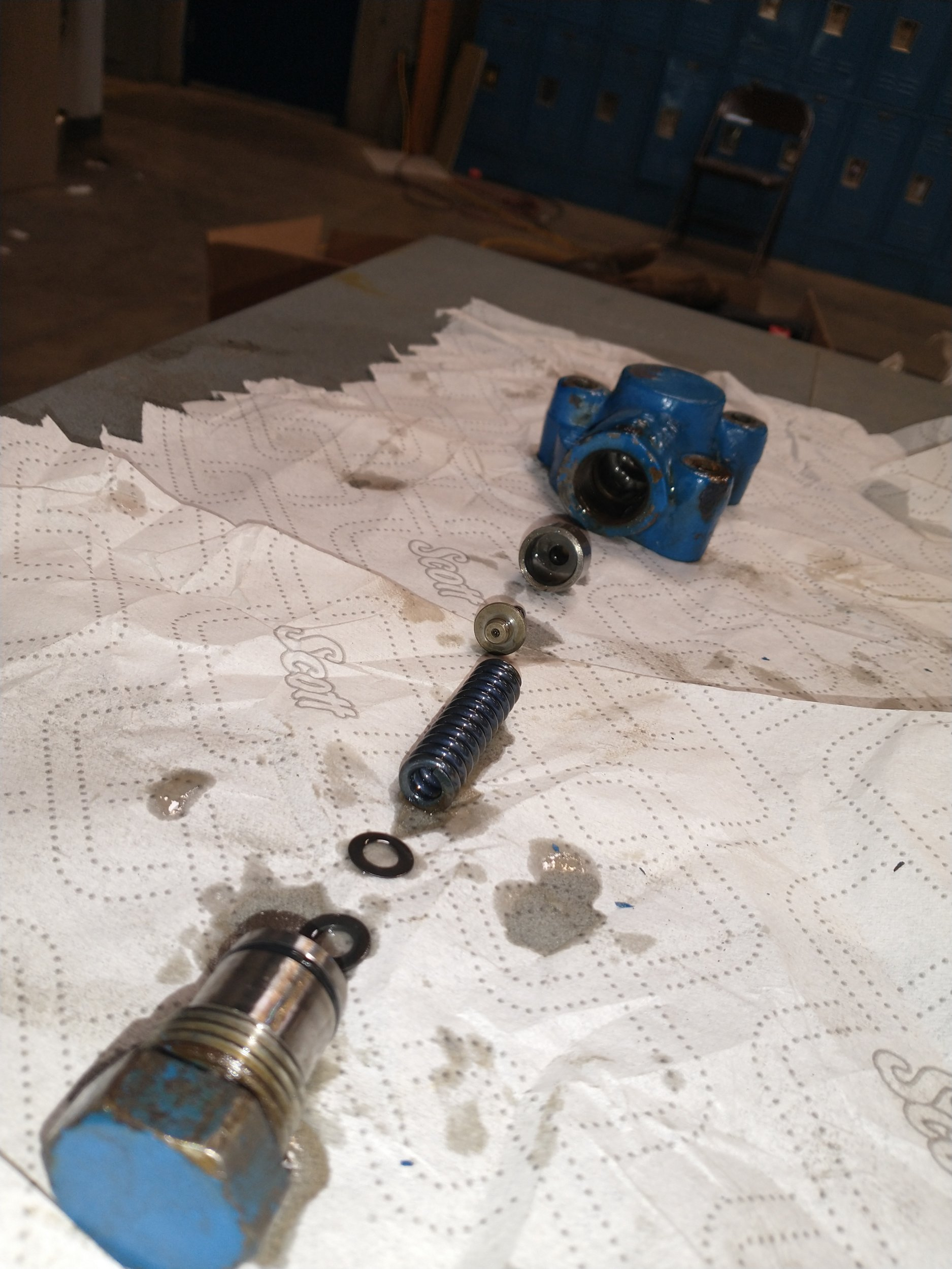

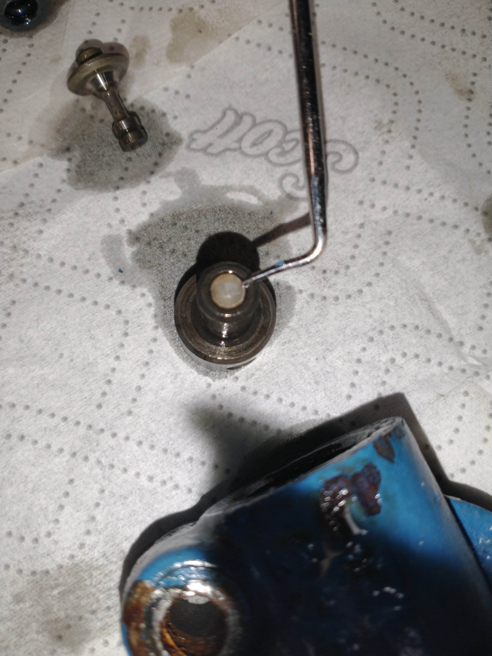

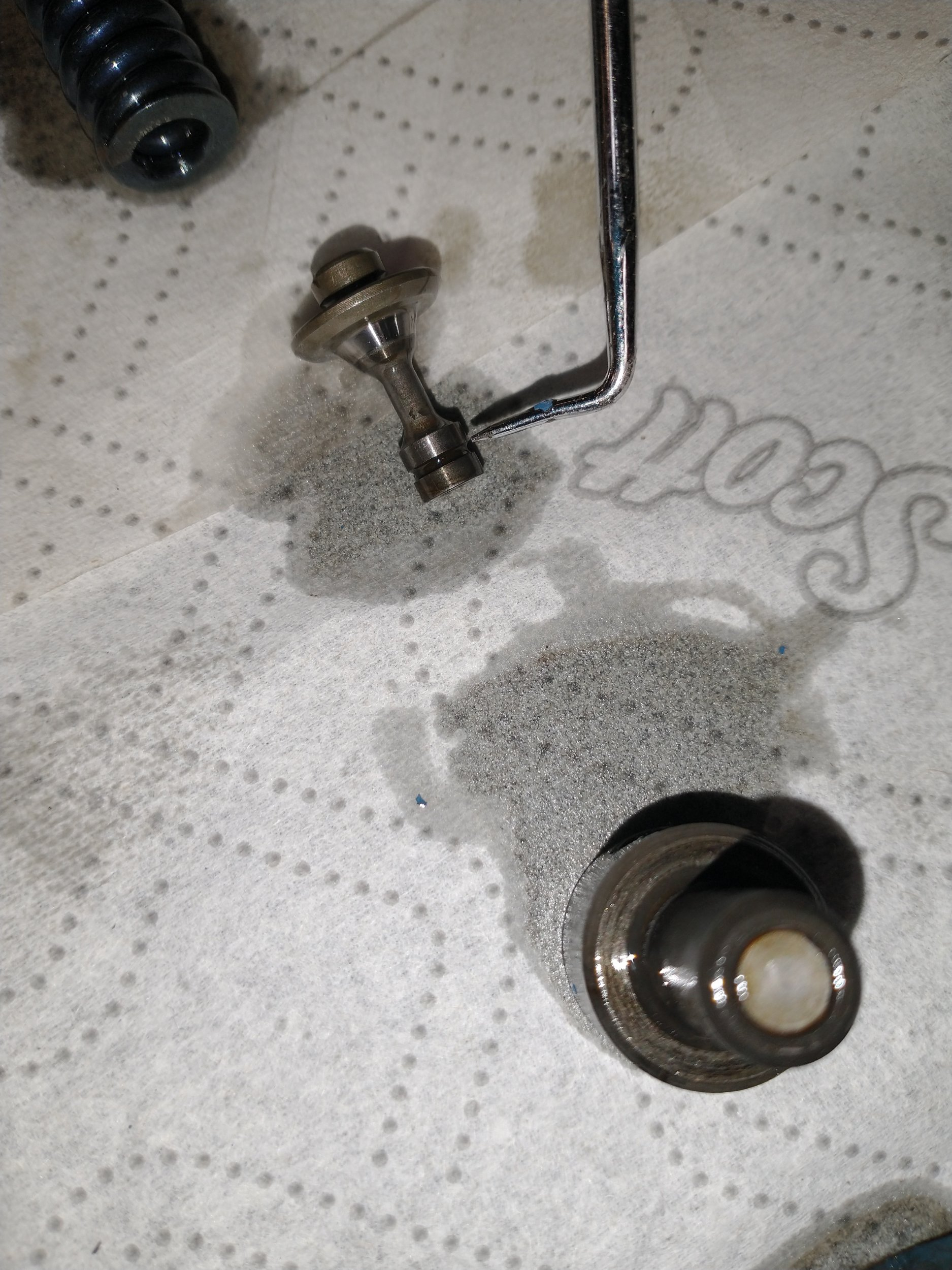

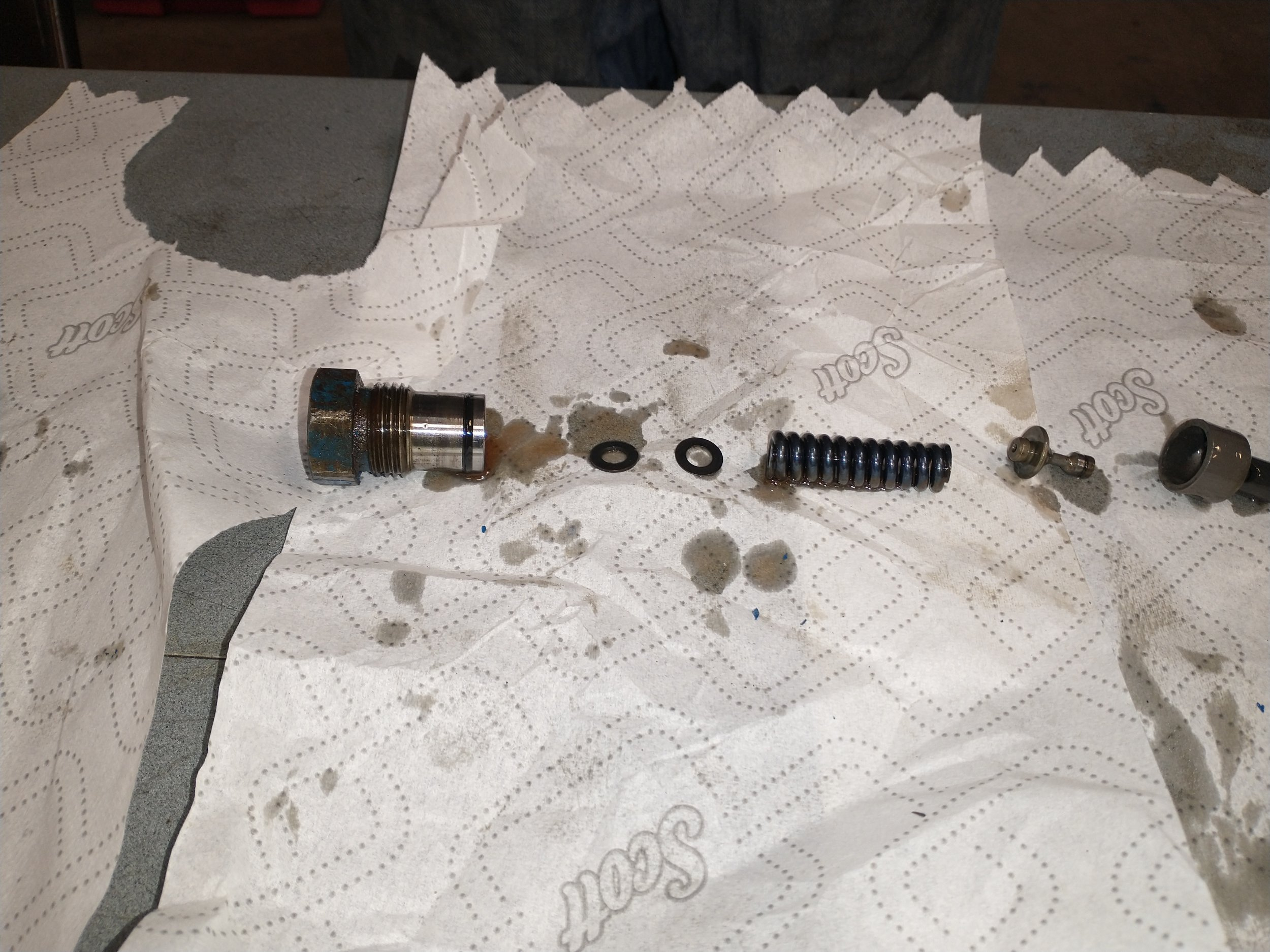

I am attaching pictures of my relief valve and check valve. I disassembled them again to make sure that they were put in correctly and all the seals looked good. They're not many o-rings or seals in them but those that are there look good to me. The only question I have is with the relief valve the parts manual does not show a groove in the valve poppet. See the picture where I am pointing to it with a pick. I am not sure if there is supposed to be a o-ring there but I do not think one would fit clearance wise. Also the plug at the end of the housing is solidly stuck in there. I did not try to pound it out but I'm not sure how free that is supposed to be. That will be the second picture I am pointing to with a pick. Before I started pulling things apart, I turned it on and opened up the port. The first video shows no flow. It took about 20 seconds for flow to start which can be seen in the second video. As you can see the fluid is very foamy. There is no water in it. When the phone settles it looks brand new.
This leaves me thinking that it may be time to pull the filter housing to make sure that there is a good seal there. If it is not that then it has to be the pump unless I'm missing something on the top end. The rebuild kit for the pump runs around $160 I believe I found a place that sells new aftermarket pumps for $300. In Europe they sell these pumps for around $130.
Also you are absolutely correct that the suction did not damage the screen. It was mechanical damage of some sort. I do not know if something got in there and tossed into it by the gears in the transmission or if someone did it. I suspect that it was something that was thrown by the transmission because the housing did not look like it had ever been removed when I pulled it off. I do not know if I still have it sitting around in my shop somewhere. It was about 4 years ago. I will have to look and see what I can find. If I can find it I will post pictures.

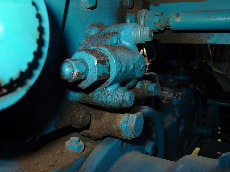

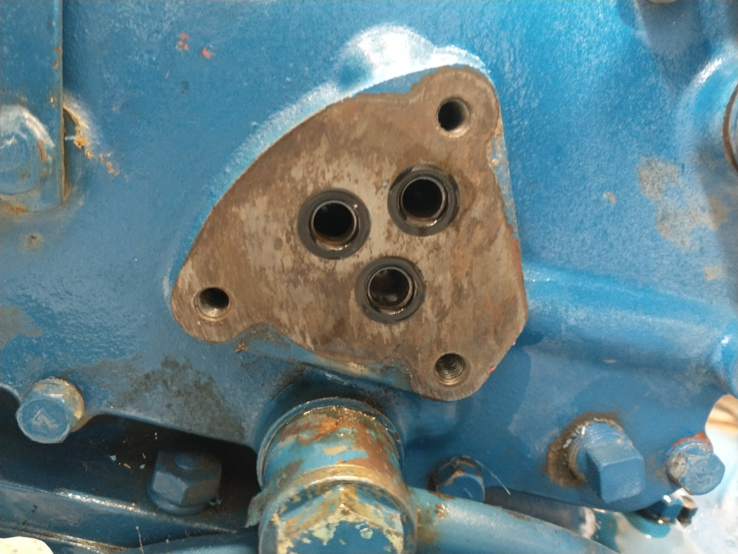

Here is the outside of the relief valve that I believe it's the newer style than yours.

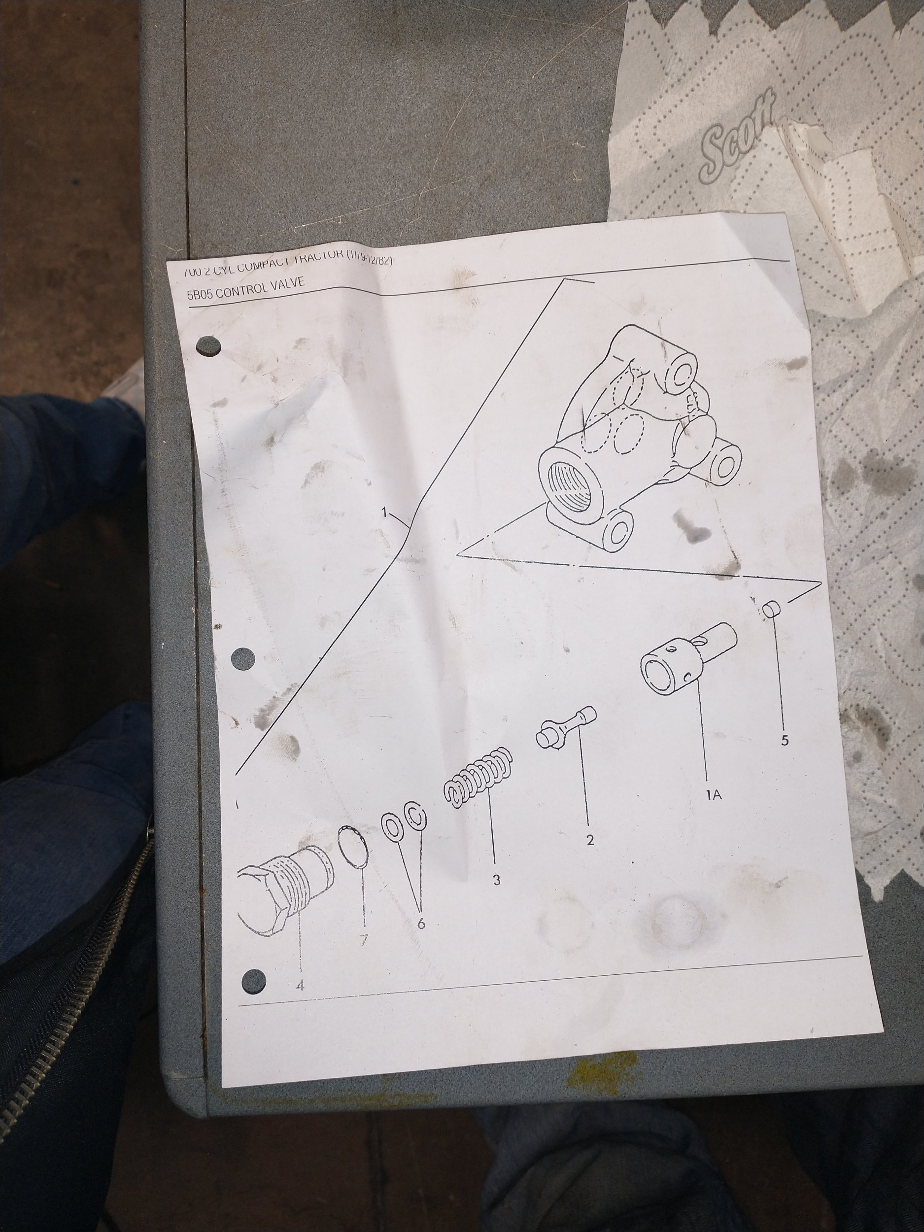

Good pictures. I did go to NH website and looked at parts breakdown for the relief device. It is exactly the same as the picture you have. Mine was pre-1979 and is adjustable as the pics show. Yours use shims to add pressure by increasing the spring stiffness. what is a bit curious is the groove as the the website does not show that and on your s it is there and machined. I can't explain why they machine a groove that serves no purpose. I am sure I can get a o-ring out of my HF , metric rubber o-ring assortment to fit one in there. like yours, the NH website shows plug #5 next to 1A or the housing. Did you see that plug #5? I don't see it in your picture there.

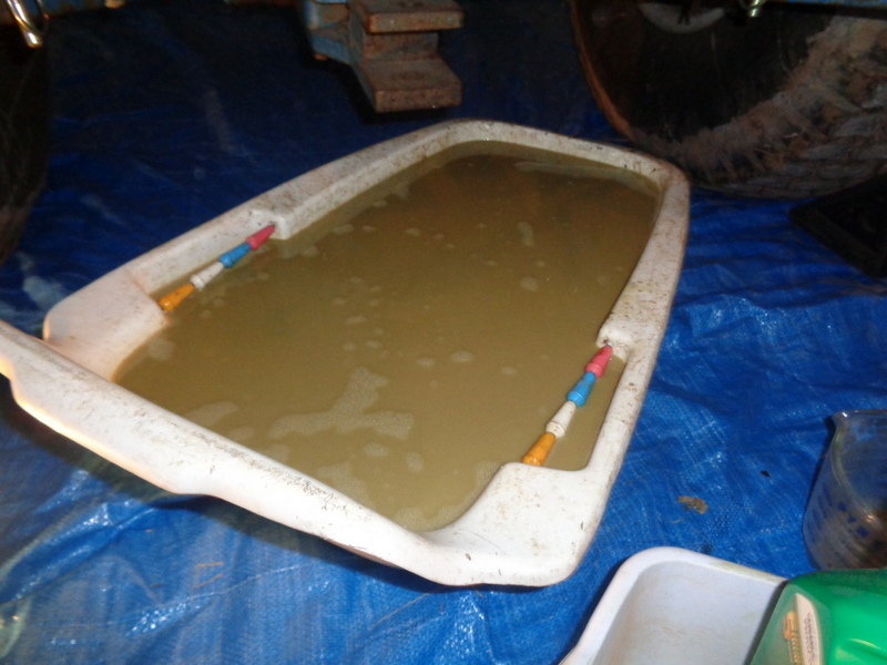

Your oil does not look good on the video, is it all foamy or just dirty? did you use right hyd oil,Ford 134?
All the lift cylinder head check balls look ok and I don;t thing there is any problem there.
If it were me, I would take one of the shims out and then fit an o-ring on the groove and give it a try. Now I have not done that but can't see harm doing it specially since you are meticulous in disassembling the parts and putting back together.
If you decide to re-visit the suction screen then I would suggest cleaning the floor of diffy like the pic below suggests. The shop vac is connected to the any plastic bottle and it collects the crud without messing up your shop vac. do put a small hole in the handle so the vacuum would not collapse the bottle.
At the end hyd pump might be tired and needs replacement but you need to exhaust all options before going to last resort. if issue lies somewhere else then the pump might not be the cure, it is $$$ and not returnable. Let's just keep digging at it and hopefully we can find the problem.
Let's work on suction screen, cleaning the diffy and making sure you have the right oil.
PS. I just re-read your post. you addressed the question I had on the plug #5. It looks to me that the pump pressure should work against the plug to lift the popper against the spring. it might be e tight fit between plug and the housing but has to able to move. My version of it seems to be a bit easier to see how it works. Hyd pump does have an internal bypass to help lubricating gear shaft against the bushing. I am wondering if that causes the cavitation and foaming. Cavitation almost always happen on the suction side of the pump though. I am stomped a bit but keep trying like I suggested above. I kick myself for not buying extra pump overhaul kit and lift piston seal since it was cheap when I bought them.
PS2. is block #5 is the one you pointed on picture before the relief diagram? is there another plug on the right side of the relief device? wondering what block #5 purpose is. do you think the popper just rests against the block, flat surface to flat surface ? 3 holes that you see on top hat cover of the diffy is one pressure from pump, second is relief to the diffy and the 3rd is pressure to lift spool valve.

The fluid is not dirty. When I first saw it come out like that I thought it had water in it because it almost looks that way but when it settles there's no water in it. It is just foam also when I drained it out there was no water in it. The phone indicates to me that air is getting into the system somewhere I would think. I really wish there was a way for me to put a game right on the hard pressure discharge line before the relief valve or right on the side of the pump to test it. I may check to see what kind of thread the banjo bolt is and see if I can get a adapter too put the gauge right on the side of the pump. That would be very telling.

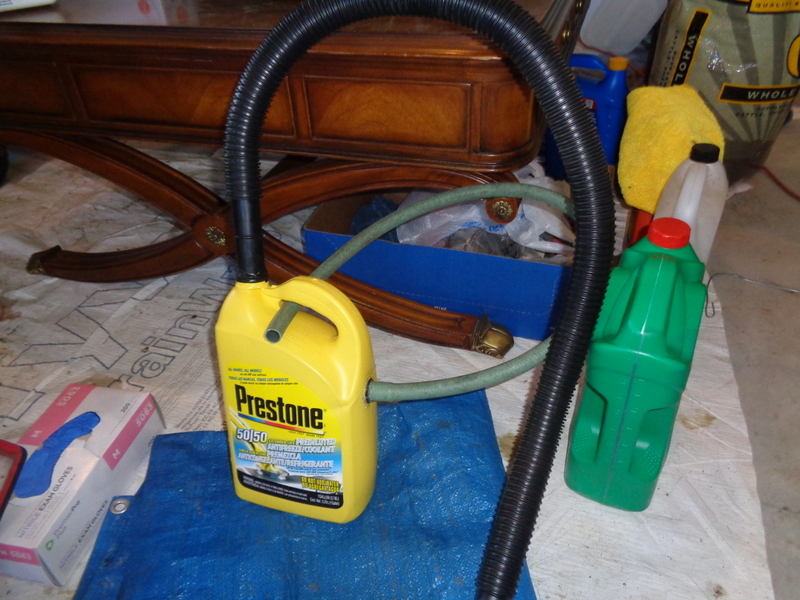

I like your suction bottle idea. I have an old shop vac that I just sacrificed for that purpose. I do not remember how well I cleaned the bottom of the differential. When I deal with something as dirty as this was I usually scrub it out with a little bit of diesel and really clean it and then flush it with some extra hydraulic fluid or oil depending on the application before I put the final fluid in but I do not remember if I did that in this case. I am kind of thinking I didn't because I was worried about whether or not I could get all of the diesel residue out and I didn't know what type of seals were in there that I could not see.
That is the plug I'm talking about. As you can see there is some don't get looks like between the assembly the plug is in and the plug that seems to be jamming it in there. It appears at the end of that piston looking part of the puppet rests against the plug which risks against the end of the cylindrical space that the assembly goes into. I'm not sure the purpose of the plug. Maybe I will try to press it out. I am not really tried beyond trying to push it out with a pick.
I think that plug is harderend strike surface for the poppet valve. When you dead head the pump by raising the 3 point to the highest point then the releif chatters and lets you know to lower the 3 point. That sound is caused by the poppet hitting that surface. On mine looks a bot different and conical shape poppet on mine hits the hardened seat and chatters.

My oil originally was nowhere near as gunky as yours. It basically just had moisture in it. I'm still baffled as to why it would have worked fine until I changed the fluids and the filter. I will check the filter but as I think about it logically you are absolutely right that it should be leaking if there is a air leak on the suction line. Also, I checked and replaced the o-rings on the banjo bolts on the section side. Is it was leaking where the filter/strainer attaches to the side of the case, it would not suck air from there because that would be independent of the basket. I'm really thinking about just popping the top off of the case between the seat and the shifters to inspect down there.

If you are talking the top differential case where the seat is then on this model you do not need to do that for inspection of the seal of lift piston or rock shaft. They can be done from the front taking off the lift cylinder head.
There is a tapered surface on the puppet as well with mine so I am not 100% sure how that works. I still may see if I can free that plug up.
Tapered surface (conical in my case) mates with the seat to resist the flow with spring in the back pushing valve away from the seat. Pressure developed by pump flow against the tapered poppet lifts it up to maintain pressure that the spring stiffness causes. it is sort of safety pop off , lets say on a boiler. It opens up to protect boiler or pump in this case.
