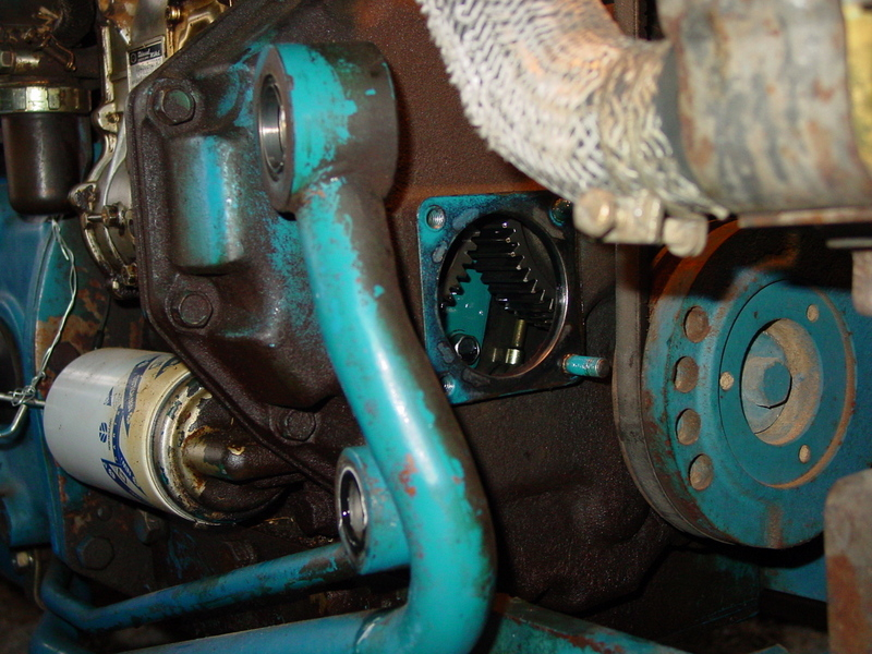

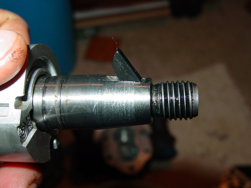

1- there is a retaining clip that holds the the shaft seal. Don't force it, no strap is needed. Just need the spring clip pliers to remove the clip and then driving shaft will come right out even without shaft seal removal. Make sure to use hyd oil to keep everything lubricated. Your rubber seal looks okay and it was just like mine. The nylon one is the backer to keep the rubber in place. The nylon one does not do any sealing at all. Take an exacto blade and just carefully trim it. I hope you put witness mark on the 4 bushings. They best go where they came from so the wear pattern would not be disturbed. I don't see any scratches on the pump inner housing so gears should be okay too. Gears are a lot harder than the aluminum housing. I would put it all back together and as cleanly as you can. I don't think your pump is bad. Like I said before ,pump can be dissembled non-destructively which is a good thing. I think your issue is either on discharge pipe (smaller dia) or on suction pipe (larger dia). On smaller pipe , follow the routing all the way to right side of the tractor and you see the relief device. There is a spring a poppet valve that we need to check if it is working okay or not. On the suction side (larger dia) we need to make sure that you do not have any obstructions. The o-ring for the banjo connection can be reused. Put the pump together and try it out. I hope it comes back to life. if not , then we need to investigate further to find the culprit. Good luck and report back.

I will put the pump back on Monday. I did not put witness marks on but I do know that I got him back where they came from. I was very methodical and how I laid everything out. One of my students who has been doing some of the work for me has a friend that apparently specializes in this vintage of tractor. He is pretty sure it is a valve or seal in the assembly under the seat. He called it the "top hat" and I guess when the cylinder is pulled out it kind of does resemble a top hat. I really do not think the problem would be on the discharge pipe. If it were leaking, we would have a mess. I did not pull the strainer out but I would not think it would be that either being how clean the fluid was when I drained it out and the fact that the strainer was brand new and it has not worked correctly since I replaced the fluid and strainer. That is really what does not make sense to me. It worked perfectly until I changed the strainer and the fluid. The only problem it had was the 3-point creeping down if you let it sit for a bit. That problem has been fixed with the new cylinder seal. I will keep you posted and probably pick your brain more as I move forward. As always thank you
/ Yet another Ford 1700 with hydraulic issues... #10

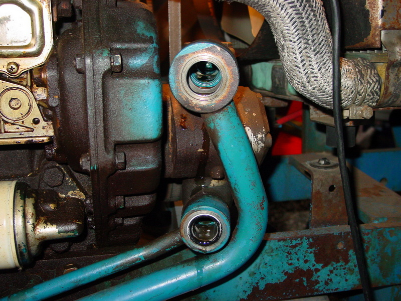

Ok. Sounds good. When I talked about discharge pipe , by no means I was talking about a leak at all. That discharge pipe goes to a pressure regulator. Pumps makes pressure there against a spring. It does have a by-pass to tank or diffy in form of a pressure pop-off . if for whatever reason the flow is diverted to the tank then you would not have any flow to the spool valve and then to 3 point. The pressure you will register would only be a static pressure due to the weight of whatever you have hanging from 3-point lift due to trapped oil in the lift piston. That pressure can vary all over the place statically and it is not pump operating pressure. Once you lift something with the 3 point, at the desired height all the pump flow then is diverted to diffy from the spool valve in neutral position. in that fix, once the tractor is off the pressure registered is just a static pressure.

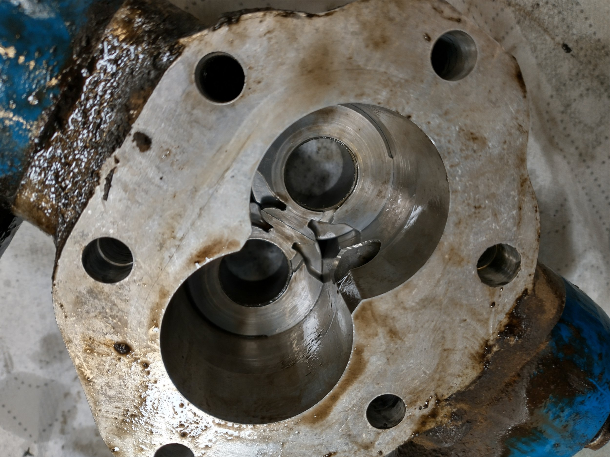

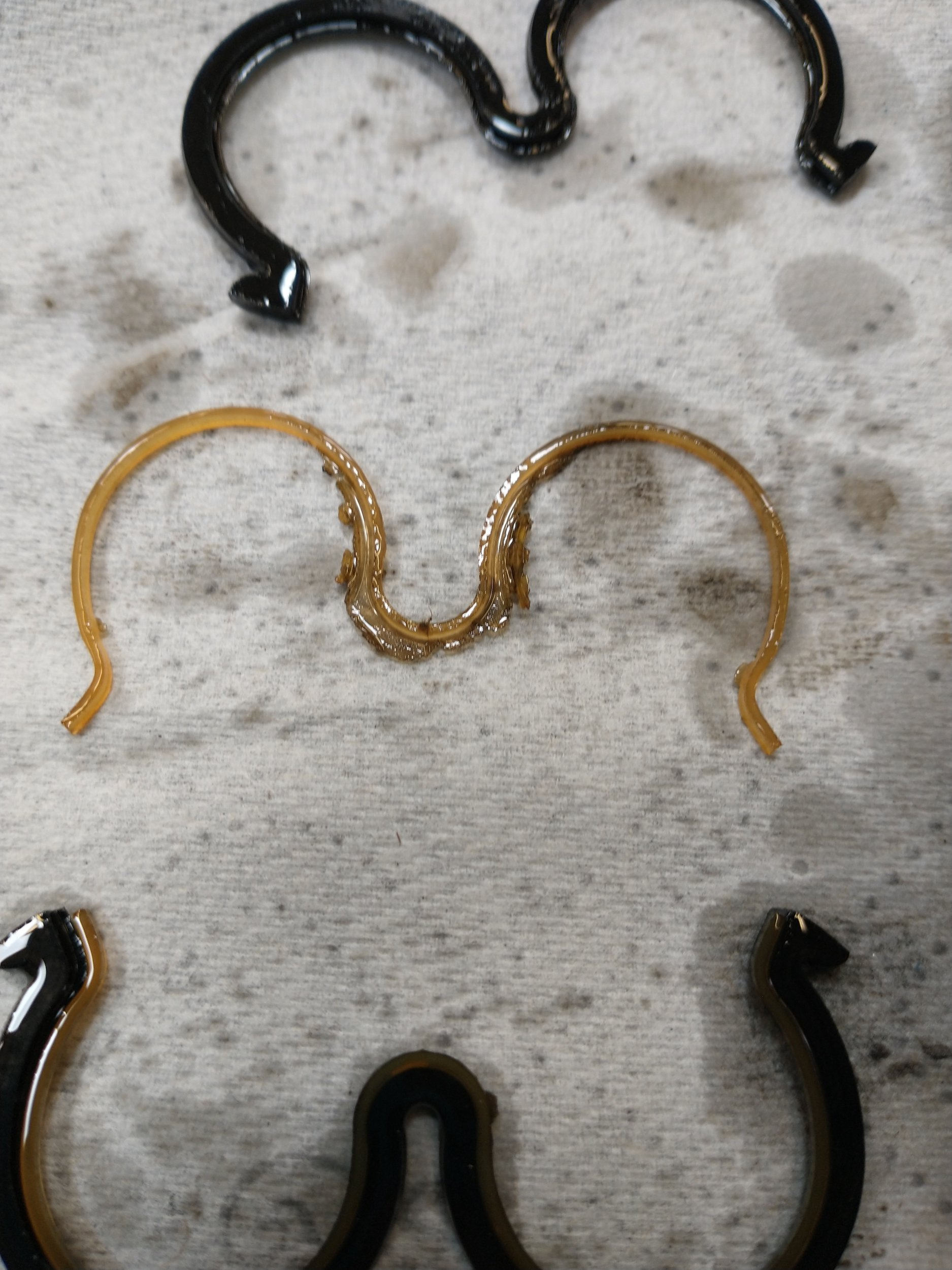

I put the pump back on today and got it seemingly primed. The hydraulics seemed even weaker than before. I would have to lift the hydraulic arms for the Piston to move and then they would stay up and lifted position. I pulled the gauge off of the test port and the oil barely trickled out at half throttle. It also was very foamy which seems to indicate to me that either it is not fully primed and or air is getting sucked in somewhere.
Thinking about this logically, the system was working fine before I changed the fluid and changed the strainer which had a hole ripped in the screen. I did not touch anything on the top end. This makes me think that the problem is more likely to be on the supply side of the system rather than the relief valves. I have checked the o-rings more than once on the suction line. As much as I hate to say it, I'm thinking that maybe I should pull the strainer and double check it to make sure it is not somehow clogged up. I pulled the suction line off of the strainer and looked at it from the inside but I could not see the screen part. I also thought about putting flex seal on the outside of all of the fittings. This would not be a long-term solution but when we were trying to troubleshoot hydraulics back in the day we would smear grease over fittings to try to pinpoint an elusive leak. This would be a similar concept. I feel like I either did not get a good seal on something on the suction side, somehow clogged up the strainer, or damage something else on that side. I also wonder if the pump even though it looks good is weak and possibly the previous owner tore a hole in the strainer to allow more flow. With no metal in the case or any other sign of damage in there, I have no idea how the strainer would get a chunk of the screen ripped open unless it was done intentionally. Also, having that opening in the screen would mean the pump would be subject to larger abrasive material.
Is my logic off base?
/ Yet another Ford 1700 with hydraulic issues... #12
There is a check ball and spring(check valve, on way flow) in the lift piston head. That would trap oil back in the lift cylinder. The only way 3 point arms drops is either check valve is not holding, lift piston seal is leaking or installed incorrectly or if lift spool valve is leaking.
Hole, if any in the strainer will only help with prime as there is less suction pressure loss. Saying that it can allow crud from the bottom of diffy floor to enter the suction pipe and in to the pump. on mine, I shop vacuumed the floor of diffy with a shop vac and with the strainer removed. I was able to get at least 2 quarts of oat meal looking crap from bottom of diffy collecting over perhaps 25 years. I would drain the hyd fluid in clean bucket and inspect the strainer and clean the floor of the diffy for sludge. since the oil is clean then straining it thru a coffee filter should clean it up. it will be slow. I will fix the hole in the strainer. if you decide to do so, take pics and post. There might be tell tale signs.
I did not touch anything on the top end. This makes me think that the problem is more likely to be on the supply side of the system rather than the relief valves. \
supply and relief are both on the same part of the system. There is particularly nothing significant with the pipe unless it has an obstruction. The issue is, like I said before the relief valve spring is what causes the system pressure. It can also divert the flow to diffy without going to 3-point if the poppet valve is stuck open due to crud collecting there. The relief valve need to be opened and inspected.

Suction line is under suction when the pump is running, it can only suck air in when the pimp is on giving some clue to foaming. it can leak a bit of oil while the tractor is parked if the hole is large enough or the flat gasket on the strainer is not sealing tight. I , personally would clean u the joint , smear a thin layer of RTV blue on the gasket, let it skin and dry out a bit and put it back together.
pump can be weak or seal due to slight damage to nylon backer is not sealing well to make pressure. Do you have any pic of the gears? pump is expensive to source. I will be attempting overhaul rather buying a new one. I still don't think we're where we should logically think of pump replacement yet.

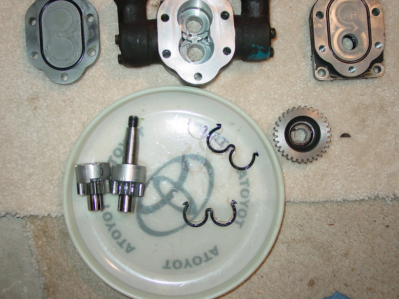

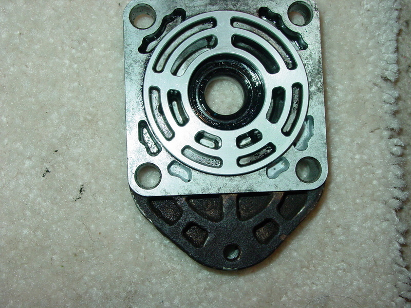

pics
pump suction cannot poke a hole in the screen. I think it was done intentionally. Any piece of metal in the pump would have certainly left tell tale signs. The interior case of the pump does not support it. It looked smooth. Any damage on the gears?

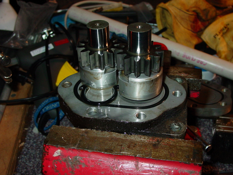

simple representation of how a gear pump works. gear pump is one type of positive displacement pump.

Thank you. I understand the concept of how a gear pump works but I was trying to figure out if there would be something or pressure against the shaft seal.
