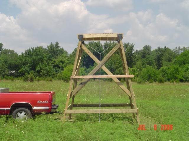

Stx awesome stand, this summer when I build mine I may have a few questions for you. I have the spot, now I need to find out how far I can dig down, there may be bedrock and that may change the plan. thanks for the pics they are great!
Ask away, I'll be happy to help. If you can't dig down deep enough, you can always flare the legs for the base, like this -
They sell elevator brackets so you don't have to worry about getting the angle just right - 4x4 Elevators,® Set of 4 - 83819, Tree Stand Accessories at Sportsman's Guide
Then you can use guy lines and mobile home anchors to seady it in the wind. I have soil that's easy to dig in so it was easier/faster/cheaper for me to just set my posts in concrete.

I placed the 4x4 posts on top of the ground, then hammered t posts into the ground along the side of each 4x4 and screwed the t post to the 4x4.
