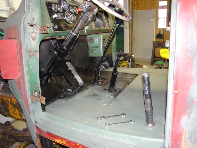

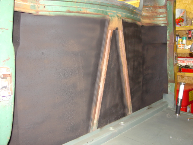

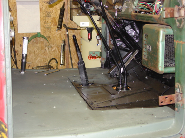

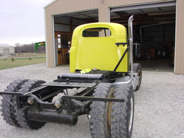

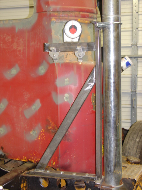

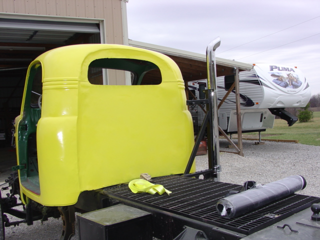

I have had good luck with a Hobart 140 mig, I have some old threads like from 2006 when I bought it, on here from that welder, it is a set up for 120v and has welded anything I have thrown at it. I also have a Hobart AC/DC stick welder for the big stuff, if you have never used a mig you will kick yourself for not buying one sooner.
I use flux core in it and have not had problems doing sheet metal work, little slower and usually weld thin stuff with a wet rag in my hand to keep the metal cool. Because of the time it takes I have a door on another truck I am working on that needs a patch panel and I think I will get a bottle for it.
I used the 140 to with flux core to do the floor, build the exhaust mount and fill in all the holes on the back of the cab
