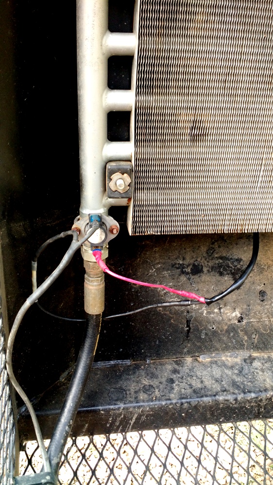

STATUS UPDATE APRIL 26th ... the saga continues ...
OK - first off, I screwed-up on my initial fan replacement part order... the correct/original fan size for my PT1430 is an 11" fan - NOT the previously assumed 12". So please ignore and forgive my previous posts with the SPAL part numbers for 12" fan options. Luckily I was able to return the first 12" SPAL fan I ordered, and have since ordered, received, and installed an upgraded and proper fit 11" SPAL fan. The original fan on my ~2005 year PT1430 was SPAL p/n: 30100364 (11", Low profile, straight blade, pull) - specs say this is either 755CFM or 808CFM depending on who's description you are looking at. The "upgraded" fan options were: SPAL p/n: 30100411 (11", Low profile, curved blade, pull) - specs say this is a 844 CFM unit; or the one I went with is the SPAL p/n: 30101500 (11", MEDIUM profile, straight blade, pull) - specs say this is a 962 or 970 CFM fan. This new fan was installed and tested fine when jumpering/by-passing the thermo switch mounted on the radiator cooler.
Then I waited for 4 days of rain to finish, before I could get out (today) and start to move and spread a 10 ton pile of #57 gravel (luckily not needing to move up/down a steep slope area) ... and here are the results from today's work and testing ....
(1) After about 40 minutes of run-time in ~76°F outside temps, the engine temp was showing at just over 160 on the gauge, and checking the hydraulic oil temp directly at the tank, the oil temp was at about 140°F. Using the laser spot thermometer I was finding it would read basically the same (within a few degrees) of the direct oil temp just by pointing at the main pump and hose fittings to allow for a quicker and easier temp measurement instead of opening the tank cap to measure the oil directly.
(2) At this point in the oil temp warm-up, the [new] cooling fan had not yet come on at all. Also, I was starting to feel like I was getting more wheel spin starting when trying to get a bucket load of gravel from the pile, instead of getting a good push into the gravel pile for a full bucket load, would only get about 3/4 of a bucket full then the front wheels would start spinning.
(3) I checked the temp of the cooler radiator with the laser spot thermometer -- it was only showing about 90°F and was even temps on both sides of the radiator and anywhere on the radiator itself. Rechecked that the fan would spin-up when by-passing the thermo switch--but at only 90°F, the thermo switch was clearly not kicking on.
(4) Kept moving/spreading gravel, for another 30 to 40 minutes...rechecked oil temps again using the spot thermometer on the pumps/connections and the radiator ... Now showing oil(pump) temps at 165°F-170°F - but the radiator is only at 100°F and there is NOT any difference in temps from one side of the radiator/hoses to the other and the fan is still not turning on. So I am really thinking I am NOT getting any oil circulation through the radiator. The hoses appear to run from each side of the radiator back to the main pump area just under the fuel tank and appear to be connected -- but it sure does not appear that 165°F oil is flowing through these hoses--they are not that hot to the touch.
So, again, I have run well past my very limited knowledge of Power Trac hydraulic operations here .... is there some thermo valve or diverter that could be not opening to properly route oil to the cooler radiator? It is possible/likely something could create a "clog" in those large hoses feeding to/from the radiator? Would the 170°F hydraulic oil temp be so high as to explain the greater tendency to have these wheel spins instead of distributing the power where it needs to be going? What am I damaging with this kind of oil temp? Maybe time for another call to Terry tomorrow to plead for guidance on what to check out next...

Can you take a picture of your thermo relay? Where it is? Seems like yours is directly on the radiator...

   / Advice/wisdom needed for slope operation problems with my PT 1430.... #38
There are TWO almost separate hydraulic circuits;
a) Wheels to pump to wheels
b) Tank to PTO/FEL/Aux/Steering to tank.
The radiator only cools b) not a).
Your wheel drive circuit can get quite warm without the radiator and tank getting all that warm. The only connections between the tank and the wheels is input via the filter and charge pump and leakage back to the tank via the motor case drains.
To my knowledge, there is no flow diverting valve in the the hydraulic cooler circuit.
To cool the wheels, one would need a bidirectional 4000psi 1" oil cooler. I haven't found one, yet. Trust me, I have been looking.
To make matters a little more complicated, the oil temp reported on the instrument panel is the engine's internal oil temperature, which is a measure of the engine oil cooling, as the Deutz engines are technically oil cooled engines.
Does this help?
All the best,
Peter

Per WoodlandFarms request attaching a photo of the radiator and thermo switch set-up on my PT1430. Yes, switch is mounted directly to the radiator and the fan wires are just connected right there. PT1430-Cooler-ThremoSwitch-wiring.jpg
@Ponytug - that is an interesting and new to me perspective on the largely separate hydraulic systems ... so if it is true that the wheel motor hydraulic circuit has only limited cross-over with the PTO/FEL/steering circuit, and thus if these two circuits could be operating at very different oil temperatures that would likely mean I may have been measuring the wrong hydraulic oil temperature when looking to solve my too easy wheel-spin after oil warm up condition. Is this correct? And, yes, early on in this thread I got the clarification on the panel temperature gauge measuring only the engine temp and being unrelated to the hydraulic oil temp - that earlier discussion then got me going in the direction of making oil temp measurements at the tank with a probe thermometer and using the laser spot thermometer to be a more convenient way to measure the oil temp either at the tank or by spot reading at the pump or radiator or hose connection/distribution points. But, I was not doing any spot temp readings on the wheel motors or lines...(so far)....

More info to add to the mix following a phone call to Terry ....
!! ON MY PT1430 CONFIG - It is normal and part of the original design that the cooling radiator only has oil flow through it when the PTO circuit is ON !! -- So if not using a PTO implement, there will be no oil flow through the cooling radiator and thus the fan will never come on without PTO oil circulation. Terry confirmed that an option is to just make a jumper or loop hose for the PTO circuit, connect it at the front quick connect couplers, and switch on the PTO when I would want to circulate oil through the radiator cooler and the fan should then come on at 110 degrees.
For me well over 90+% of the work I use the PowerTrac for is not using a PTO implement (no mower use for me - just the trencher or auger attachments are PTO driven) ... so most of the time for me I will never get any oil cooling fan action without adding that PTO loop/jumper line and turning on the PTO circuit. Terry explained that they have used different plumbing on some models but mine and some others are factory plumbed like this so that the cooler radiator is only on the PTO hydraulic circuit.
Keep learning all sorts of new things here ... but it sure is looking like attempting to monitor the temp (and try to cool?) hydraulic oil in the wheel motor circuits is not as straight-forward as I had assumed when first going into this investigation...
