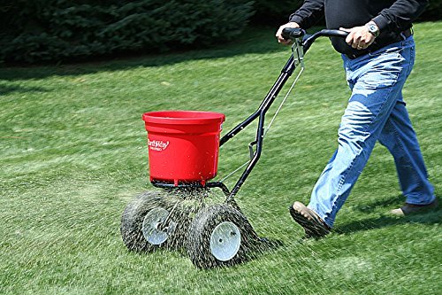

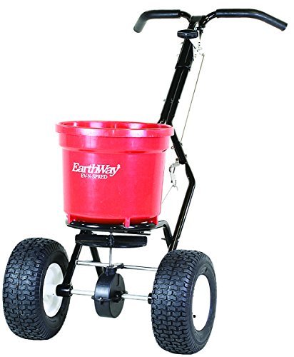

Sounds like to me that Old Red is giving good advice. I can only add that I cover 3 acres walking behind an Earthway Even Spread rotary spreader. It seemed like the cheapest, overall easiest way to spread fertilizer and weed killer/preventers. But I am retired and a pretty healthy old gizzer. It holds about 100 lbs if full and you are man enough to push it uphill.:D
Converting an old pasture to a decent lawn will probably take a couple seasons and then it gets easier to spot spray invaders. But it is costly as opposed to just mowing whatever grows.

Thanks....and you just gave some amazing advice yourself. Everyone want to use their tractors to spread fertilizer....but I spread 200 lbs of fertilizer in this spreader Sunday over an acre in 20 minutes from start to finish....that included cutting open bags pouring in etc. etc. This thing is a fantastic spreader.....and I mean fantastic....it has had 1,000s of pounds of fertilizer and pelletized lime and tall fescue grass seed run through it. Can't say enough good about this earth way spreader. The only place where I differ is that I like he 50 lb capacity hopper....however.....I could fill up the 100 lb spreader only half full and I would have the same thing I reckon.
That is not me pushing it....I am much healthier than that feller. I bought mine April 4, 2012 from Amazon.

Spraying fertilizer sounds great but does not work in confined areas like edges and corners where a sprayer can't reach. I use a Vicon, now Kubota 1000 lb dry spreader and it takes just a few minutes do a beautiful job. The Earthway model posted earlier is also an excellent idea, does a good job and is perfect cardio exercise. It just takes a while. I would not be afraid of the Earthway model and use one occasionally.
