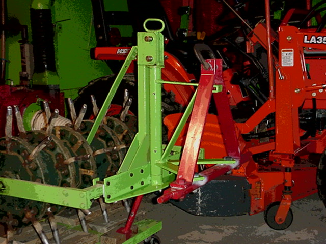

Re: First Choice aerator
Will, hi, I am excited you got your First Choice aerator. I used mine again today after mowing. It is still cool here and the grass is growing strong so I think I can still aerate maybe once more in a few weeks before the Summer heat hits. It sounds like you like yours as much as I like mine. Sometimes I think I should have gotten the 60 too but I really like my 48, I can scoot between stuff real nice with it. Either size they are real nice units. It is kinda funny how as I have added weight it begins to make the 2410 work, maybe just a little /w3tcompact/icons/smile.gif , but not enough to make her break a sweat. Ground was soft today after recent rains so I was pulling some real decent plugs!
Yeah, I think Kubota uses a metal stabilizing wash primer or treatment and then a rust resistant white/gray primer and then their orange color coat. I can see the layers in the areas on my boxblade as they have worn away. Whatever process they use resists rust and wears pretty good. I think most of the implement folks just spray on a color and as such I think the finish is real decent on my aerator compared to my KK equipment but as you say not quite up to Kubota finish quality. I would rather have the money spent on the grease zerks and bearings that First Choice specified rather than an involved paint finish. Hey, get us some pics of that bad boy please. J

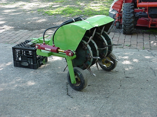

The buisness end of the critter. J
Will, that is one mean looking machine you have there /w3tcompact/icons/smile.gif . Nice looking tractor too /w3tcompact/icons/wink.gif . J
