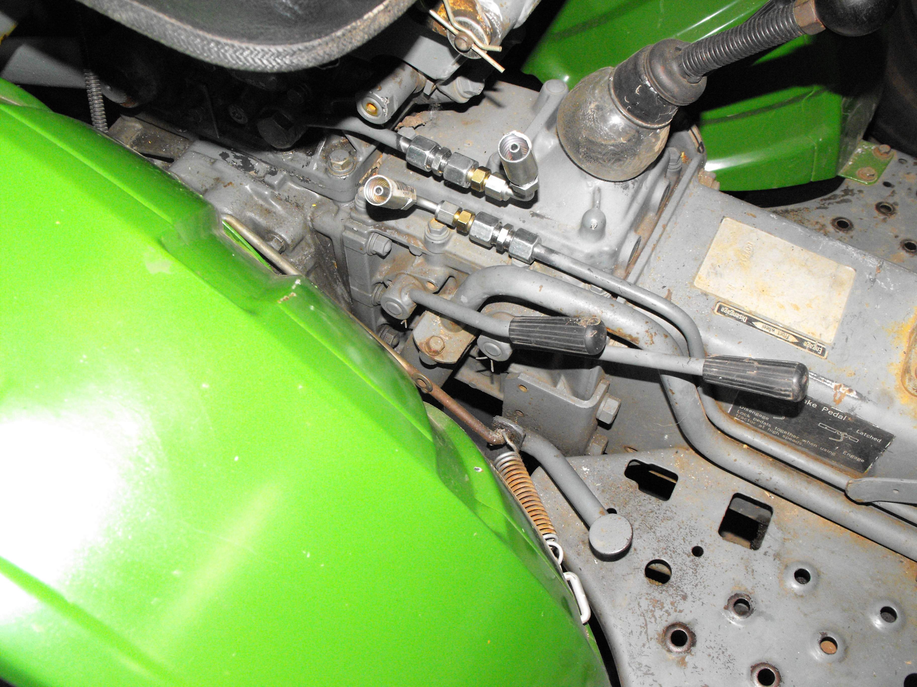

The BH has it's own valve. You only need a hyd supply. You only need to cut and install QD's in the steel lines between the pump and 3pt. When the BH is removed, you jumper the two QD's with a short adapter hose.
Two hoses and two QD's at the front or rear will provide a set of remotes. Clean install and low money.
Below is what Ampa did. He ran hoses to the front for a snow blade.
