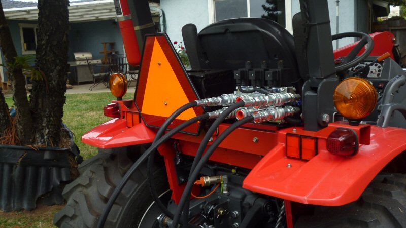

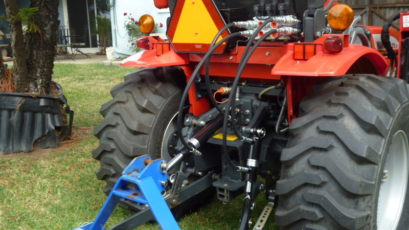

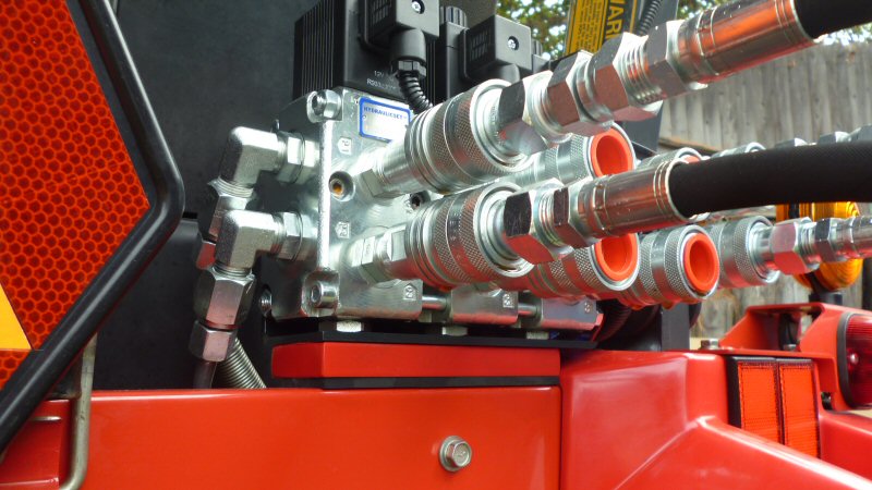

Gordon, I feel that for most people, it makes the adjustments much easier to make. Some of it is the type of valve that a person has, others just have a knack for it. I believe that it would make adjustments easier for you. I know that I could hardly believe the difference (HUGE) in using the flow restrictor vs the needle valves that I use to use on my 3215. I had the needle valves adjusted as tight as I could have them and still have the hydraulics work. They were still a little fast for me, but managable. When I changed over to just having my single OEM valve operate 3 diverter valves for my now 4 rear remotes, WOW, soooooooooooooo much better. Hard to believe that they work so good. :thumbsup: :thumbsup:
The last picture is how my 2 spool valve was on the tractor, worked fine, but I needed more remotes than the 3 that I had, so I decided to clean everything up a bit. ;)

Looks good Brian, I might do something similar on my 4520 with the third hydraulics on the rear. If I go with a new rearblade I would need to have another set or two of outlets and that is a good cheap way to get there. Currently have three on the rear but five would handle everything I can think of.

Looks good. What kind of divertor valves are those?
I have the Deere factory tnt set.
I'll take a picture of mine sometime so you guys can see it.
   / after reading about the top link failure I have a question. MntViewRanch, you here? #17
Thanks Brian. Very nice "clean-up" job.
