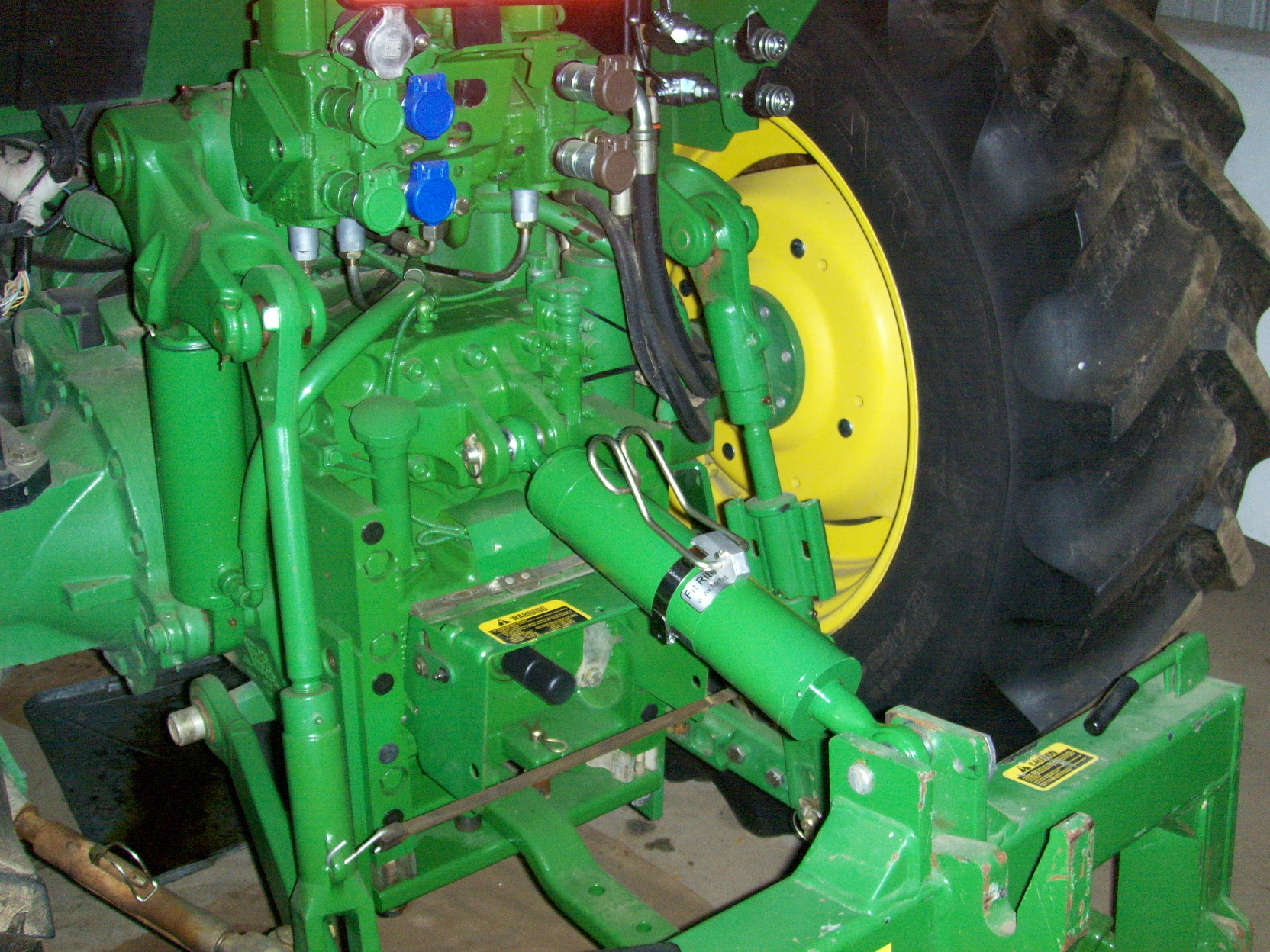

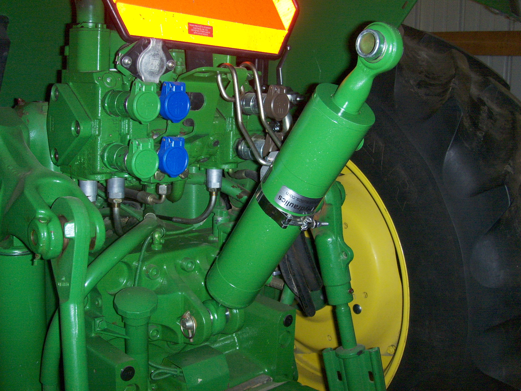

I don't want to divert the discussion too much, but wondered whether anyone with a hydraulic top link had to change the top link hanger. My top link has a hanger hook welded to it; the hook is the handle for adjusting the link length. Obviously in my case, I'd have to arrange a different way to hang the top link if (when!) I switch to a hydraulic system. How have others done this?
BOB
I use a tarp strap. I need to get another quick hitch and I will not have to worry about it.

I bought another handle from JD parts and made a bracket to clamp it on

   / after reading about the top link failure I have a question. MntViewRanch, you here? #26
Thanks, all. I really appreciate seeing how others have handled the top link hanger issue.
