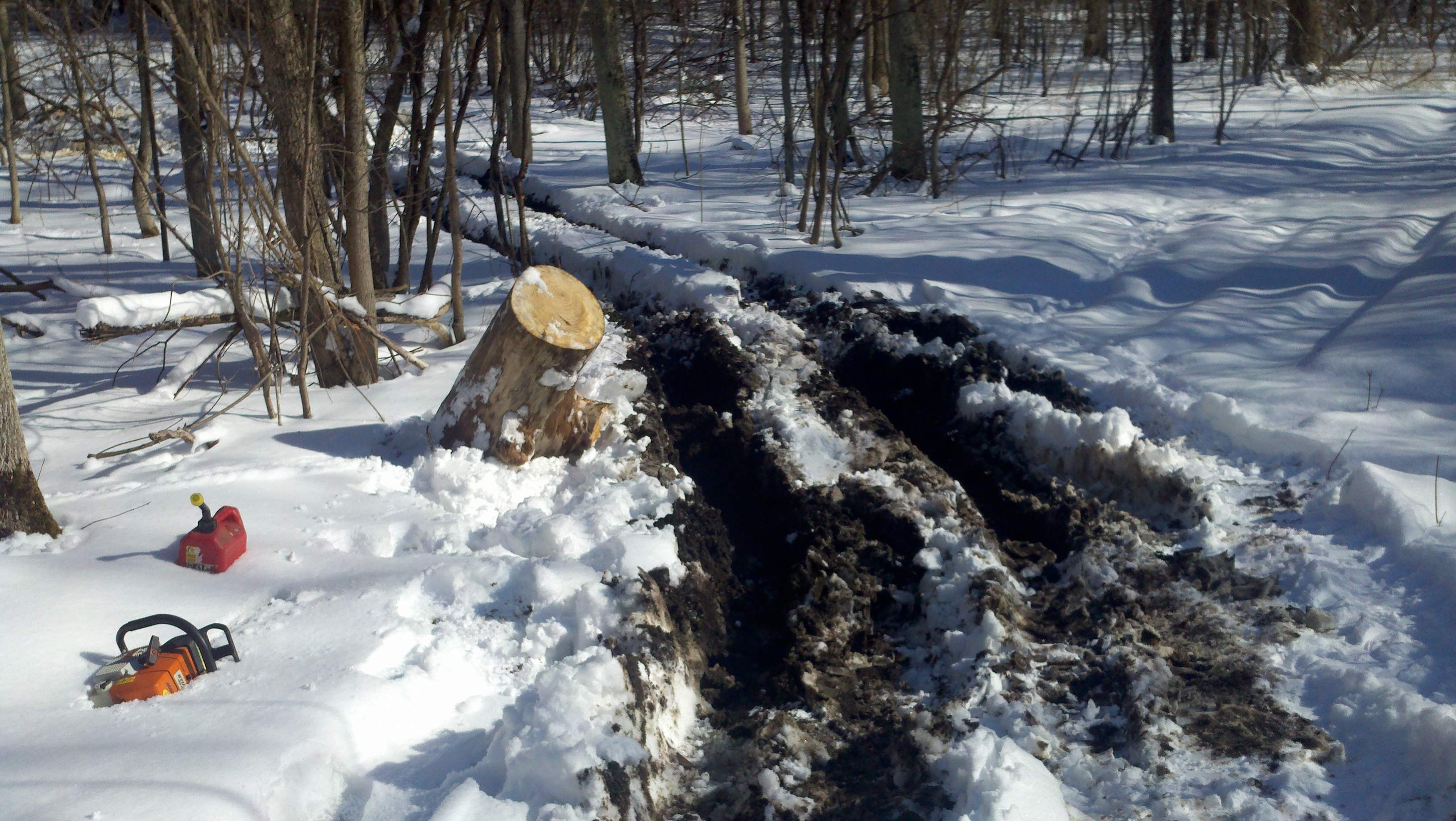

This..... what can I use to get through the combination of snow, with deep mud underneath on my little Deere 2520. The R4's like everyone says just load up. I'm not certain R1's would fair to much better as I'm almost certain you'd just end up deeper in the mud. The only thing I've found to get through this is my winch.
Anyone got a set of tracks I can install?
On another note, I'm curious as to whether the tires would be better off with some ballast in them. In the photo, I had my loader and ballast box attached. I did manage to get out without the winch after a couple of minutes though.

JMO, but loaded rears with the right chains should help tremendously.

I don't think lgp tracks are the answer either to your problem. Better planning might help, cutting your firewood in the dry season and stack it to dry ahead of time. Operating a tractor in the conditions pictured is a newbie mistake imo. If you must go there put in a road when the weather improves.
We all have to learn sometime, been there and done that.

Would love to do that during the "dry" season.... thats about 1/2 of august though... not technically the dry season, but that seems to be about the only time I can drive in the swamp like conditions. That or when its completely frozen, which did not really happen this year. Unfortunately the majority of the property I have access to is this way. Would love to have some hills, but am stuck here with this low lying "wetland" type terrain.

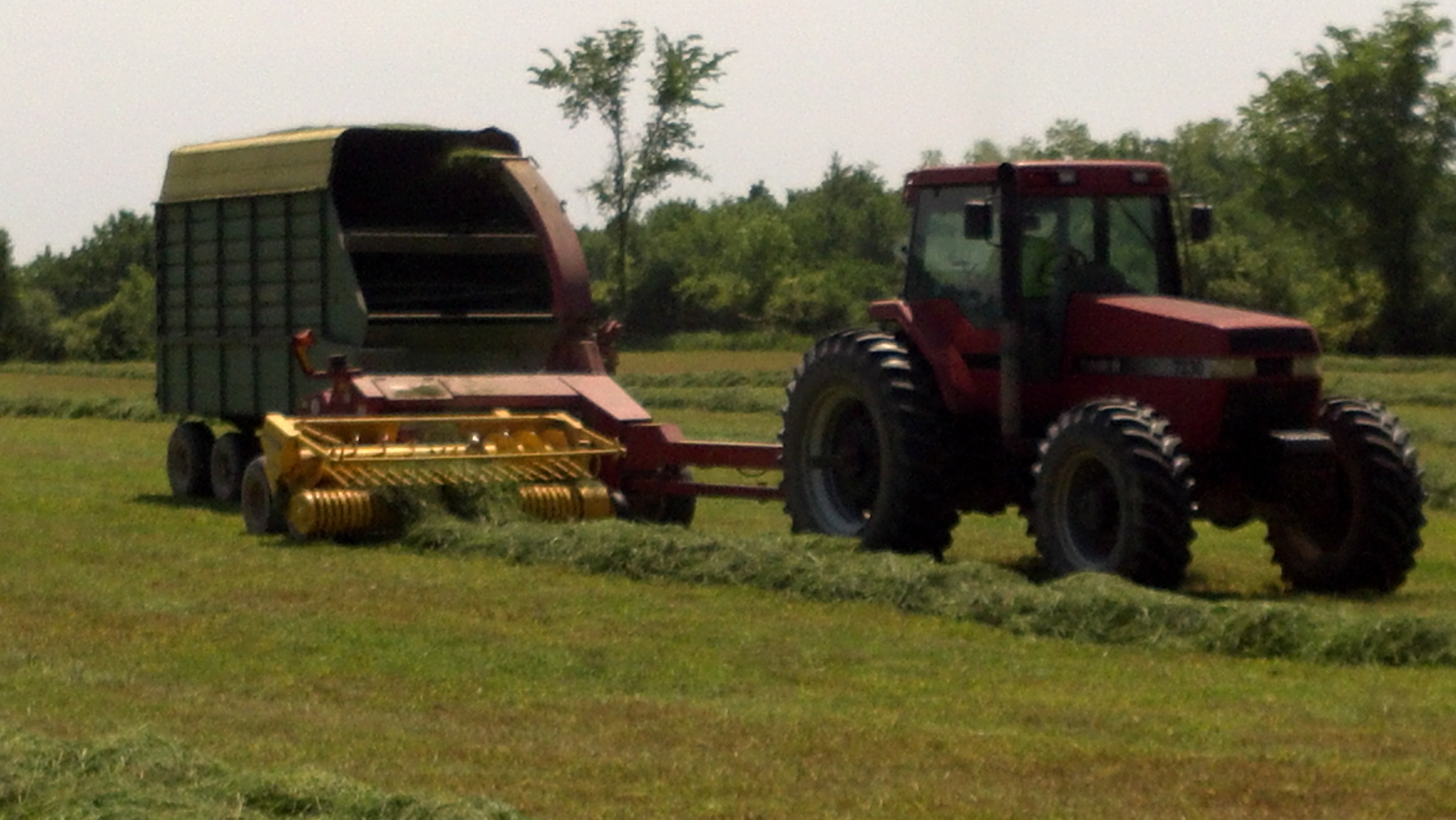

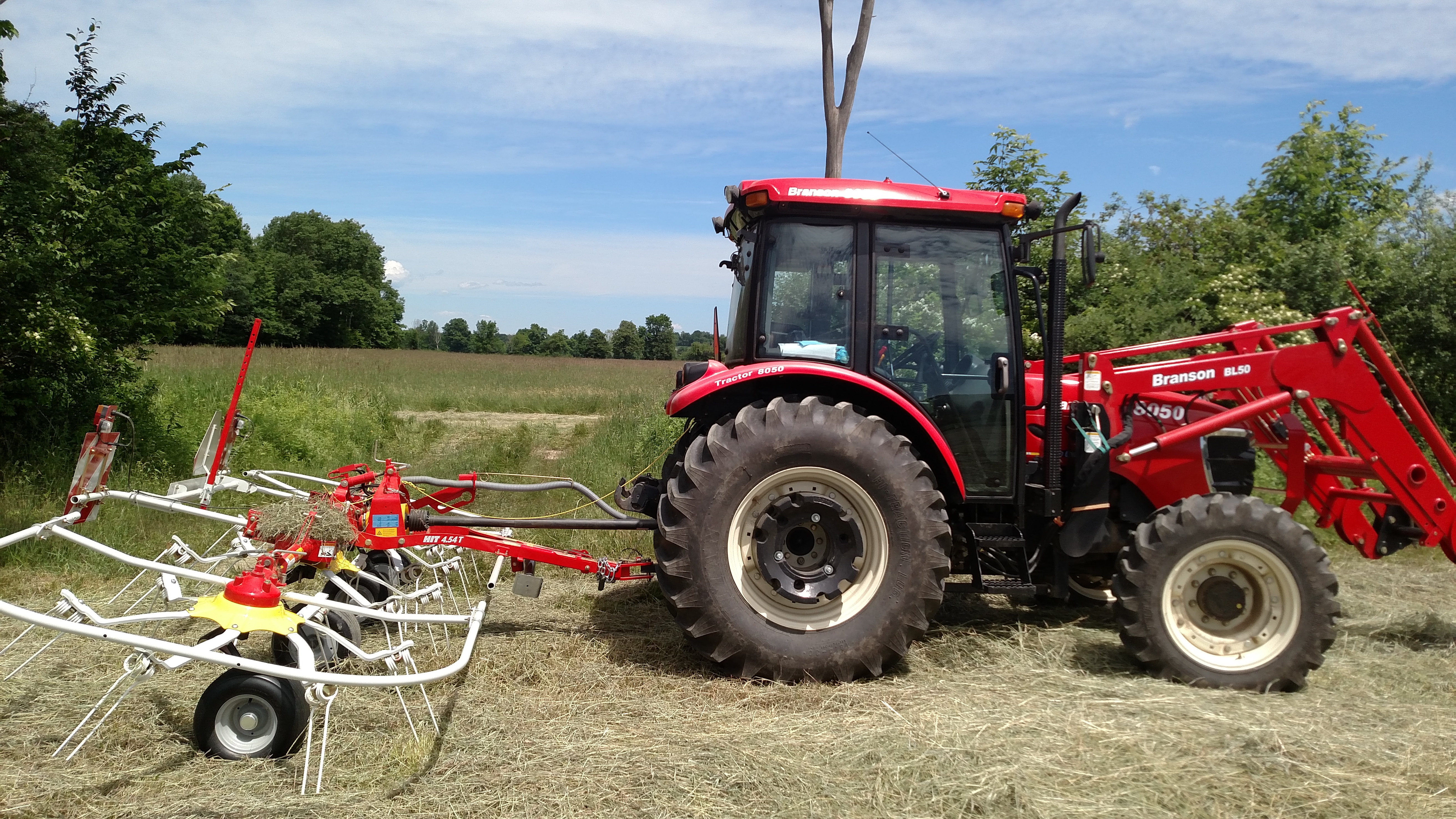

So,
Is it safe to say that R1 tires, used on a 5100 pound tractor, CAN be used to brush hog a DRY field without too much rutting?
   / Ag tires vs R4 #70
So,
I would expect it to be fine.
the first pic is about 24,000 pounds of tractor on R1's in a hay field.
This picture is 10,000 pounds of tractor in a hay field, no ruts on R1's
