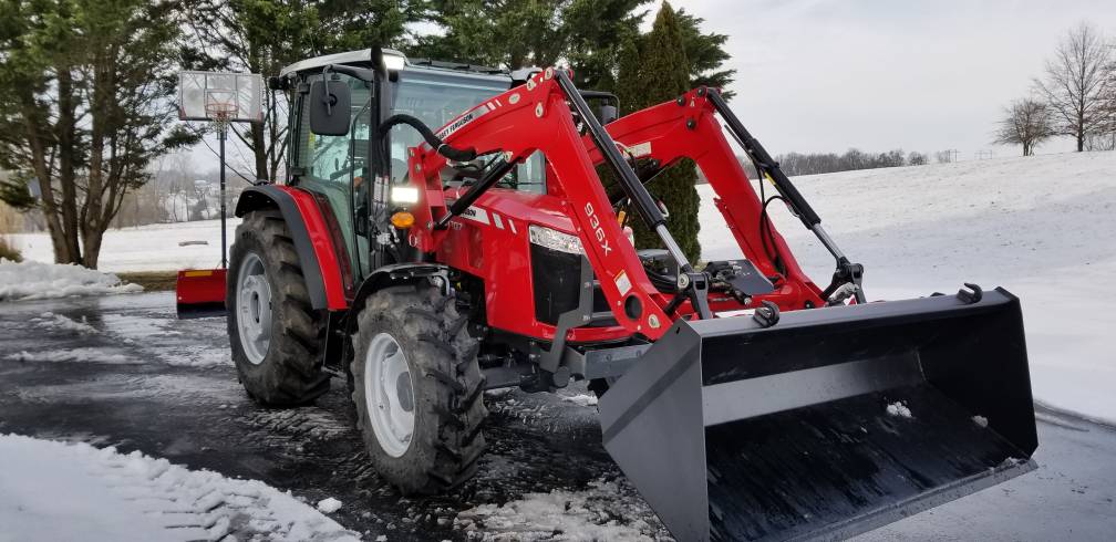

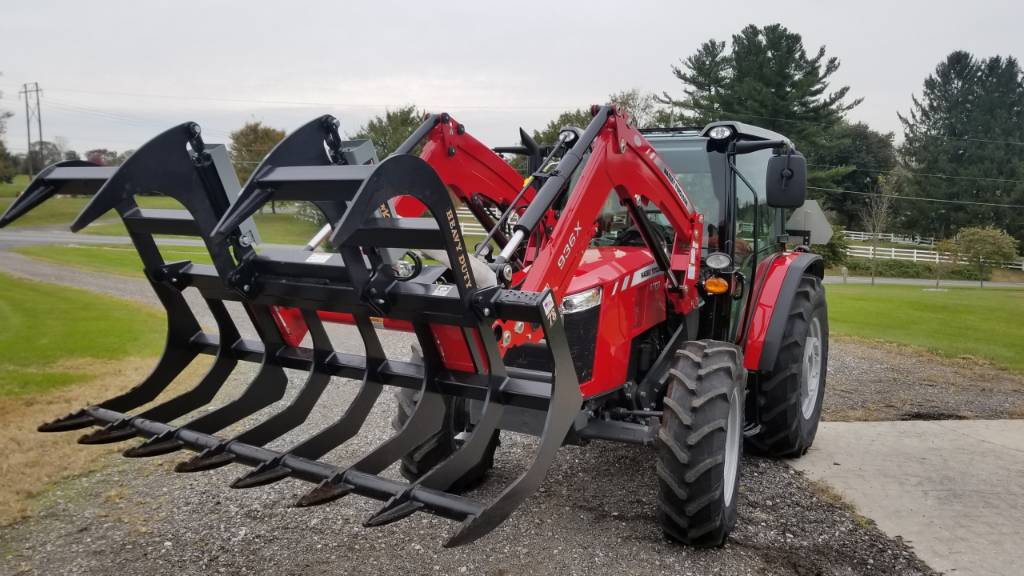

Hello arnoldziffel, google "Trellborg" tyres, they are an R1 type tread pattern designed to run at low preassure over soft ground with less rutting than standard R1s
   / Ag tires vs R4 #74
I have Trellborgs on my Massey. Great tires. Very smooth. Great flotation and traction. 20181026_114133.jpeg20190222_092933.jpeg
