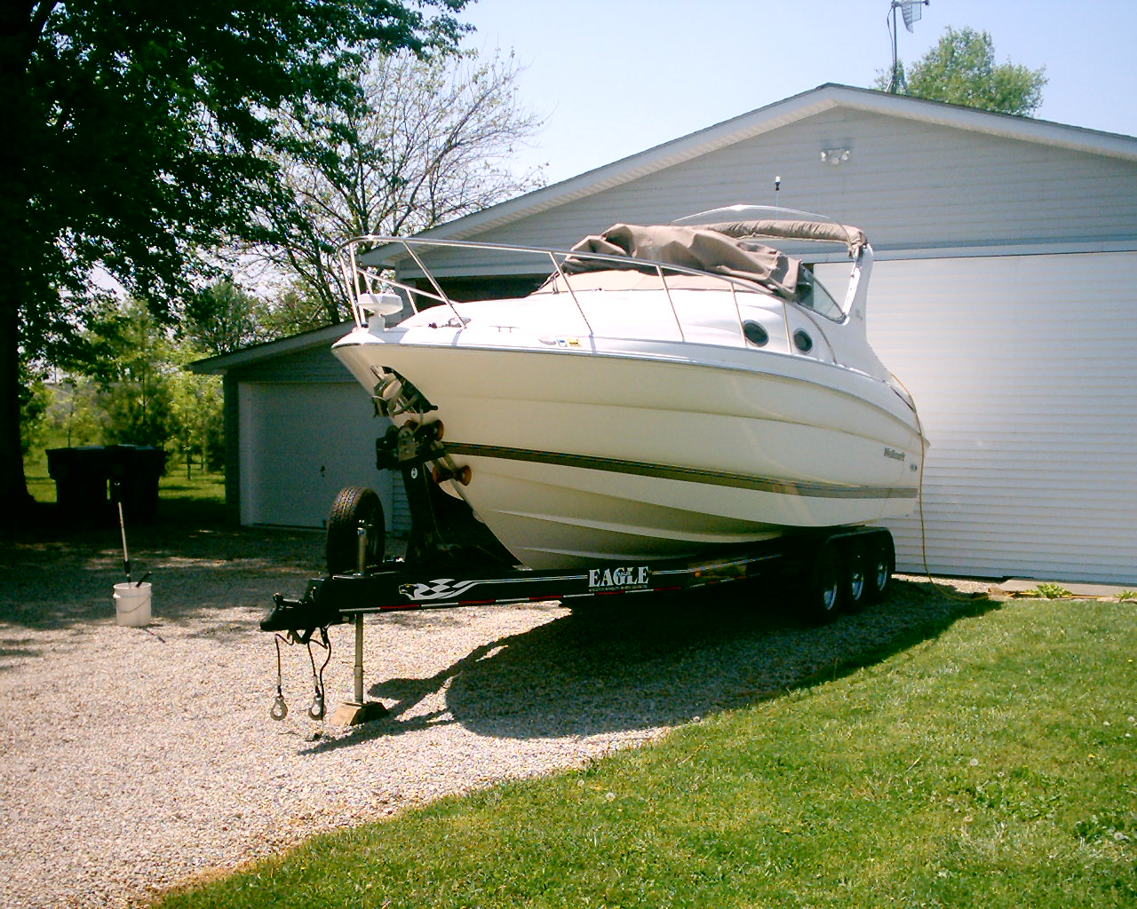

Matt, you are correct on the tow rating but look at what is more important in my eyes, the GVWR. A F-250 with 4x4 and a SuperCab has 10,000# the same truck in a F-350 with SRW is 11,500#. That is 1,500# extra payload. I can tell you this boat drops my 2004 F-250 nearly a foot while the 2006 F-350 drops barely 3". Its a scary ride at times in the F-250 with that load because the steering gets really loose and the breaking goes to heck.

Matt, what you say makes no sense???? None of my trucks have blocks to lift them like the trucks of old had. The axle and the leaf springs meet with nothing between. Even if they had 25' of blocks it would still sag the same as a truck with no blocks. Its the leaf spring pack that carries the load. The stouter that pack the more load it will carry. Shocks do nothing to add to ride height or load capacity unless you put air shocks on it like in the 80's. The difference between the rear ends in my 2004 6.0 and 2006 6.0 is the number and thickness of the leaf spring stack.
And yes, payload capacity will definitely help with squat. The boat I pictured has about 1,800# of tongue weight so that extra 1,500# capacity means a lot. Heck 1,500# is is the payload of a average 1/2 ton truck. So yes it does make a difference. A F-350 is like having the payload capacity of a 3/4 ton and a 1/2 ton combined. Take a look at the specs.
