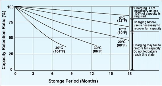

Actually, no. AGM batteries generally have a lower self discharge rate than flooded lead-acid batteries.
Someone should go tell Renogy battery co then.
They state all lead-acid batteries self-discharge @ 3%/month.
   / "AGM Car" batteries for less used tractors? #25
Try a Google search of "AGM battery self-discharge". See how many manufacturers and articles claim a lower self discharge rate for AGM vs flooded lead-acid batteries vs how many say it is the same.
The Optima battery in my tractor claims a lower rate of self discharge than typical flooded lead acid batteries. The Vmax AGM battery in my dump trailer claims a self discharge rate of 1-2%. Odyssey claims a lower self discharge rate than Flooded Lead-acid.
I did, ambient temperature has a huge effect on lead-acid self-discharge:
