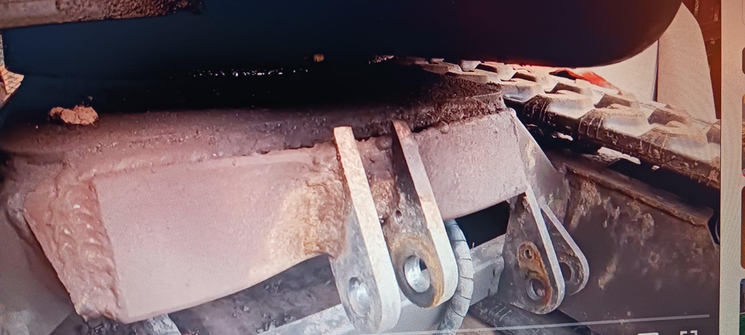

After seeing a video with the frame broken at the cyl mounting area, I have been a little concerned about that area. I did not see a good way to reinforce the frame on my baby digger.
I did not see that video, and I am always looking. Thx for posting that. I wonder how it failed, 2y ago. Looks like it pulled out from too-thin box tubing. And that bent part underneath? I don't even know what that is. Welds look good, as they do on my machine.
I am not concerned, as that is an easy fix if it fails. And I would make it thicker there. Note that some of these small minis have their blades much farther out front. When in doubt, beef it up.

Looking at the broken off push blade mounts it would appear that the operator of the machine may have been over loading it. Hydraulics can exert amazing force. The blade down helps prevent excavator tipping while digging but all that force is than put on the link between blade and machine. Even large excavator have cracked the steel of their boom frames during operation.
It does highlight why it doing a blade extension or upping system hydraulic pressure could lead to issues.

the guy that broke the blade mount did a repair that looked good enough to me. He broke it again soon after the repair.
i will try to find pic or vid.

here is the pic of the repair and it failed. is the weld on top not good enough?20231215_204128.jpg
   / Agrotk excavators: Does anyone have one? Opinions/comments/critiques? #128
I watched his repair video. I am surprised he broke it. He was using a MIG welder, and the welds clearly did not hold up.
I wonder what he is doing when these break. He says he is on a job site.
If that cross-beam is thin enough to flex, metal fatigue is almost inevitable. I will keep my eye out for any cracks.
