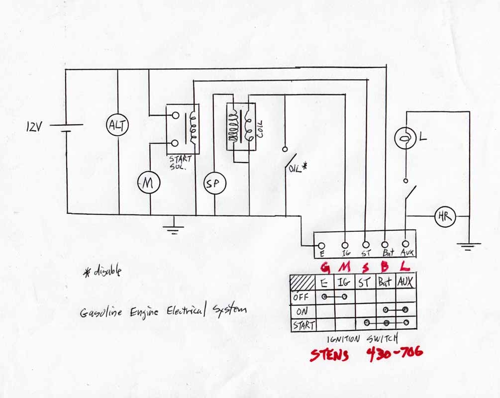

Do these have a battery? On mine I have the battery kill switch and if the switch is left on, the meter will keep running whether the motor is running or not.
When mine was in the warehouse and they were moving it around out of the container they left the battery disconnect switch on at one point and put almost 4hrs on it sitting in the warehouse.
You need to change the ignition switch so you can connect the hour meter and lights to the new switch. Then the hour meter only runs when the key is on. after that you can remove the main battery disconnect if you want, or keep it.
i did a post about it in another thread.

I have posted extensively on re-making the whole electrical system.

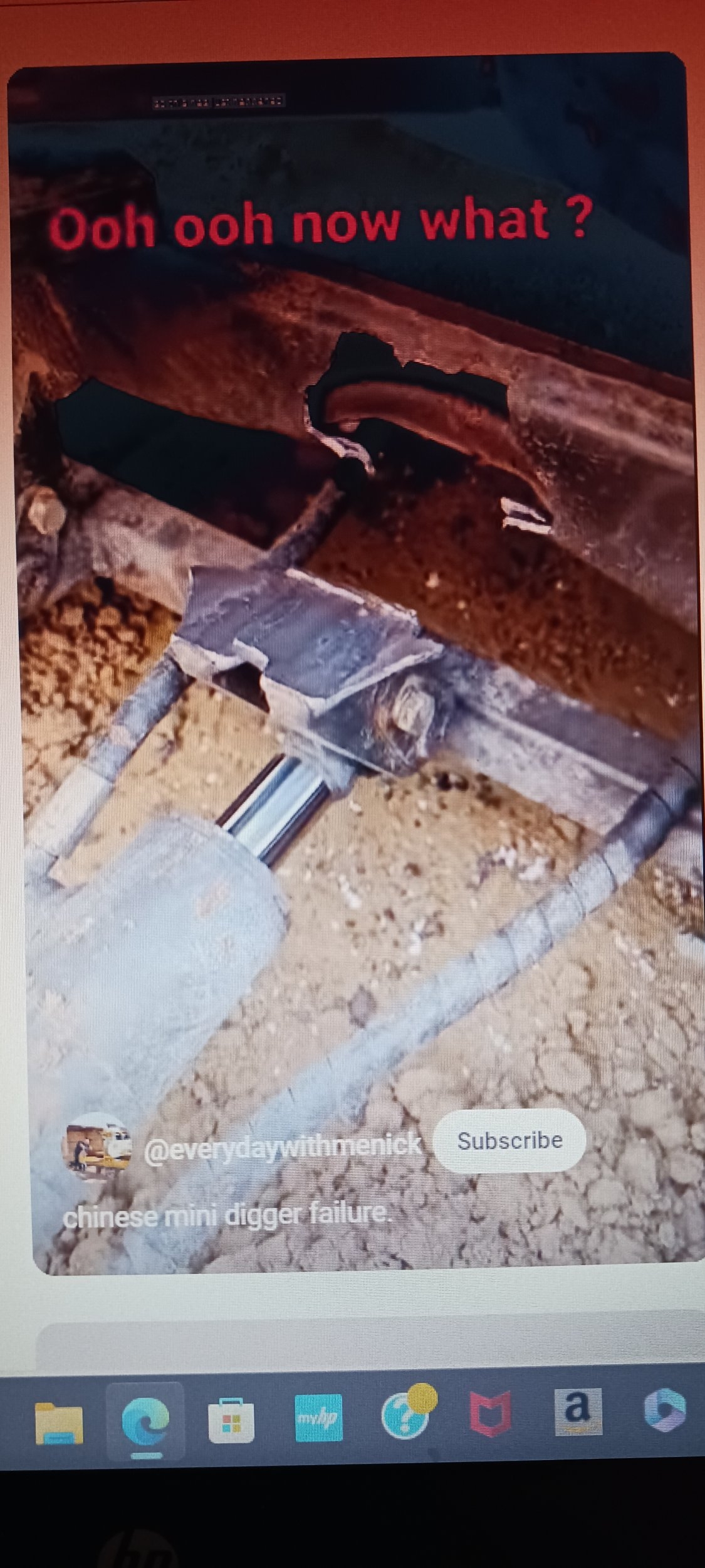

Hey Dfkrug,, I like your idea of extending the blade arms outward maybe 10 inches or so. I have a feeling that would put a lot more stress on the weld points on the frame. After seeing a video with the frame broken at the cyl mounting area, I have been a little concerned about that area. I did not see a good way to reinforce the frame on my baby digger. Am I being paranoid? its on Utube everydaywithmenick. everyone with a baby digger should see this..:cry:

It's thin steel, cut the tabs off and weld a long strip of of good steel across and the put the cylinder tabs back on.
