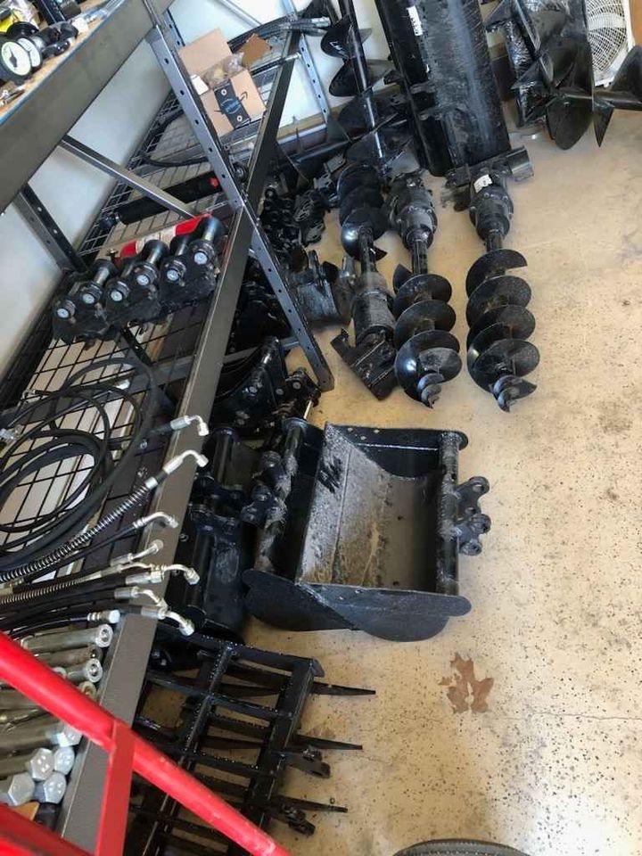

For anyone looking for attachments, this place seems to have good prices. They are on FBMP. Located in St. Albans West Virginia. I have not dealt with them and have no other info on them. 401838327_10160247272092219_57241125267attachment list.jpg401844478_st Albans WV.jpg
