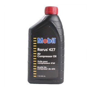

I also use Mobil Rarus Air Compressor Oil in mine.
I unfortunately, had NEVER changed mine, after about 10 years of use. The oil was black! My first thought was to simply go by HD and pick up a quart. hmm - those Sales Associates looked at me like I was from outer space. After calling their supervisor to assist, her only clue was to tell me that my compressor was no longer for sale, and that I'd need to buy a new one. Why? Because it wasn't listed in their computer!
I did find the correct oil on Amazon. Bought two quarts to be sure I had enough. Flushed the compressor a couple of times with new compressor oil, which only took a few ounces, then topped it off for the final filling. Now I have enough compressor oil to last me a couple of lifetimes. But I will assure you, it'll get changed a lot more often. Like yours, my was expensive to me, and I'd like it to last.
I'm no oil expert for sure, but the feel and appearance of air compressor oil is certainly different than regular non-detergent oil, synthetic oil, or even plain ole' Mobil 1. I sleep better knowing that I do have the right oil in it.
