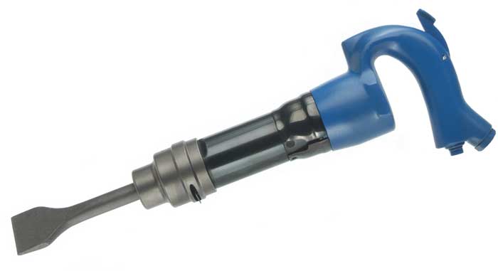

where I got the idea, (I had loaded the small Senco compressor on the truck and use the welder to run it, but I was using a chipping air hammer to drive electric fence stakes in very very hard soil,
(would take 50 hits with a 2 pound sledge hammer on a 1/2" re bar post).
so we came up with trying the chipping hammer, 3" stroke, and a ground rod driver,
and worked well but the air supply was limited, and would not build up enough between posts, (this gas powered unit is about twice the capacity of the small Senco unit),
