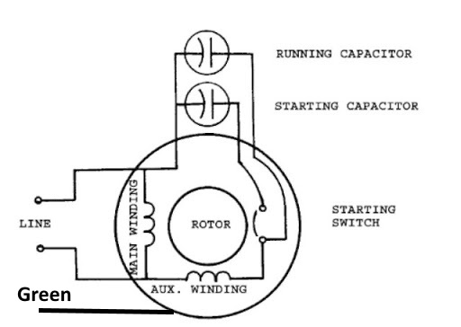

Here are some pics: First the meter as set on Ohms. I grounded the black lead to the green wire in the motor first. I then touched the output wire from the start capacitor. Nothing or no needle movement. I then touched the black wire with the red meter lead while meter was grounded. Nothing. I then touched each run capacitor wire while meter was grounded. Nothing. I then touched the two run capacitor wires and the needle went to zero. I then touched the green wire and the motor casing: the needle went to zero. All other touches needle stayed on infinity.
That means that the winding of the motor is not shorted to the ground. That is good. When you touch the capacitor wires you are measuring resistance of the winding that is parallel to it. It is typically some small value. To get more precise measurement you need to adjust zero fo your meter. Short the leads and use screwdriver to adjust the needle to zero. Then use the smallest range to measure the resistance. it should be around 10-20 ohms. Make sure both capacitors are good, the starting switch is closed and the power cable and plug are also good. If it still doesn't start it is time to take it to a repair shop. They have a tester that can detect bad winding and even might have used motor if your is bad beyond repair. And Moss Road is right if the unload valve on the compressor is bad the motor will not develop enough torque to start running and it will blow the breaker.
For AC wiring Black is "hot", White is "neutral" and Green is frame ground.
Part of your testing proved nothing is shorted to ground.
You need to test continuity through the starting switch and aux winding.

If its blowing breakers, that's an overload. Bad caps would probably just cause it to sit there and hum the motor, not trip the breaker in 3 seconds.

There's a pressure switch and there should be an unloader in that pressure switch. If its not unloading (bleeding off the air pressure in the area between the compressor and the tank), it can cause enough pressure that the motor can't spin. Bleeding off the tank of all air pressure will let you skip by a bad unloader to test that theory.

Test one/both caps while they are disconnected from everything else.
If they appear to take and hold a charge, they are probably good.

Then the motor is suspect and probably has an internal short.
Pull the motor and take it to a local motor repair shop and ask them to bench test it if it doesn't cost too much for peace of mind.
So where do I place the meter rods? One on switch and black to ground? Thanks
