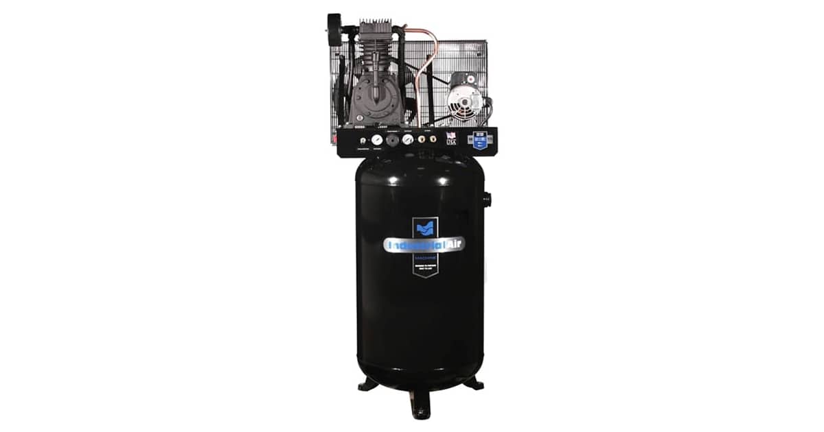

If considering a Dewalt 80 gallon 2 stage Consider the lower priced
Model:
IV5048055 Industrial air​
same as Dewalt model
DXCMV5048055​
both made by MAT holdings mostly in America, but the Industrial air is MAT holdings own branded unit it is the same as the Dewalt,
They do have a "Made in America sticker" on them as well.
I bought the Black diamond branded one when on sale for $1800 and a $400 gift card rebate at the local North 40 store. Pumps up in just over 6 minutes. Has rebuild kits for the pump parts available and by buying the oil change filter belt kit got a 4 year warranty.
Very happy with it. 17 CFM @175 PSI and came with a Century /Mexico motor and pump runs at under 1000 RPM.
about $400 less than the Dewalt but you don't get the fancy paint.
