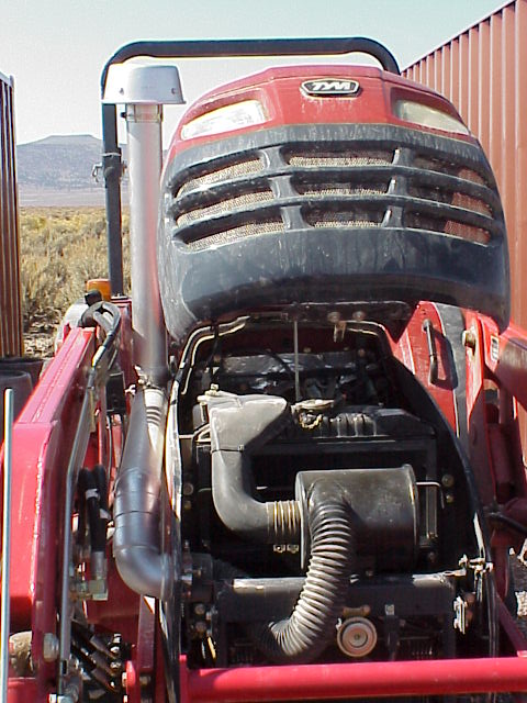

Our TYM's air intake is located low and near the front of the tractor. When conditions are dry, dusty air is easily drawn into the air intake.
We thought we could add pipe or hose onto the air intake and re-route the air intake back along the side of the engine, through the hood and up to a higher stack.
Does anybody have ideas on how we could do this? We can do simple fabrication.

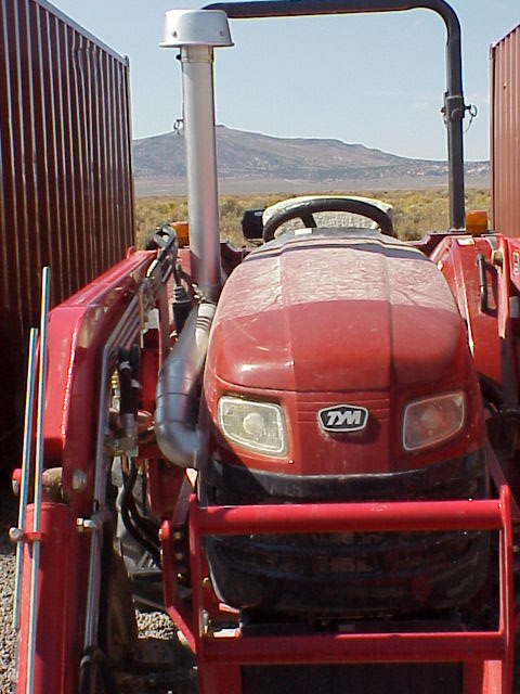

Thank you all for the very good advice! The project is completed and works great. We found a "cold air " air intake hose at the auto parts dealer for the inside and used ABS for the outside. The mounting hardware is made out of the heavy duty hose clamps we use for our irrigation pipe. Now, it would be nice to put a pre-cleaner on the top of the stack!

Nice looking mod. It would appear at least six feet of extra distance was added for air to travel through. Will this affect how the engine will breathe or cool? I do not know or even have a clue, that is why I am asking.

Yes, we wondered about that (running hotter and decreasing performance) as well. It appears that the new intake actually improved performance slightly: just a little better RPM with full acceleration and the gauge on the temperature meter sits at the same place as it did before modification.

With that short a distance air restriction shouldnt be a problem. You will probably gain a small amount of HP by getting cooler air into the engine than the previously hot air from around the radiator. You should be able to find a pre-cleaner bowl to fit that setup at TSC or even a tractor dealer. Hopefully the size will be the same. If not just get a larger size and fit a PVC reducer between it and the intake pipe you built.
