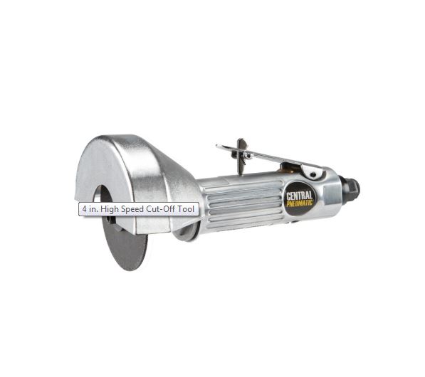

I have a project in which I need a 'die grinder' type device for power, but I don't want the RPM of a typical die grinder.
I am looking for something to power a cutter which I am designing, but need the RPM to be drastically lower. Tho RPM on the tools I have seen are in the range of 13-20K and I am looking for something in the 500-1000 or even less range. (At least at this time.) However, I still need to keep the torque of the machine to run the cutter. I am afraid, although I don't know for sure, that the high RPM will cause too much heat in the foam I am cutting. (memory foam type material)
I am not familiar with airtool workings. I have and use several, but that is it... I use them. The most I do to them is oil them.
I suspect there is a way to decrease the RPM via orifice reduction etc. But I also suspect that would drastically decrease the effective torque. Otherwise, I suspect I would need to change the internal 'gearing' in some manner, which I am willing to do, if it is reasonably accomplished by a 'novice'. I am pretty handy, and not afraid to take on a task, and I am willing to 'sacrifice' a few HF tools in order to give it a try. But, I don't know where I'd begin.
If you know of a die grinder/cut off tool with either a variable speed or MUCH lower RPM, that might work for me without necessitating all the hassle. I also don't know whether simply turning down the air pressure would decrease speed without torque, although I would think both would be affected.
Straight cutters, saws, hot wires, etc will not work.
I need to be able to slow down a cutoff wheel machine or something along those lines. Something similar to or along the lines of the pic below.

You can't slow down a conventional pneumatic die grinder anywhere near that much, and have it be of any use to you. They only produce power at high RPM's
An industrial right angle pneumatic die grinder can be built to run slower, because they have gearing. They are still rated at around 9,000 rpm. It would probably run at about 7,000 rpm, with a load on it. Perhaps you could throttle it back as far as 5,000 rpm, and still have power. They are also expensive, $250-$400.
   / Airtool... how can I decrease RPM without decreasing torque? #14
Get an air powered nut runner, or screw driver. They all have planetary gear reduction in an inline chassis.
Ingersol is one brand, Rockwell,...etc... there are many more.
   / Airtool... how can I decrease RPM without decreasing torque? #15
Or, perhaps an air ratchet.
Air motors need gearing to produce torque at the output shaft.
The basic air motor is a high speed, low torque device.
