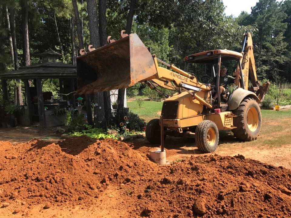

Hope this picture helps. This is from my gazebo build. The channel iron is in the middle of the hole with concrete all around it except for where it comes out of the ground. The it's only at the edge of the sono tube. The concrete in the sono tube is only on about half of the hole, so a good part of the weight from the post and above is carried all the way down into the hole, but also some of it is resting on soil.
I'll cut two holes in the channel iron with my torch. Then when the log is set in place, I will drill a 3/4 inch hole through the log, insert 3/4 inch galvanized threaded rod, add a galvanized washer and nut to each side and tighten. Then cut off remaining threaded rod.
The log will still move, so I'll keep it braced until I have the roof all tied to it. That will lock it all in place so there is no racking.

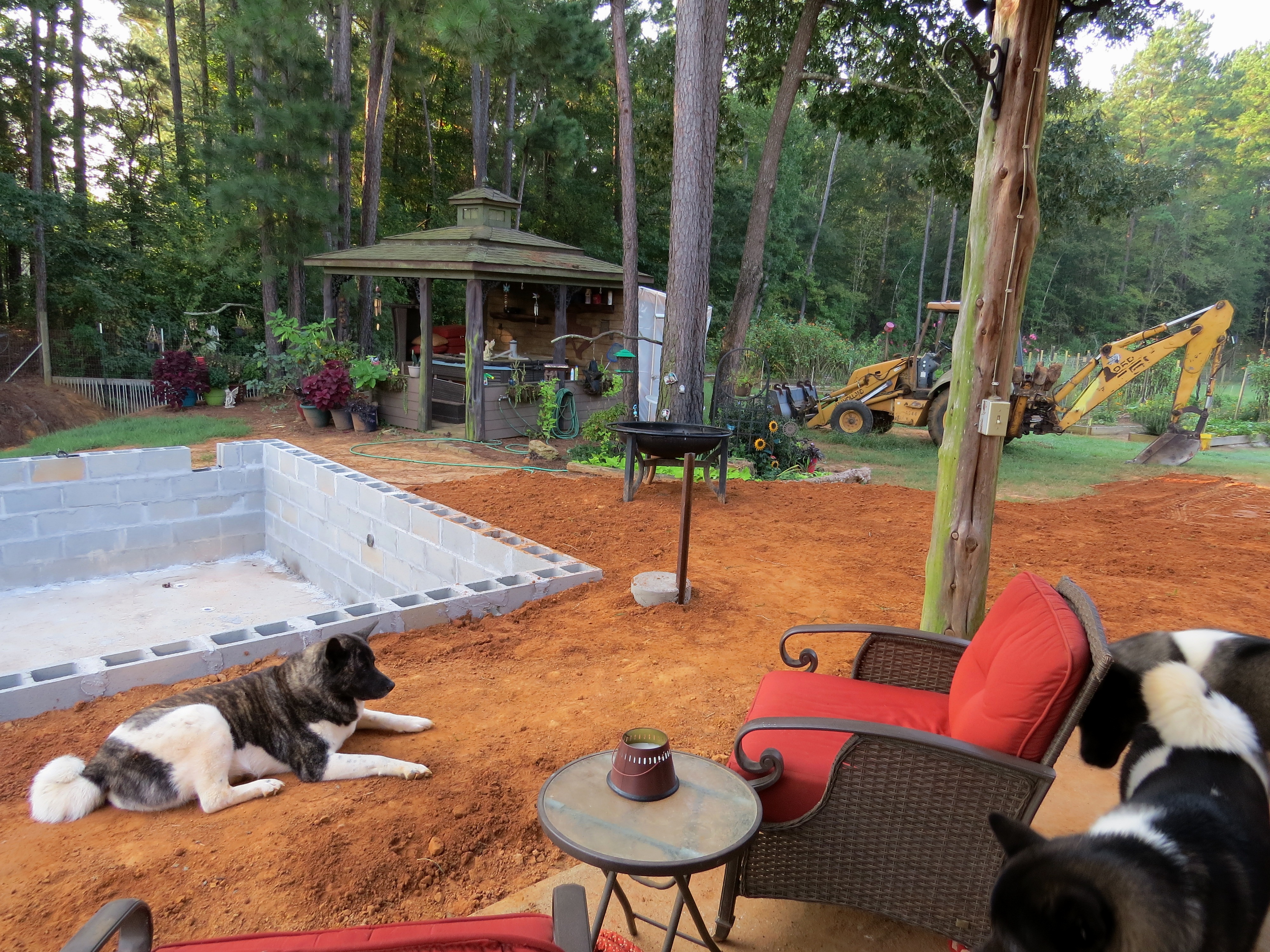

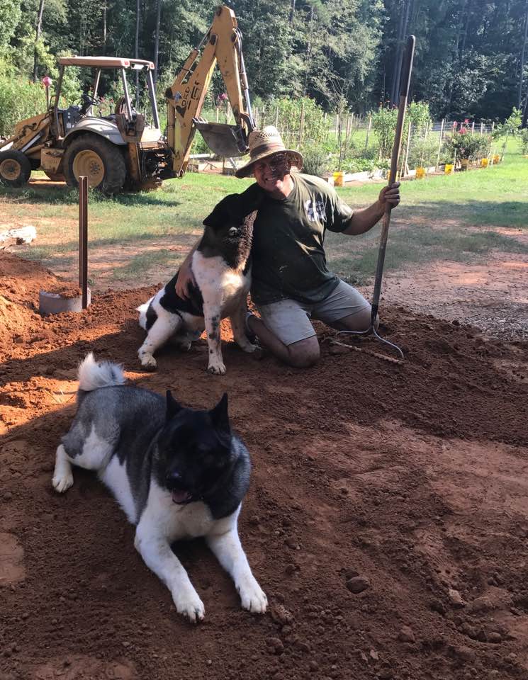

Didn't get as much done as I had hoped, but a little progress is still progress. The porch is being extended quite a bit and to do this, I need to build up the dirt. I brought in 7 yards so far and probably need another 3 for the pad and one more yard for the fill behind the blocks on the far side, that is hard to get to until I remove the cement mixer. I'm a little amazed at the change. I pictured it in my head, but it's never the same as when you actually create it.

Thats going to look awesome when done! Those will be some happy dogs!
