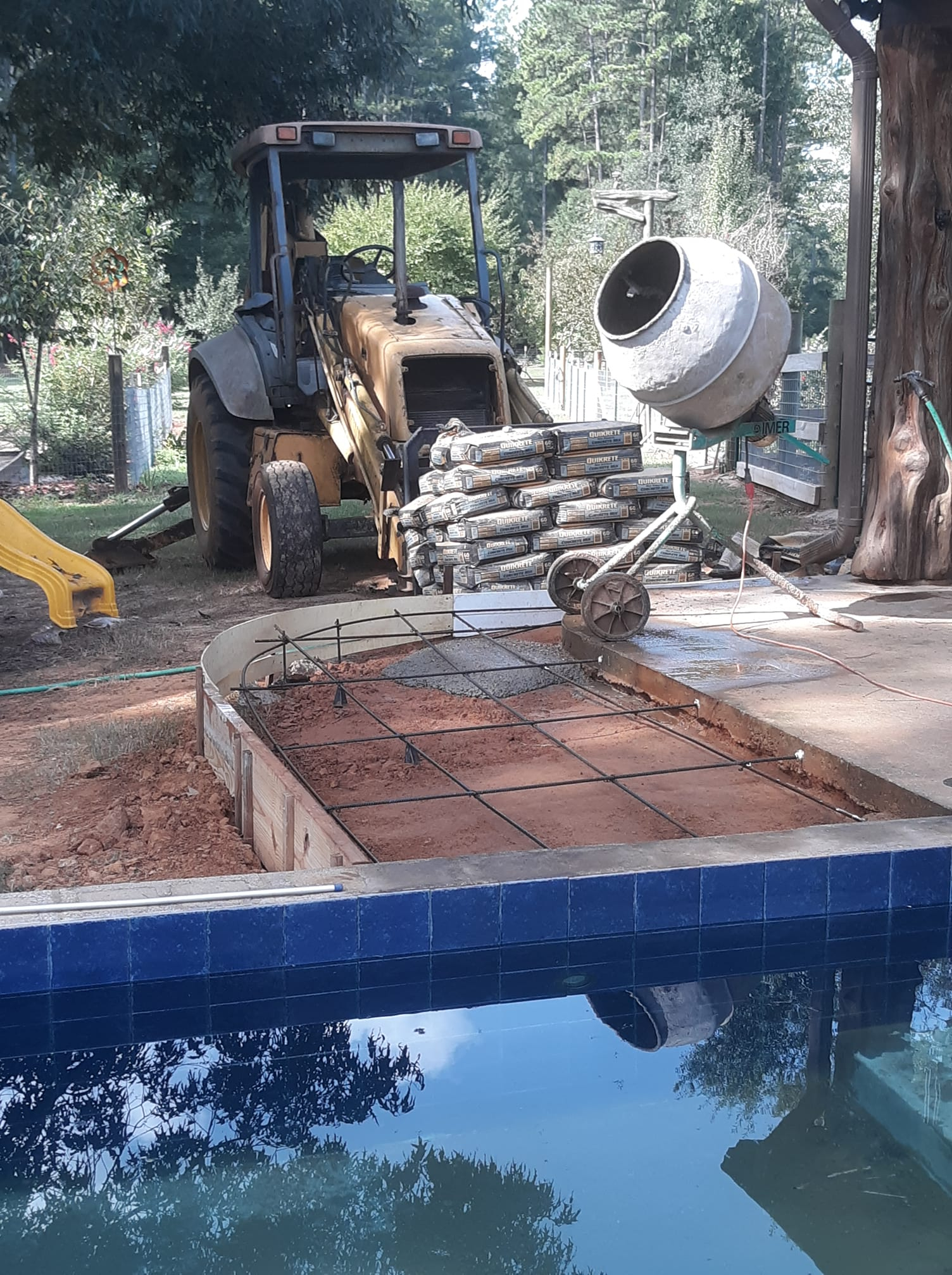

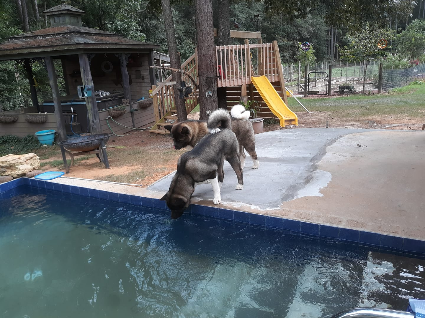

I had some concrete left over from my shed project and wanted to get it out of the way. We realized that when we poured the concrete for the porch that it should have gone out a little farther, so this seemed like a good time to get rid of all those sacks of concrete. Since there is a round section of the concrete, I cut out 4 inches where the form started so it would be thick enough to have some strength. I drilled into the original slab and the cinder blocks of the pool for the rebar, and used glued them in with liquid nails. Depth of the slab starts at 3 1/2 inches and drops down to 9 inches deep. Instead of trying to build up the dirt and compact it, I just mixed more concrete. I had 66 sacks and I used every one of them. I didn't have enough concrete left over to fill a coffee can!!!! I can't remember when I was so close on materials and actually had enough to finish it.
The weather changed today. It's less humid out and morning temps are in the 70's with a forecast to get down into the 60's later this week. My days of swimming are coming to an end and I'm expecting to drain it in a couple of weeks. Pretty soon we will be enjoying a fire on the porch!!!

Isn't it fun putting all those sacks of concrete into that mixer!

Picking them up is the worse part about concrete work. The 80 pound sacks where horrible. The 60 pound sacks are doable, but I'm probably going to need to find something smaller pretty soon. Or just quit mixing concrete!!!

I used to do 80s. Now 60s. Next time might be 40s. I think Home Depot has 40 pound sacks. My mixer opening is above belt height.
