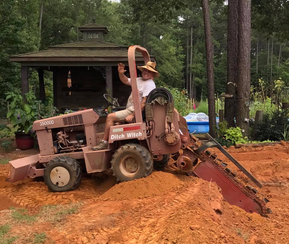

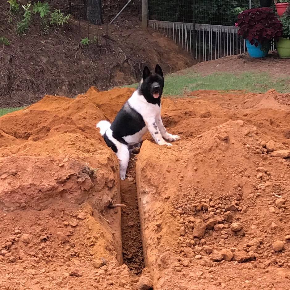

Today was trenching day. I needed to get a line in for the drain, then the water and power lines. The drain is just a simple 2 inch floor drain with 30 feet of 2 inch DVW pipe to my ditch. When I'm ready to fill up the pool, I will add a 2 inch gate valve to the end of the pipe. I have about foot of drop from the bottom of the pool to the trench. Since I'm going with salt water, there is no worries about dumping the water into the ditch, that will eventually go into my big pond.
At four months old, Matsu is the most curious of our dogs. He has to sniff everything that I dig up, and even crawl into it if he can fit

Eddie, that pic of you on the ditch witch shows what looks like sandy red soil... I guess it is more clayish?
Will you put down some sand underneath it?
/ Akita Pool
#40
Yes, it's all red clay. It's very stable, holds water for ponds and once you break through the crust, there is always moisture just a foot or so down. There is very little movement in it, so I'm not planning on adding any sand.
