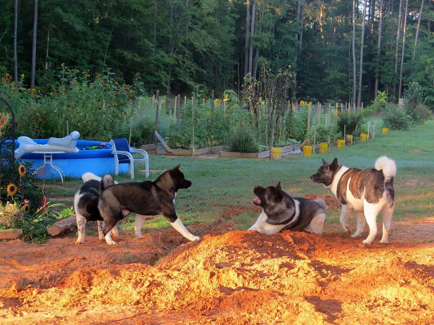

im surprised she lets them play in the dirt. Seems like repeated play in that red mud would stain their white paw tips and it be hard to get out for shows.
One of the problems with Akita's is they blow their coat. Summer time is a bad time to show them since they are losing so much hair. My wife bathes them about every other week, and brushes them out a couple times a week. Dog hair is something we just deal with. They have a very large doggy door, and the amount of dirt they bring into the house is amazing. She sweeps several times a day, and I've gone from changing the air filter in our AC unit from once a month, to once a week, and now twice a week.
Once it cools off and they start showing again, they will get their bathes here, but then again at the show either the day before, or that morning. I think a big part of why there are so many women at the dog shows is that they all love washing their dogs!!!! It's non stop.

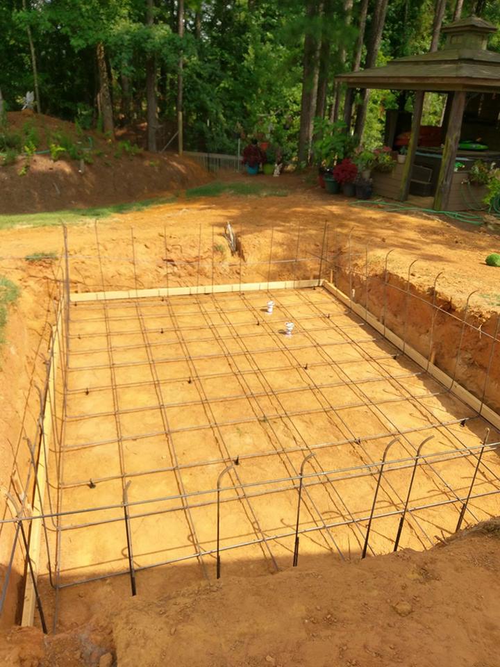

20 foot long 3/8's or #3 rebar is bent, tied and resting on chairs. I put a temporary piece of rebar all around the pool to keep the upright parts in position. Then my wife wanted something to stop the dogs from diving on to of the rebar to impale themselves. I guess Akita's do that kind thing?
Do yourself a favor and ground that steel... never can be too careful. Are you forming and pouring, or shooting the concrete?
/ Akita Pool #77
Most times i see shot concrete sprayed the rebar is several layers and really close together. I assume your pouring. If your pouring i am curious if you are putting a liner in afterwords ? Concrete cracks and cold joints etc etc and the leaks from them. Or is it a just does not matter deal ? I am just curious and watching and learning. Looks like you have a interesting project on your hands
/ Akita Pool
#78
I read about bonding a pool online and think I'm OK with the rebar being pounded into the ground. The pool is 16 feet long, and my 20 foot lengths are not long enough to go from end to end with the bend, so on the side closest to the porch, where the stairs are going to be, I pounded into the ground 8 lengths of rebar that tie into the short bend on the long lengths.
My plan is to pour 2.4 yards into the forms and create a pad. The rebar is 16 inches apart. Then after the pour, I will build up the walls and stairs using cinder blocks. The blocks will then be filled with concrete. After that, I will let it cure for about a month or so while I focus on the porch. Then I will paint Redgard onto the inside walls, steps and floor. Redguard is a kind of paint that is used in bathrooms showers that makes everything water proof. It's also listed as being used for swimming pools on their website.
When I lived in Indonesia, cinder block was used all the time for pools and fountains. Searching online, I found quite a few links on doing this too.
After the Redgard, I will be using a special thinset mortar designed for swimming pools that adds another layer of waterproofing. Same thing with the tile, it is denser then regular ceramic tile.
