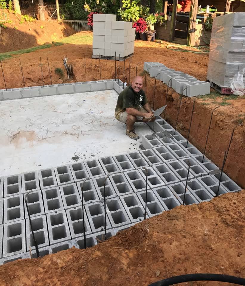

I'm not very fast at laying block, and I tend to use a lot more mortar then I should, but eventually, I get there. After Lowes dropped off the block, I spent the next 7 hours laying the first row of 104 blocks. I'm working real hard to get all the interior walls straight and smooth so they tile really nice. One of the concerns was making sure all the dogs can get in and out easily and safely. We figured a set of stairs the full width of the pool was the only solution. Digging the strips and setting concrete forms was beyond my skill set, so I'm building them up with a lot of blocks. 16 across per step. In this picture, I have my string stretched across to get that bottom step perfect. The three rows before that are just fillers and I didn't try real hard installing them.
This is going to take a ridiculous amount of concrete poured into each bock, but it's something I can do one sack at a time after work with no rush to finish.

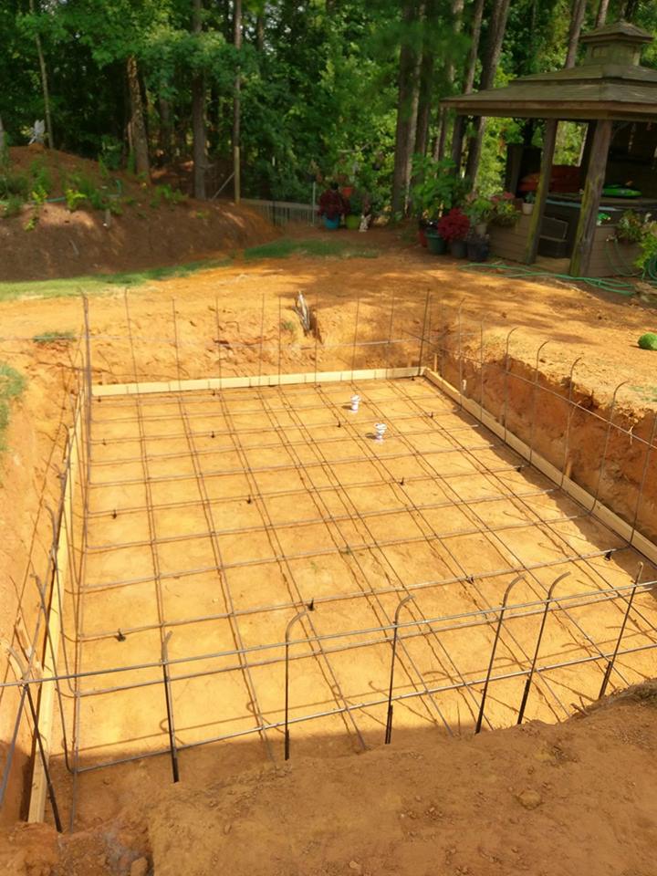

I have it in my head that I need to tie all the blocks together with rebar. I went back and fort about having it come up through the pour before pouring the pad for the steps, and finally made the decision to drill into the concrete and epoxy them in place. I now they are not going anywhere, but I still want them held in place with rebar pins.

Okay Eddie, this photo totally lost me. Why cinder block on the bottom, sitting on Concrete?
hugs, Brandi
Stairs. The row I'm working on in the picture is the last step. The next layer of blocks will not go on top of the row I'm working on in the picture, but will end at the next block in.
For this to be safe for dogs, I wanted the stairs to be the full width of the pool. My two options where concrete forms, or blocks stacked on top of each other. The concrete forms seemed too complicated for what I wanted. They might have been better, but in the end, nobody will know the difference either way. Just my back will remember this for a very long time!!! :)

/ Akita Pool #116
Oh, it looked like you were going all the way across with blocks. I take it the steps will be one cinder block in length?
hugs, Brandi
/ Akita Pool
#117
Yes. If you look real close, you can see my string line going across so I can have the edge of the steps perfect. The other three rows are just filler blocks, but for every step, I'll use the string to get the step strait.

20 foot long 3/8's or #3 rebar is bent, tied and resting on chairs. I put a temporary piece of rebar all around the pool to keep the upright parts in position. Then my wife wanted something to stop the dogs from diving on to of the rebar to impale themselves. I guess Akita's do that kind thing?
our Ex neighbors had a Weimeriner that did it self in that way!!!!:eek:
Oh wow.............that string line is barely visible. Next time try pink string.:thumbsup: Forget the girly color.:eek: You can see it a long way off.;)
