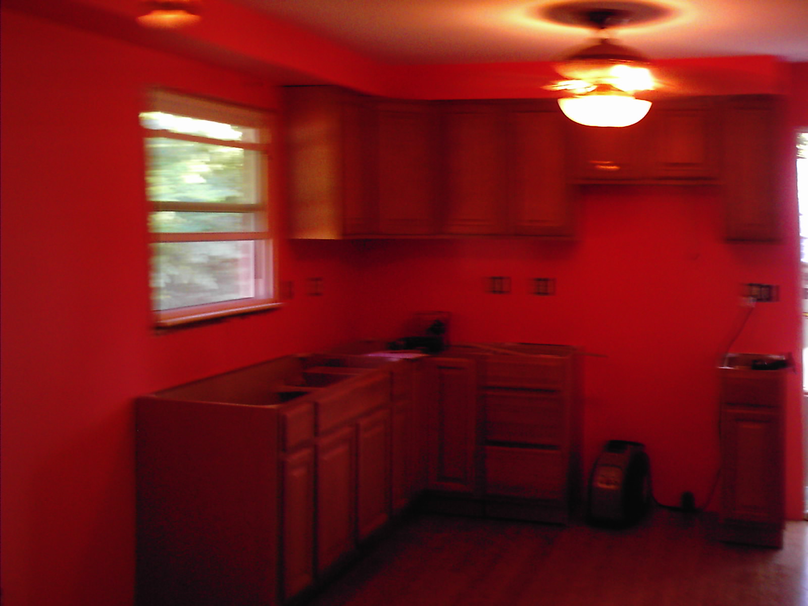

So today's projects,
Base cabinets, Floor air ducts under cabinets, ducts out of sink base, hang another wall cabinet, scratch head a lot and try and figure out what cabinets we should have done. :eek:
Dean had one of his freinds agree to paint a mural on his wall.... So Andrea and Dean have repainted one of his wall's RED (what is it with this house and RED walls :mad: ) Oh, yeah, this would be AFTER and on top of the freshly refinished hardwood floors :(
Oh well, there could be worse things out there. :D
7 is Drea
8 is Dean
9 is the Kitchen cabinets.
I do not understand why my "high dollar" :p camera stuggles so much with the red walls.

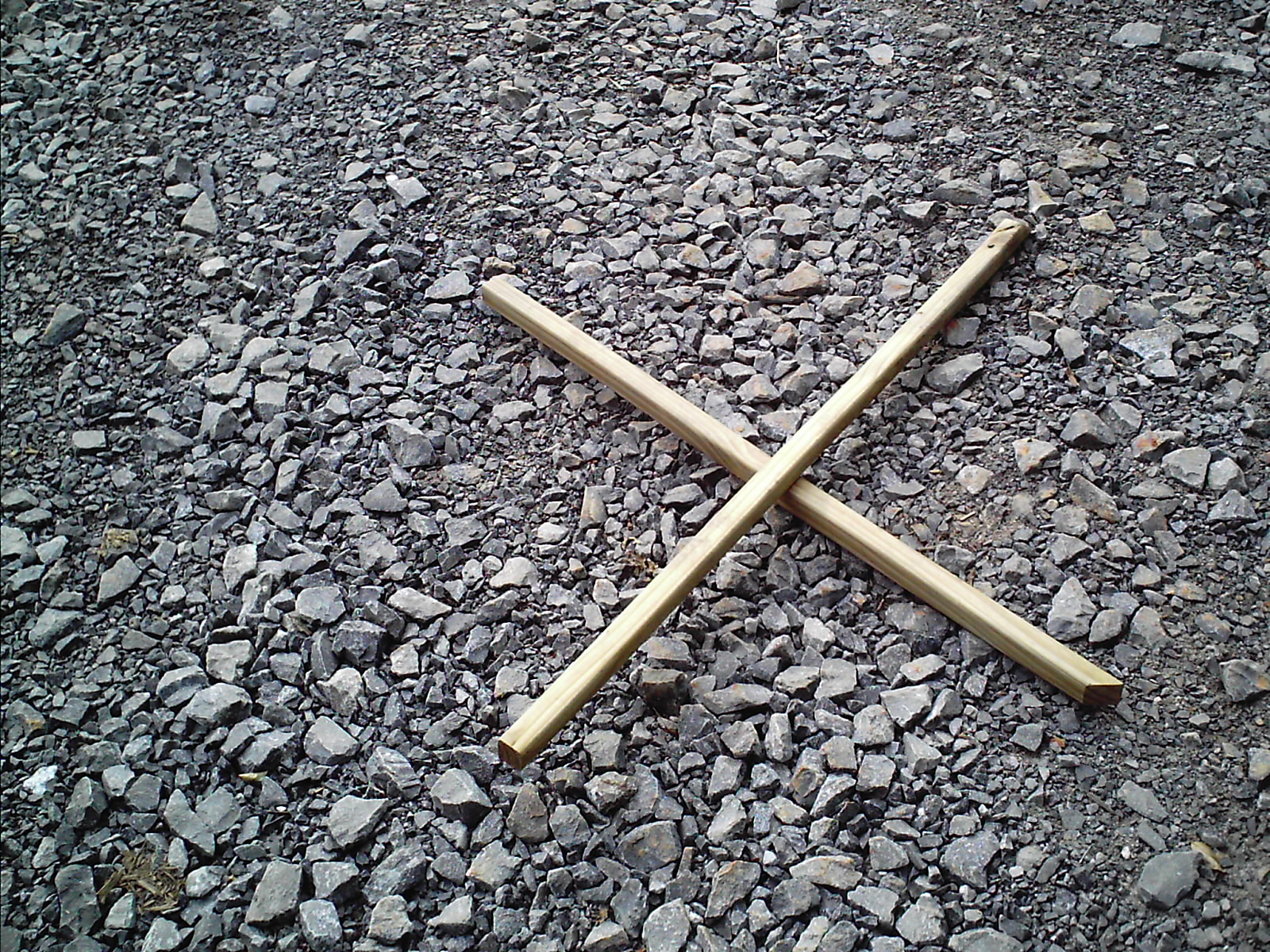

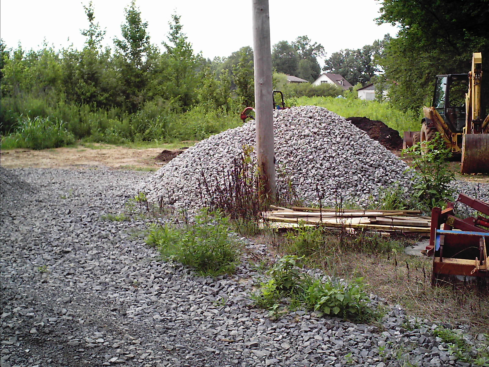

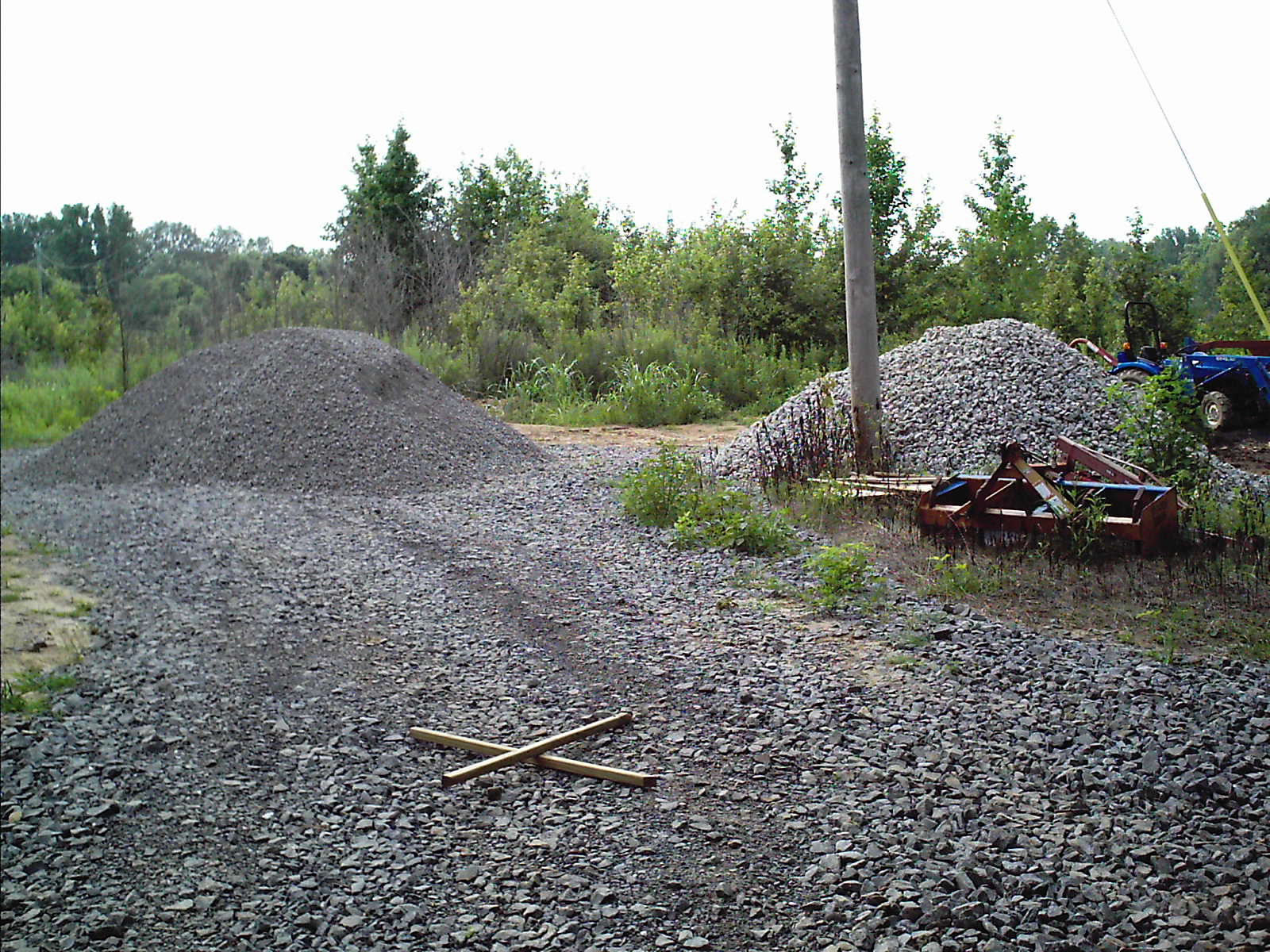

So yesterday's entertainment :rolleyes: came with the gravel truck driver.....
Hanna could not stay there and wait on him, so the instructions were "drop on the wooden X in the driveway, kind of near the loading dock............
Well, the loading dock is uhhhhh,,,, UNDER where you see the big pile of gravel... :confused:
Why was it again I like to do stuff myself??? :mad:

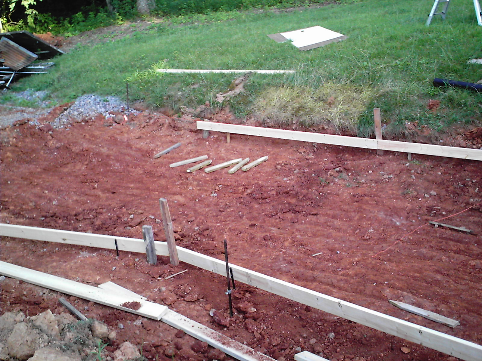

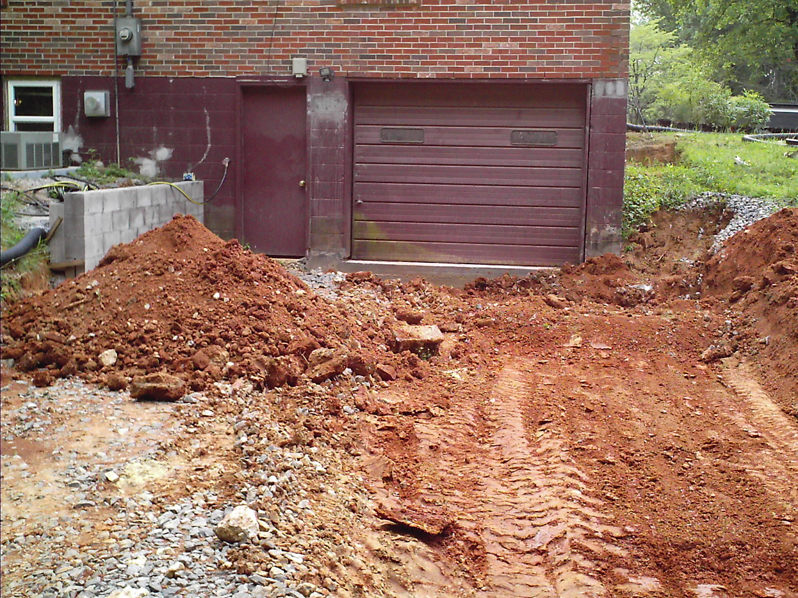

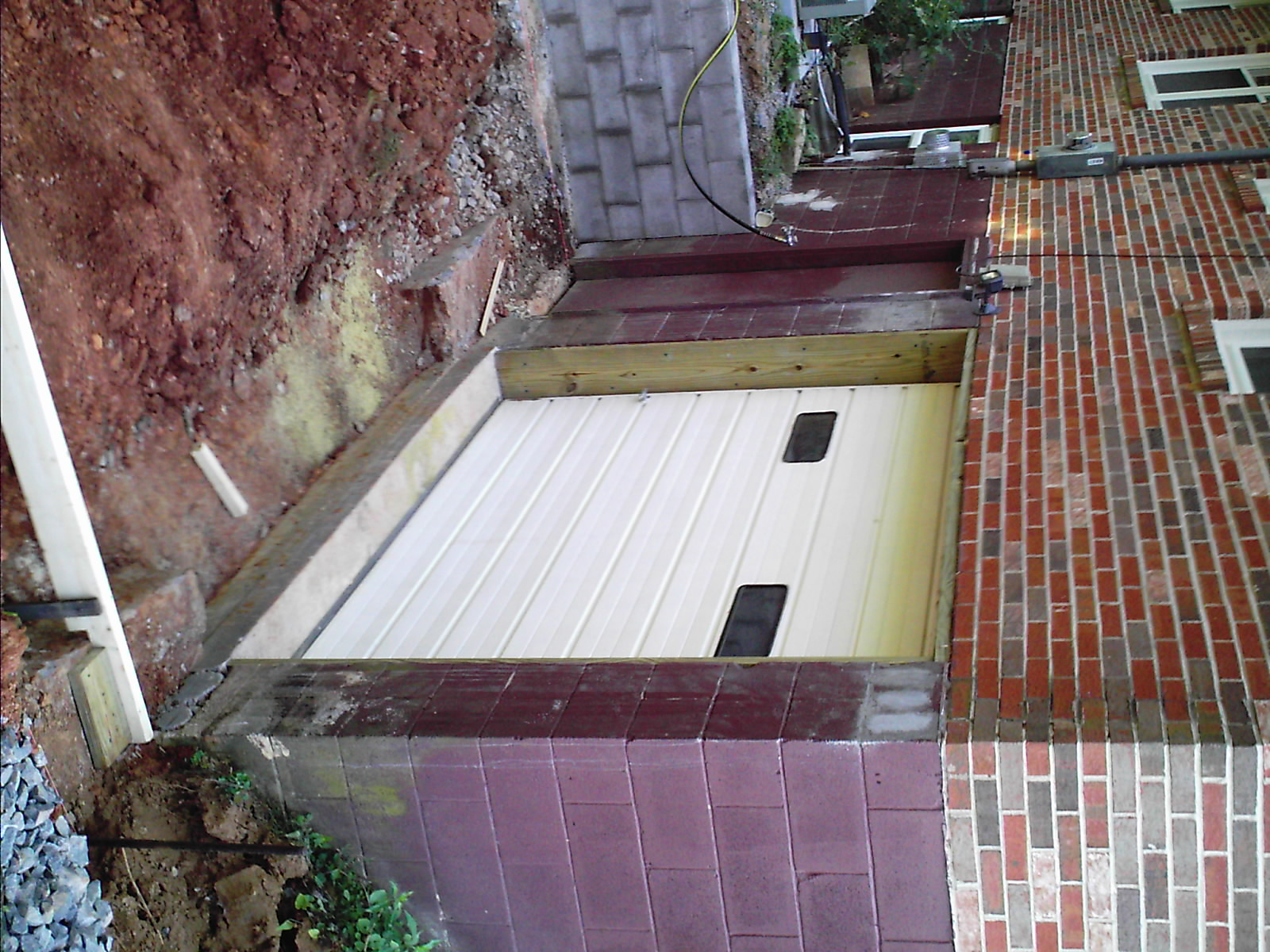

So, working on concrete out the back door.
New (used good condition) garage door installed this morning and all the wood framing stuff changed for $130 including door. Can't beat that with a stick in my book. Wife want's french doors later.
After much uhhhhh discussion,, yeah, that kind of discussion that goes, well TELL ME HOW THE H#%$%@#$%$ YOU WANT IT AND I WILL DO IT THAT WAY!!!!!!!!!!!!!!!!!!!!!
I came to a good feeling on what the concrete drive should look like and I even think the DW can deal with the end results. It was another of those deals that every time I moved something, it potentially effected something else.
12 is Big Daddy :D Had to feed him, but got my money's worth today, thank goodness for Buffets :cool:
Finally settled on my pad being 6" gravel, and 6" 4000 psi concrete. Rebar on edge's Mesh in middle. 1/8" fall.
About 36 X 15.

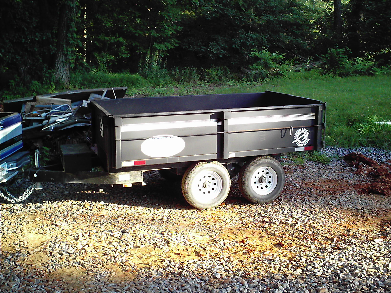

In keeping with the TRACTOR part of the post... :D
My dump trailer that nicely hauled the form boards from Lowes.
My PHD stand, after I put my PHD on it figured sure enough the garage door guys would show up as soon as I tried to do something else. :)

What is your camera white balance set to. If you are indoors and have tungsten (regular light bulbs), you should set your WB to that setting, the same goes for flourescent lighting, set accordingly, then try again.

I tried a couple different settings, I wonder if part of the problem is that those area's have both flourescent and Tungsten bulbs in them?
My "expensive camera" is a bit of tounge in cheek. I went into circuit city and said "give me the cheapest digital camera you have.
The guy said, well if you are serious, we have a Polaroid izone 300 for $30...... So that is what I have been using. (but it does have a little icon for flourescent / tungsten / outside) and the instruction sheet is one page, which is about all I can handle :)
Will try all the settings next time I am there (about 4) and see what the results are.
