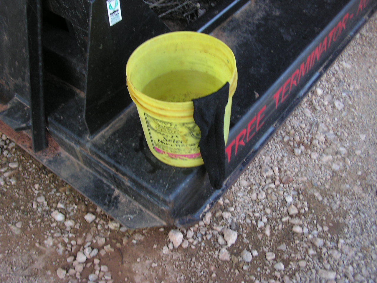

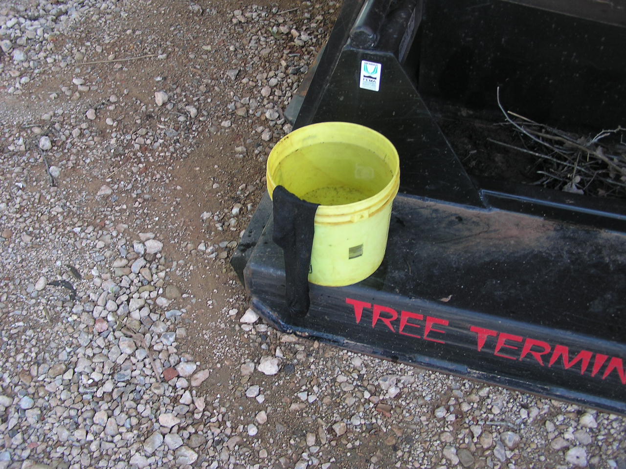

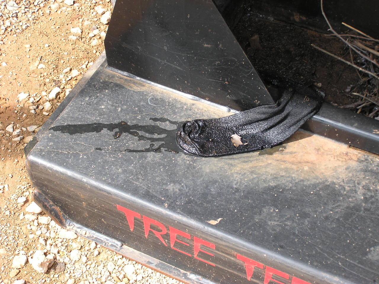

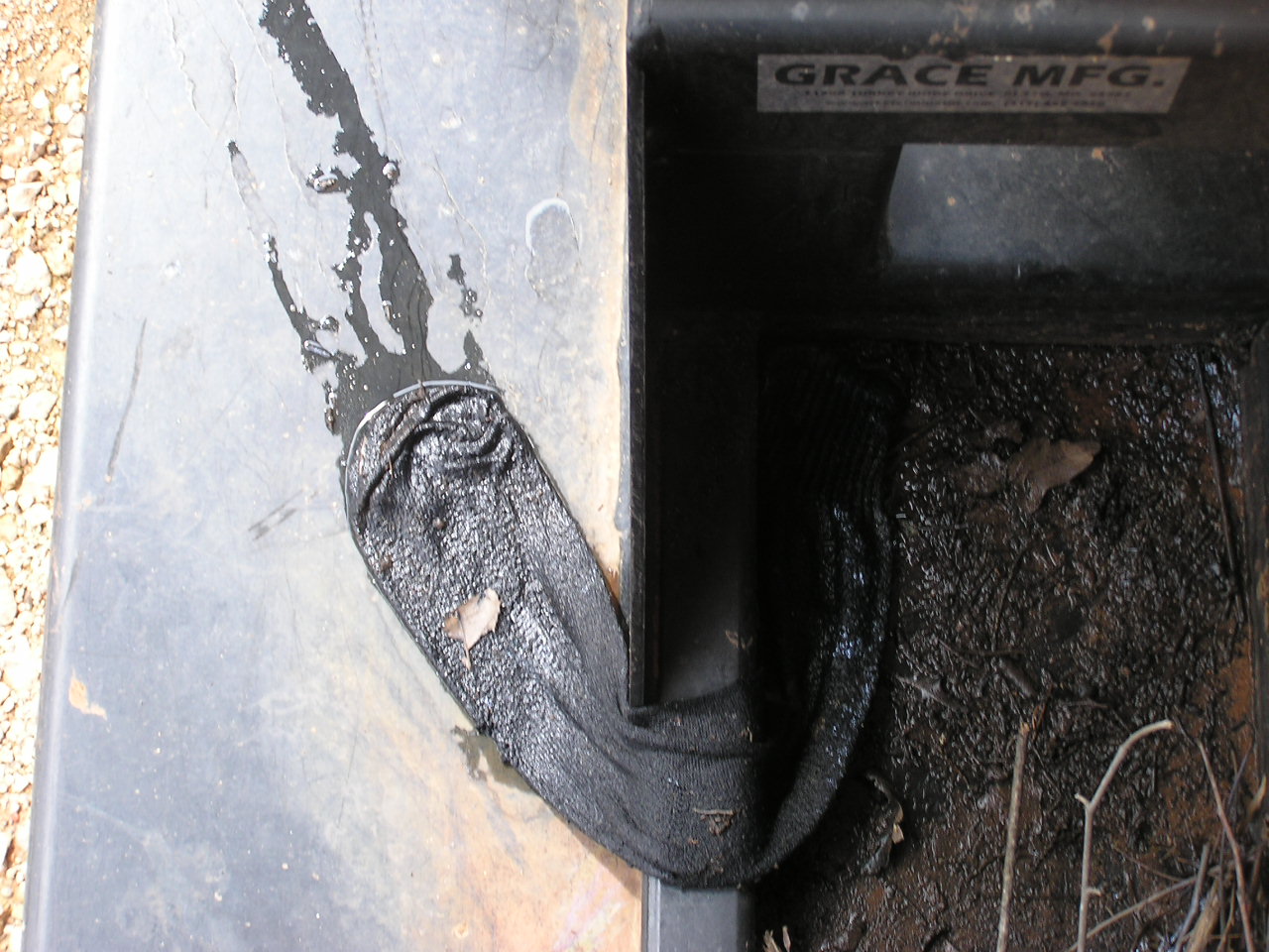

Siphon Sock
A siphon doesn't have to be in a tube or pipe.
Here is my Siphon Sock to remove rain water from the brush hog deck. I have used rags on things like this for many years.

Capillary attraction ... like a wick.
   / Alien Invasion - I want my pond back ! #178
Not many people would think to use a smelly old sock to empty a bucket!:laughing:

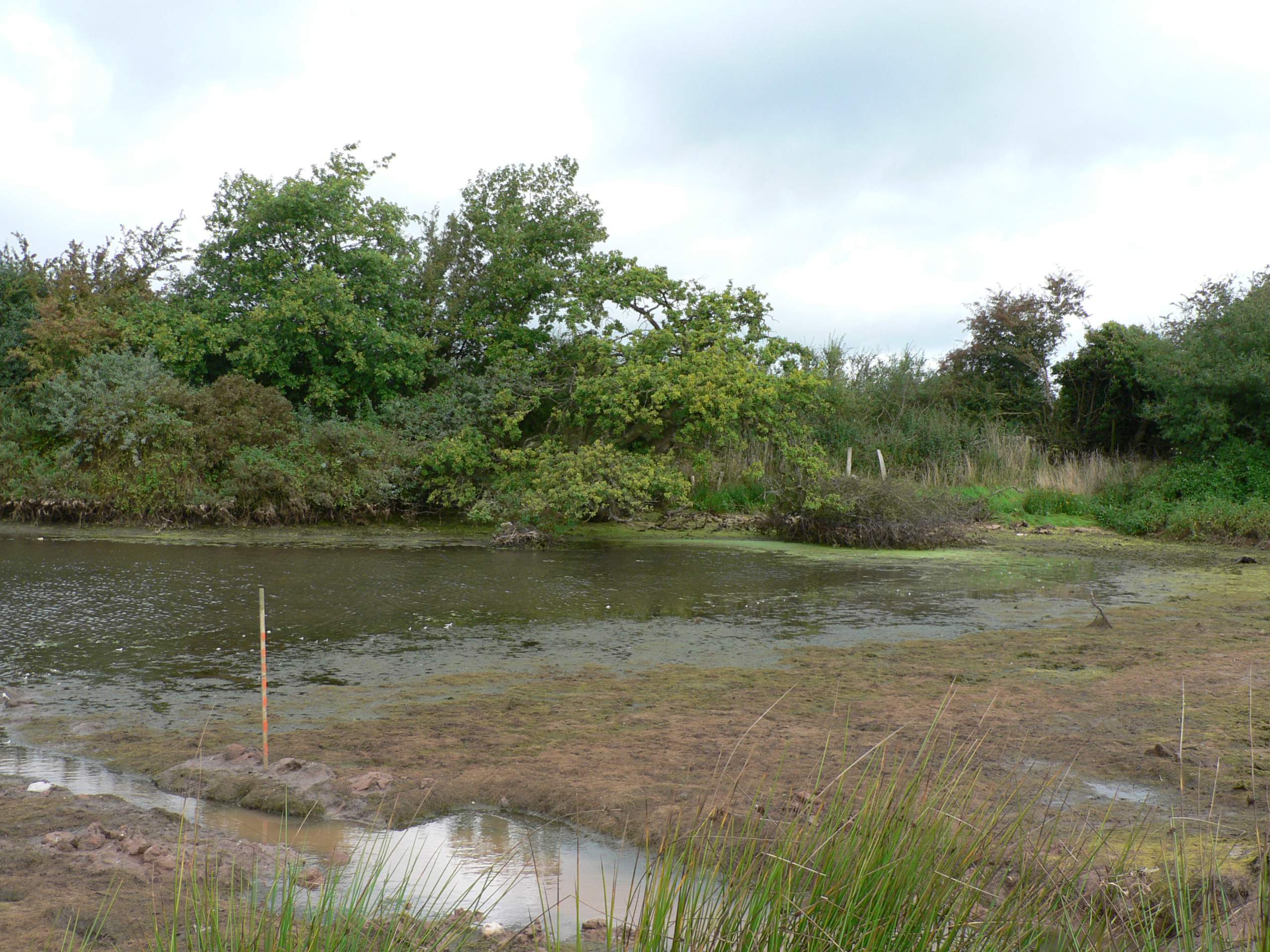

Two Weeks In

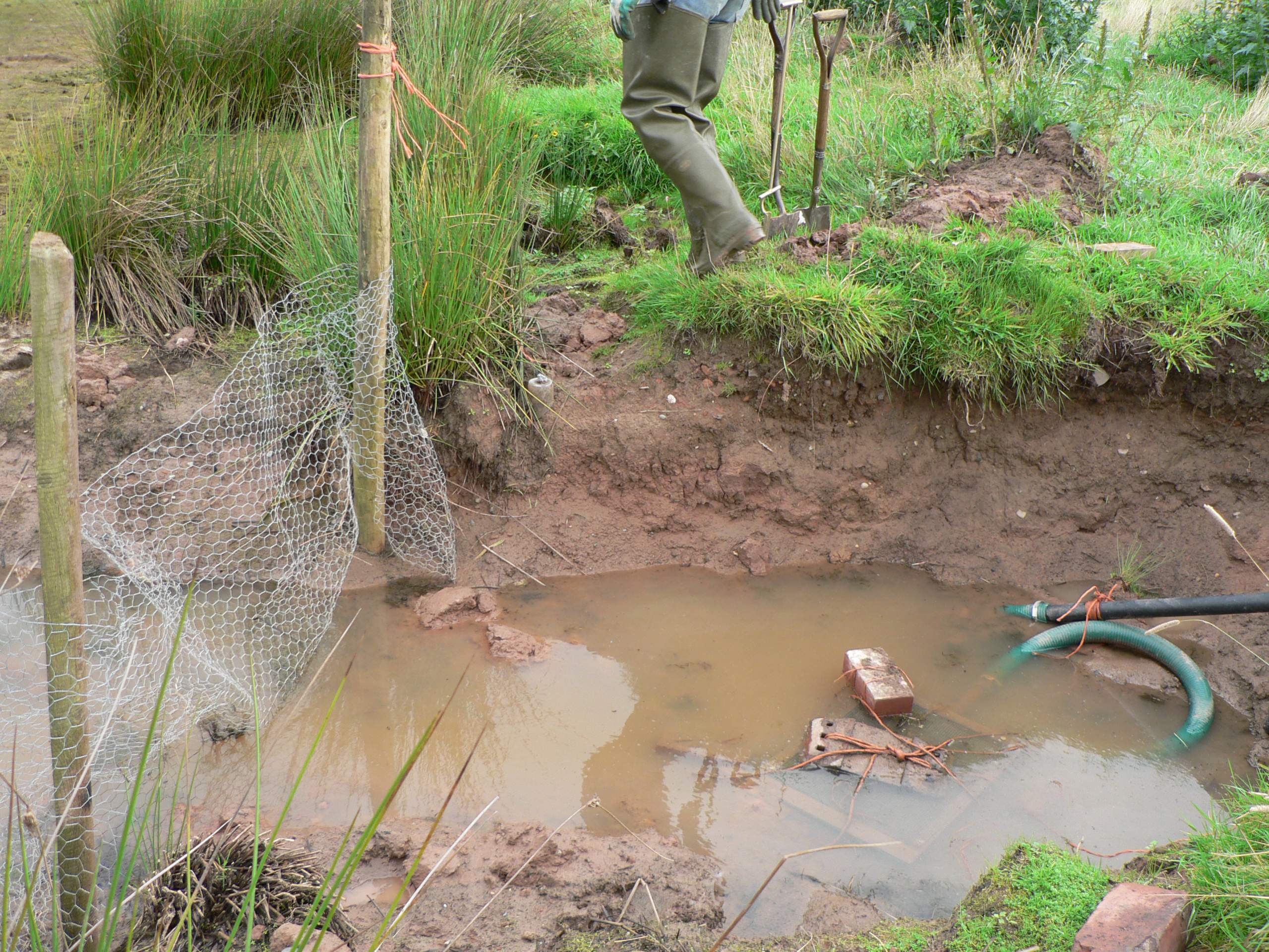

Another week had gone by and that water level had kept on falling all the time. It was now almost down to the filter in the sump.

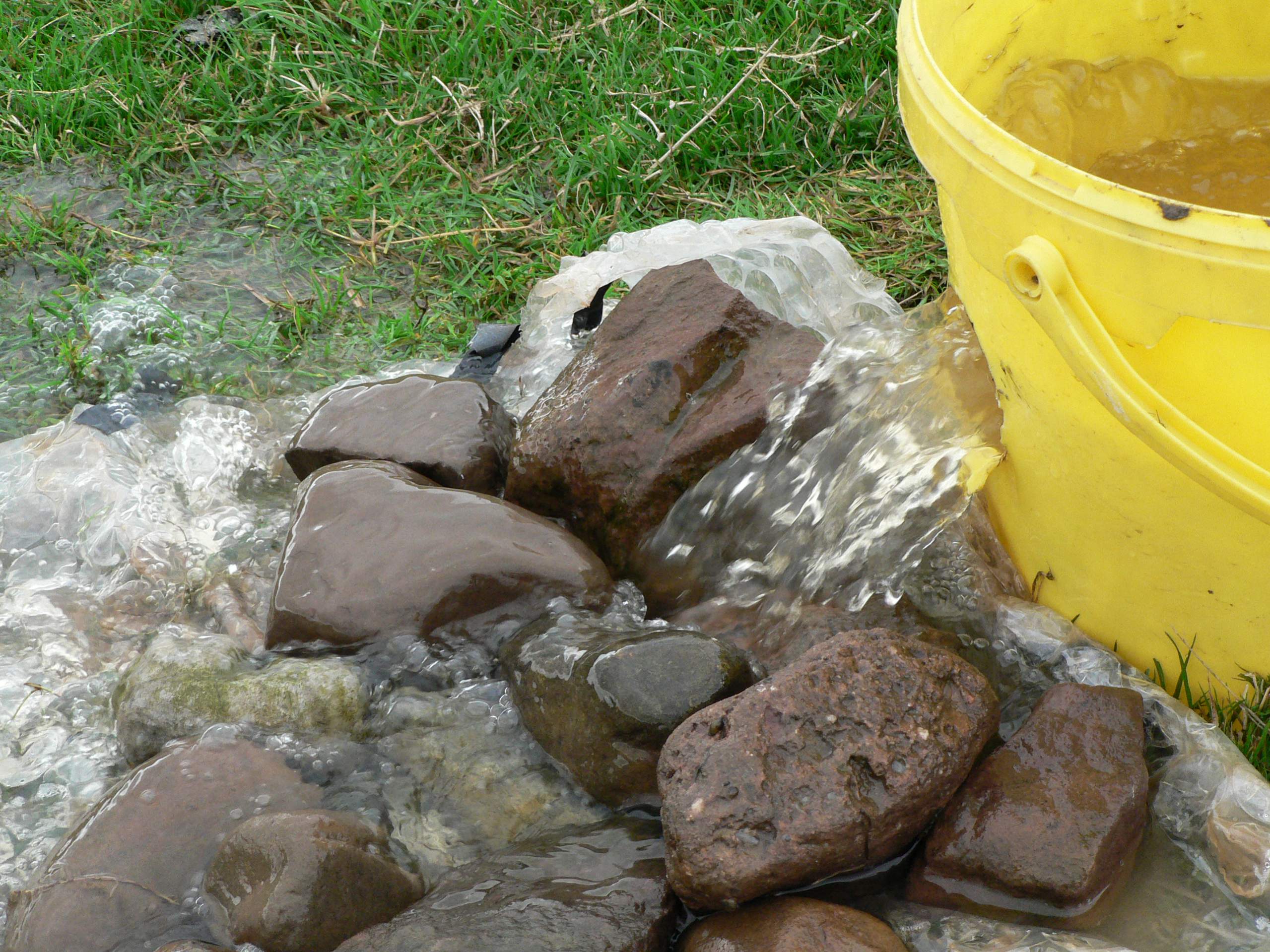

Time to get the spade out and dig the sump a little deeper. While I was in digging mode, I set to and deepened the narrow channel leading from sump towards the centre of the pond. I also added an extra length of pipe to the outlet. This really got the water moving, almost overflowing the bucket despite the 2" hole in the side.
Water slide
Everything has it's consequences. Speeding up the water flow had helped move a lot of water overnight and sucked out a deeper hole in the bottom of the sump. It had also eroded away grass and soil below the bucket. No problem, simply lay an even bigger sheet of plastic on the surface. There were dozens of baby newts under the old sheet. They had been using that pipe as a giant water slide and were now trying to work out how to get back up for another ride.

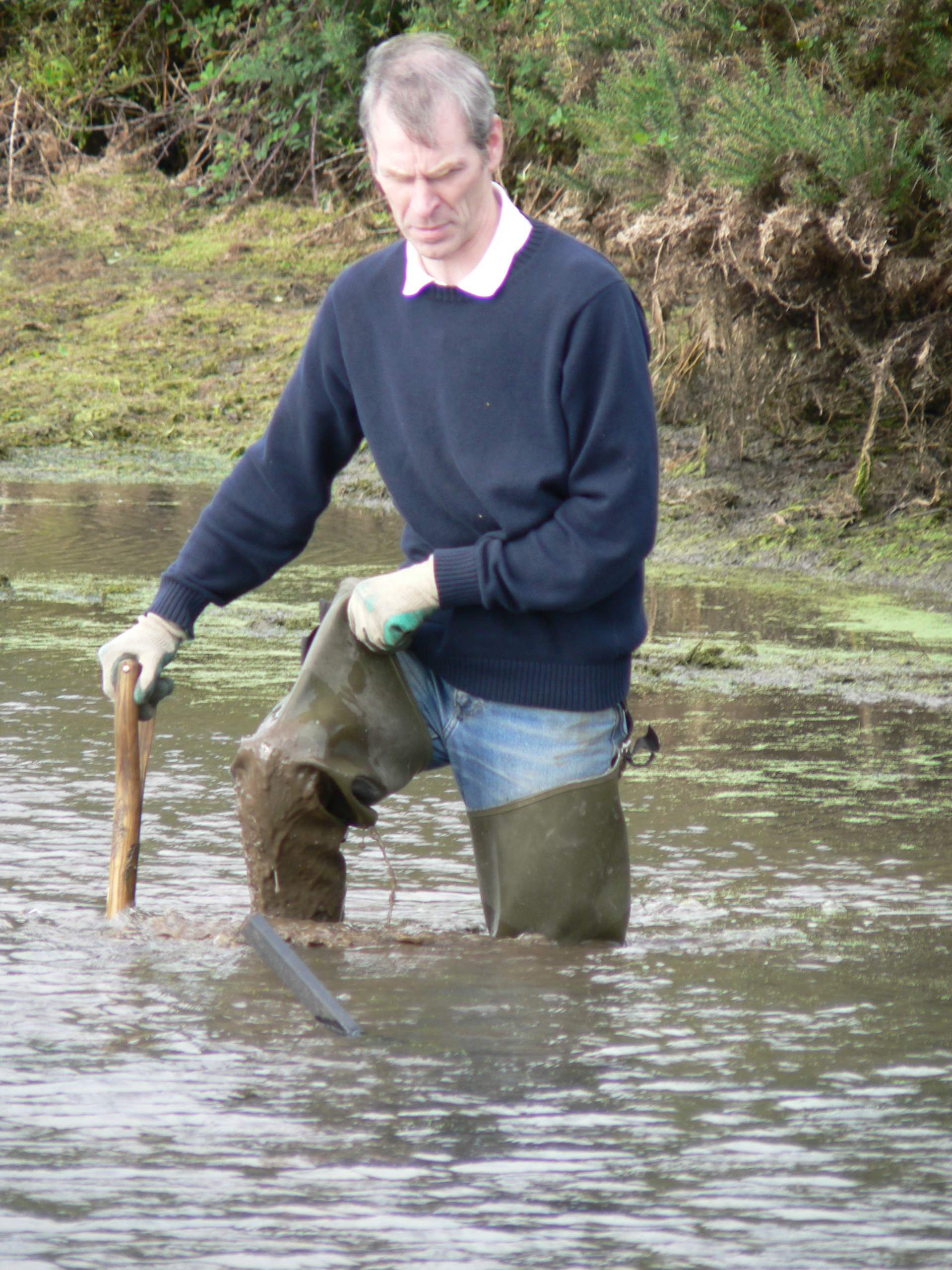

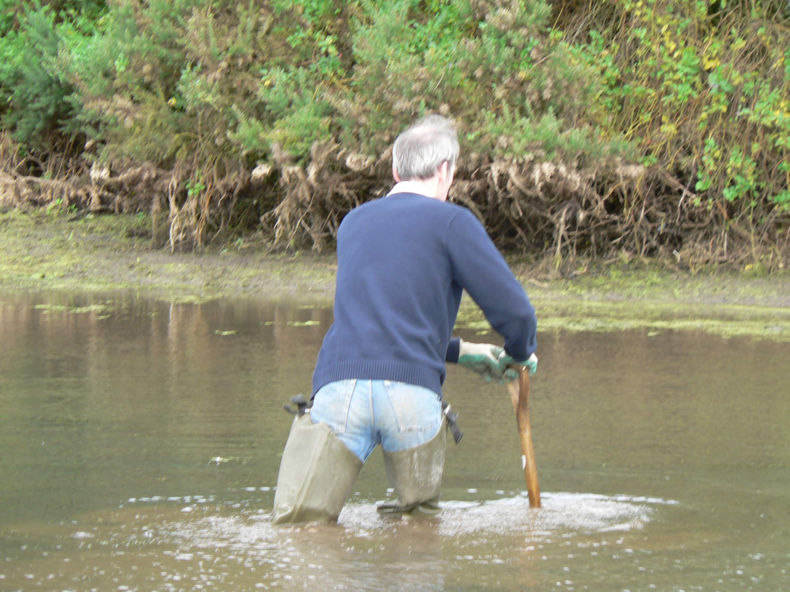

Filter Mark 2
Within a day the sump was dry. With another extension pipe on I walked the filter box out to the deeper water over on the far side and came back to the bank, only to find the extension had pulled free. I waded back to put it back on, but couldn't find the filter. Returning with a spade, I set up a wider search pattern. How can you loose a box that size ? I found a few cans and bottles, corrugated metal sheet and even a children's pink bicycle, but I never found that wooden box again. My wife thought this was funny and unbeknown to me snapped pictures of me searching and wearing a very puzzled What the heck is going on expression.

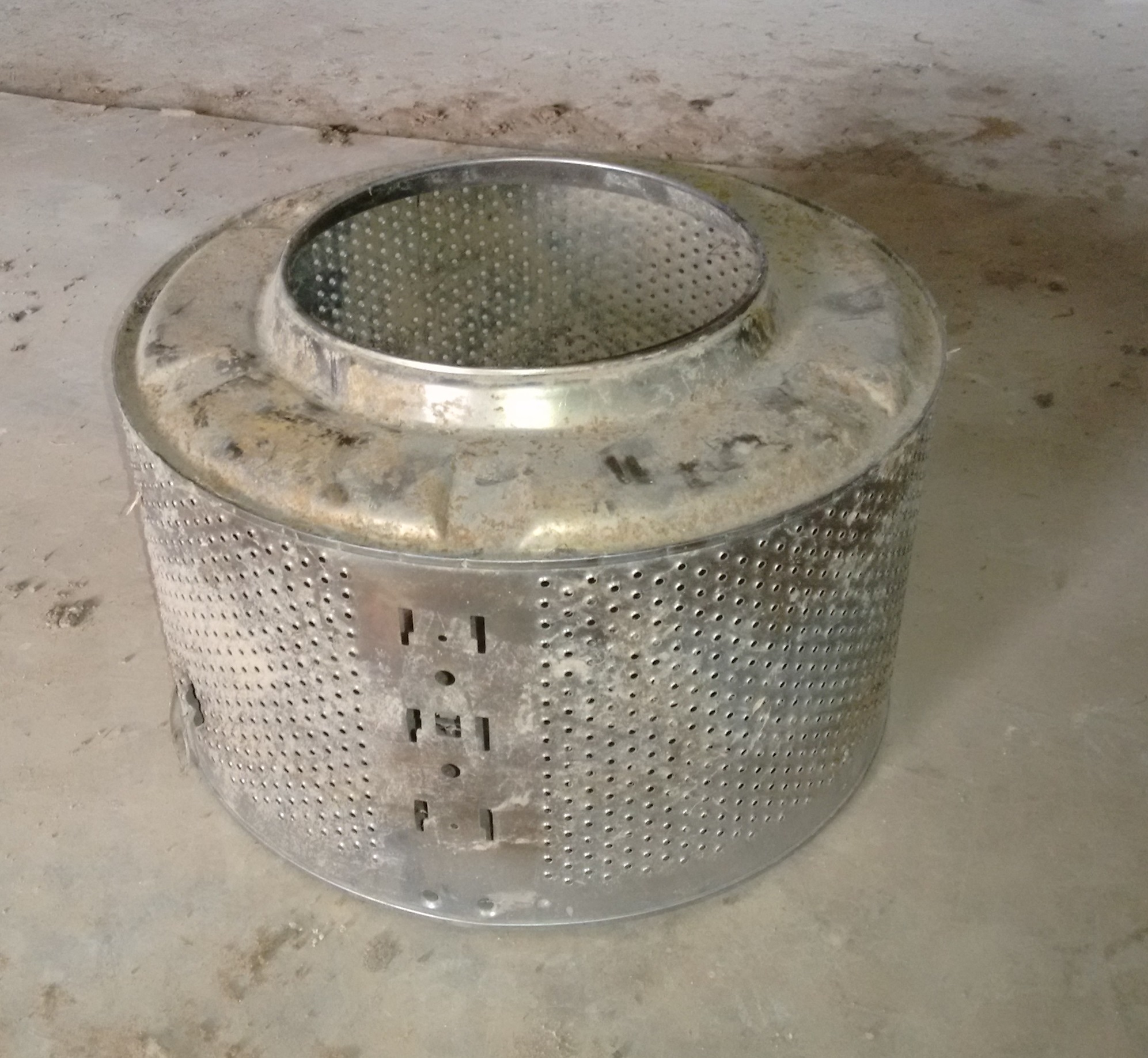

It ran ok for a short while without the filter, but then kept getting blocked in the mud. Out came the reserve filter. An ex-washing machine drum. Very effective. IMG_20150520_170129.jpg
