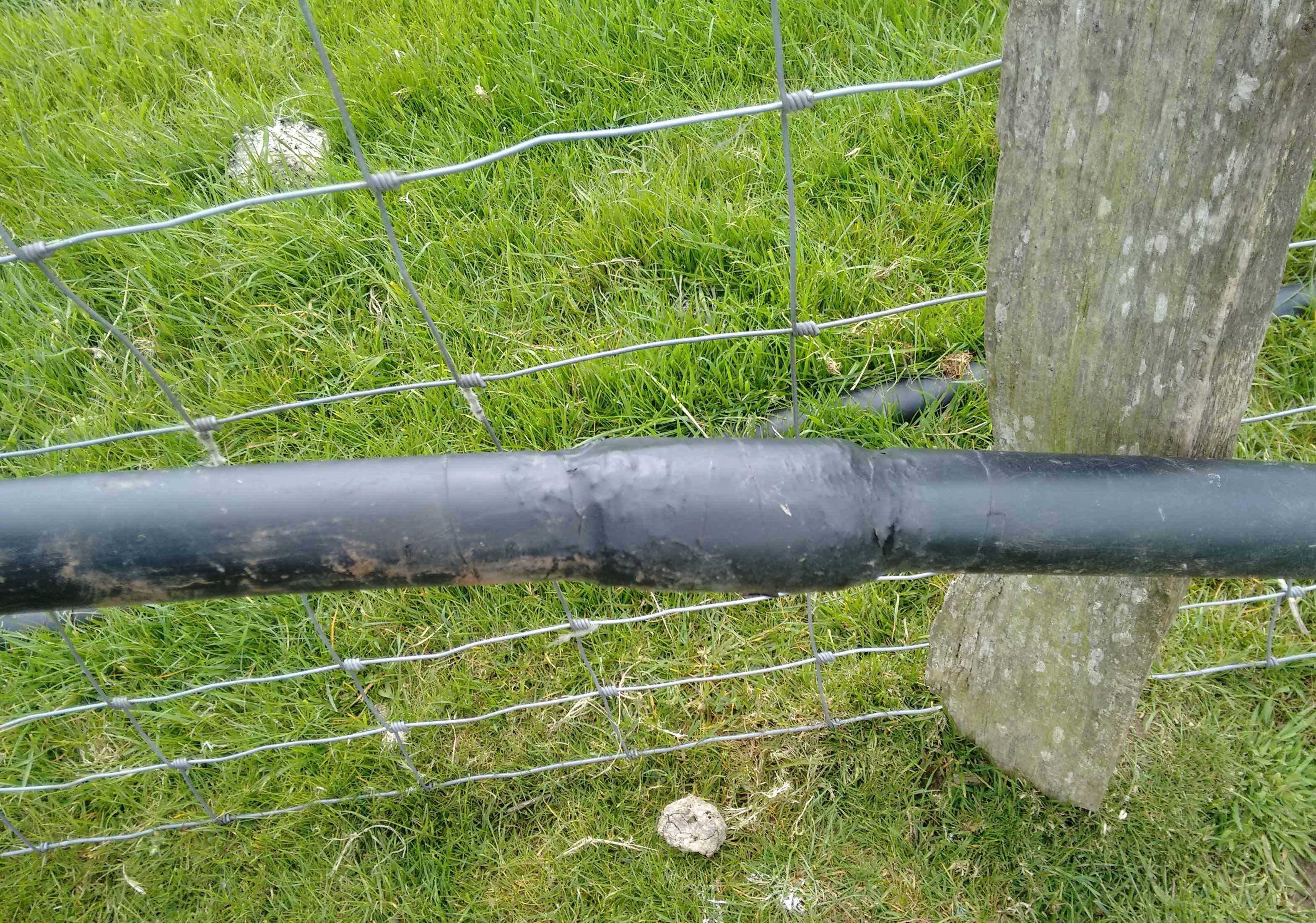

Now all I had to do was join and repair the pipes. 2" compression couplers are not cheap and anyway, were against the rules, as by then I was determined to try and empty the pond for free. I had read a little about butt fusion weld joints and was tempted to have a go at a home made version, although time was not on my side. Then I remembered dismantling an old storage tank, which had a short length of plastic pipe on the outlet. At the time I put it to one side, as it was another one of those things that was "too good to throw away", though I had no idea at the time what it could be used for. As luck would have it, the internal diameter of the hoarded outlet pipe was the same size as the external diameter of the 2" pipe. A perfect sleeve. :dance1:
With the permission of the pipe's owner I set to cutting out the damaged sections. A sleeve was made for each end, pushing it half way on one pipe before butting the ends together and melting the sleeve in place with a blowtorch to make one long run of pipe. A quick test with the water pump on the end showed up a couple of poor joints that wept a little, but easy enough to seal.
For good measure I taped over the whole joint to try and keep air from entering the pipe as siphons work below atmospheric pressure. Siphons suck - potentially, in a good way ;)

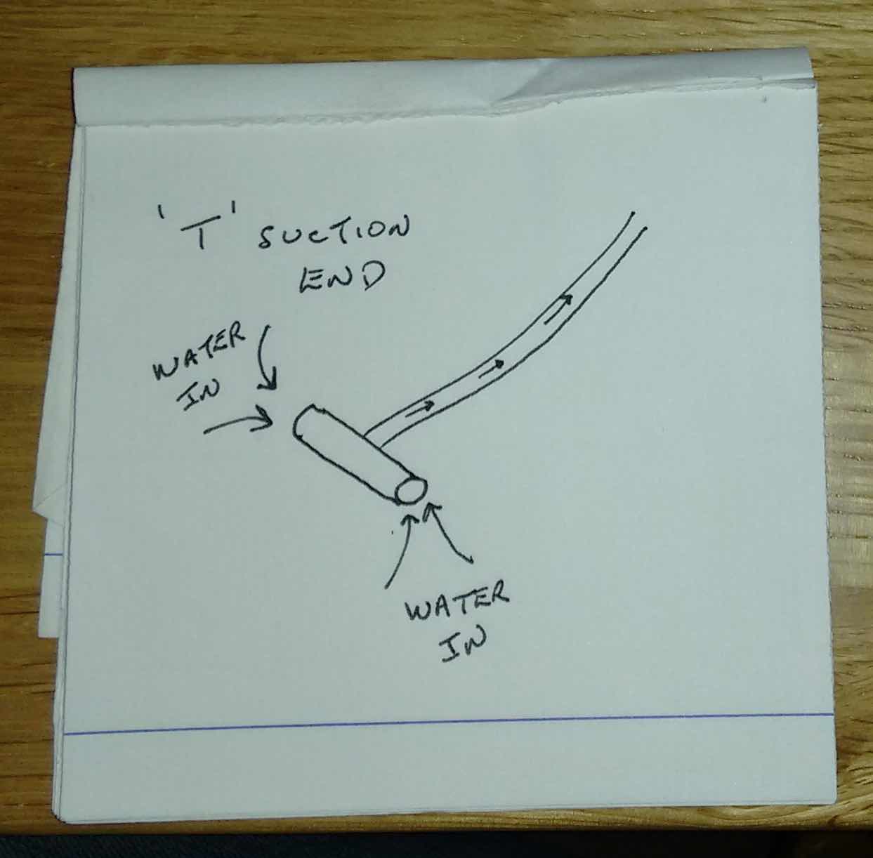

2) Increase the area of the last bit of pipe at the suction end. This doesn't alter the gpm going through the pipe, but does slow down the water at the point of entry. For example, fitting a "T" section on the end of the pipe would double the area and half the velocity. pipe ends.jpeg

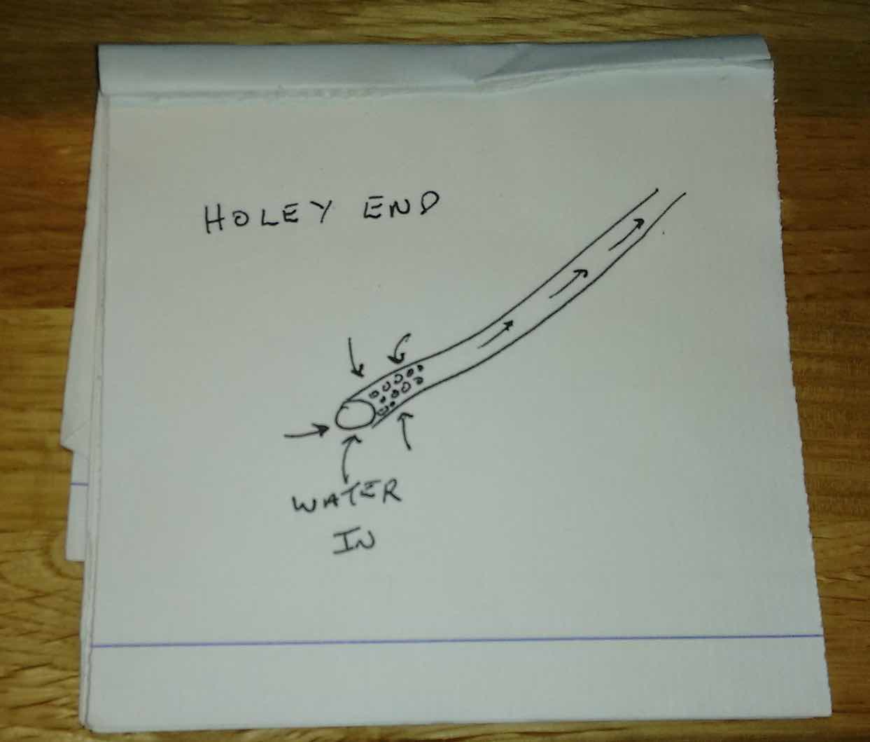

I made up what I thought was a simple alternative - drill holes in the sides. With a sharp drill bit I drilled lots of 10mm holes in the last 10" or so of the pipe to give a similar area-increasing effect and crossed my fingers that it would work too.

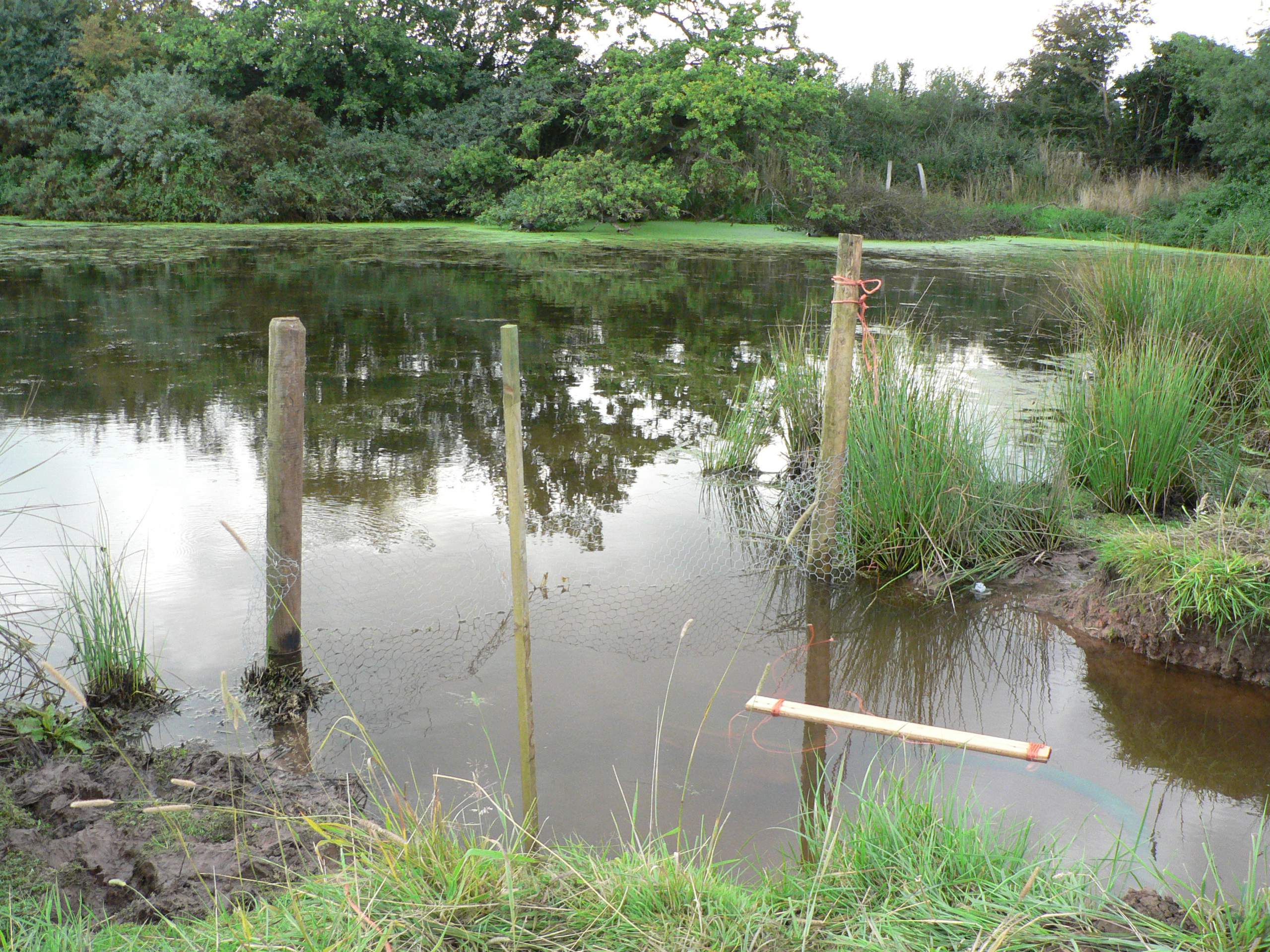

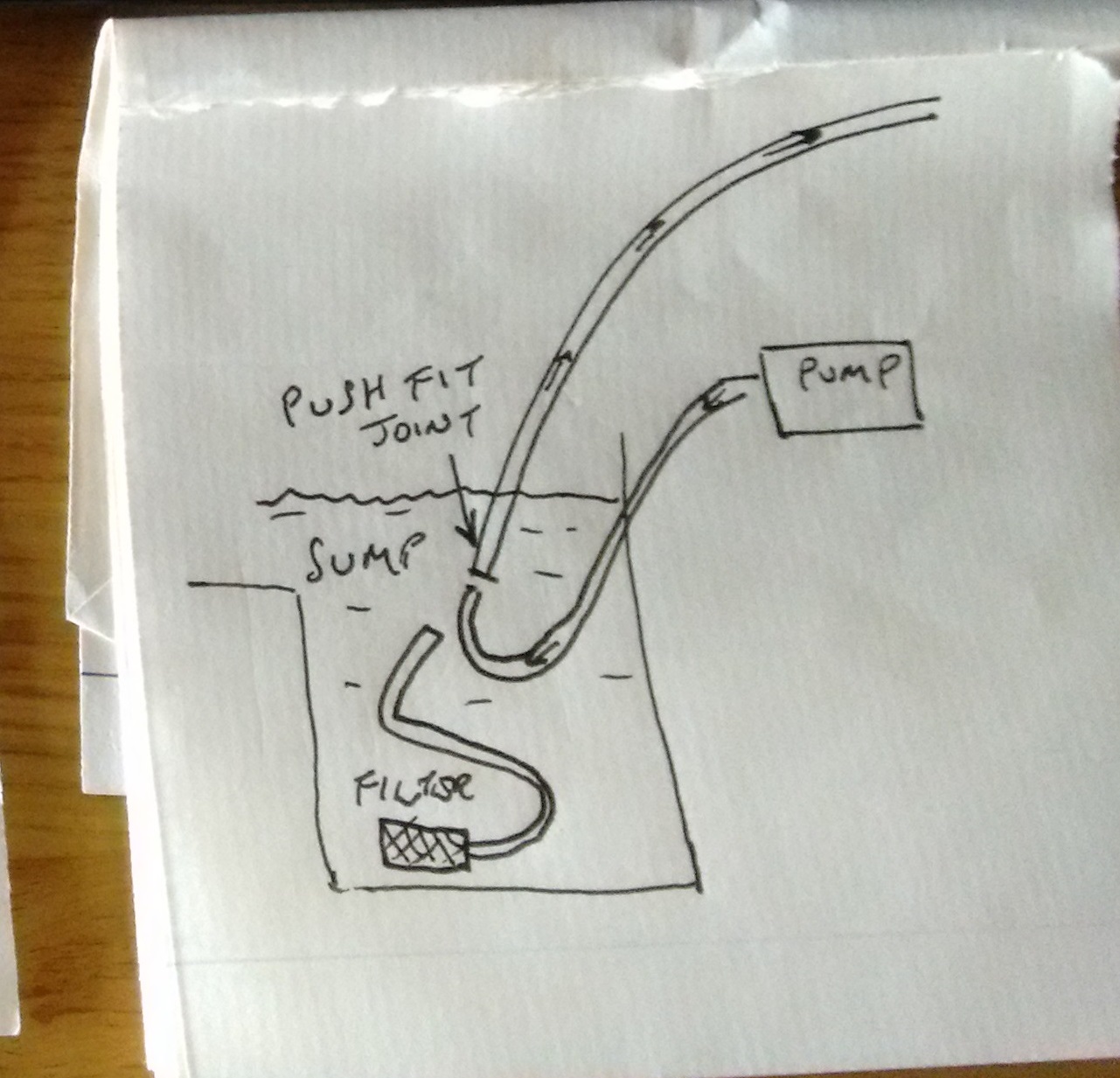

A sump had been dug out at the edge of the pond, with chicken netting stretched across the mouth of the sump as the primary filter. The filter box was dropped into the sump and weighted down to the bottom.
All set to go, except for one bit of detail. How do you prime a siphon that's over 200 yards in length ?
