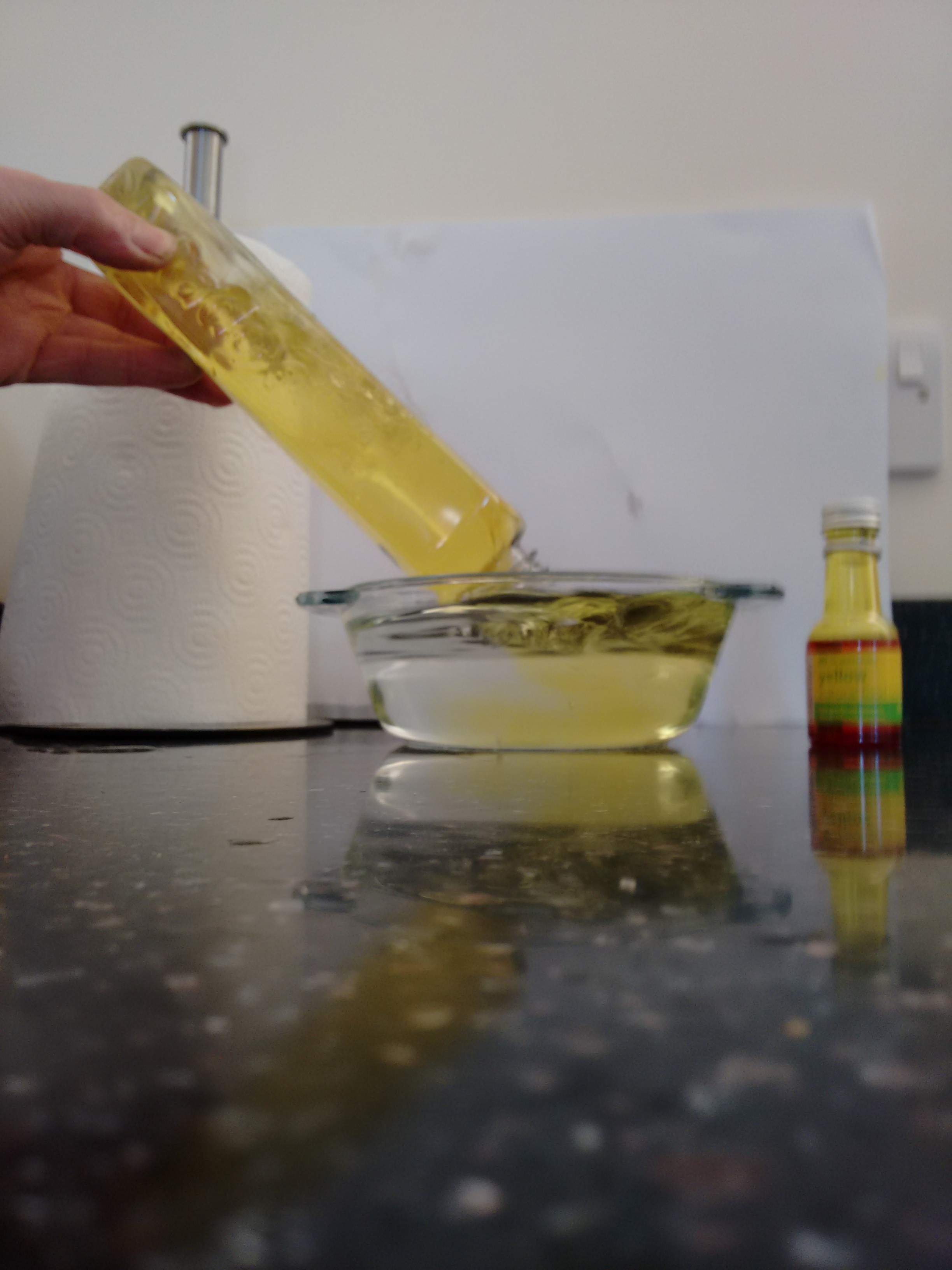

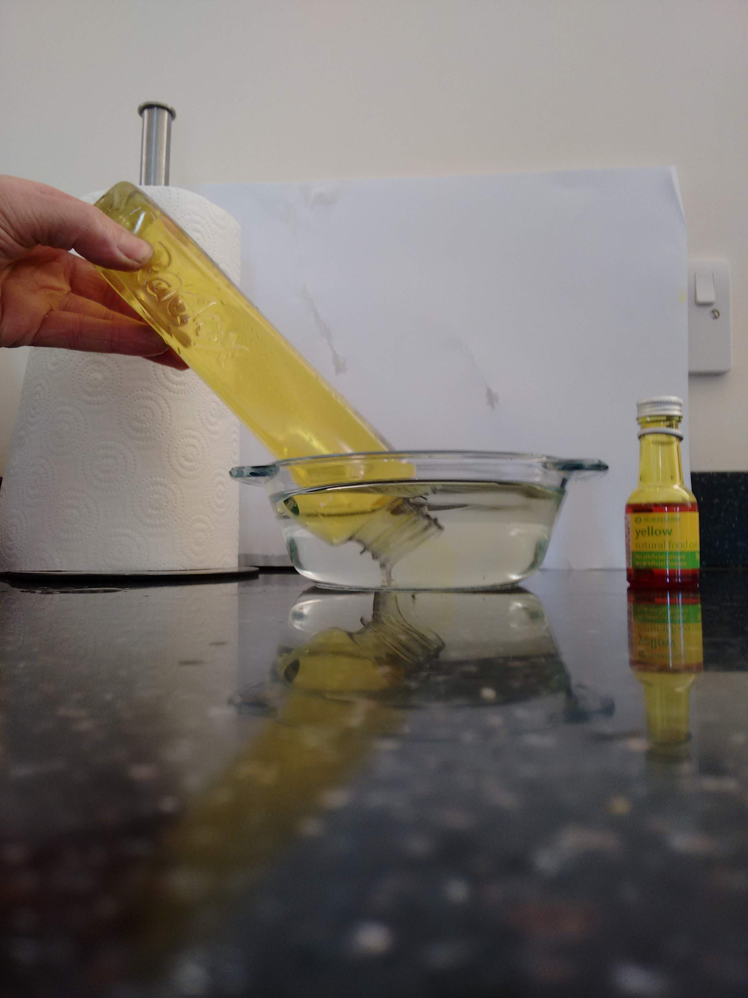

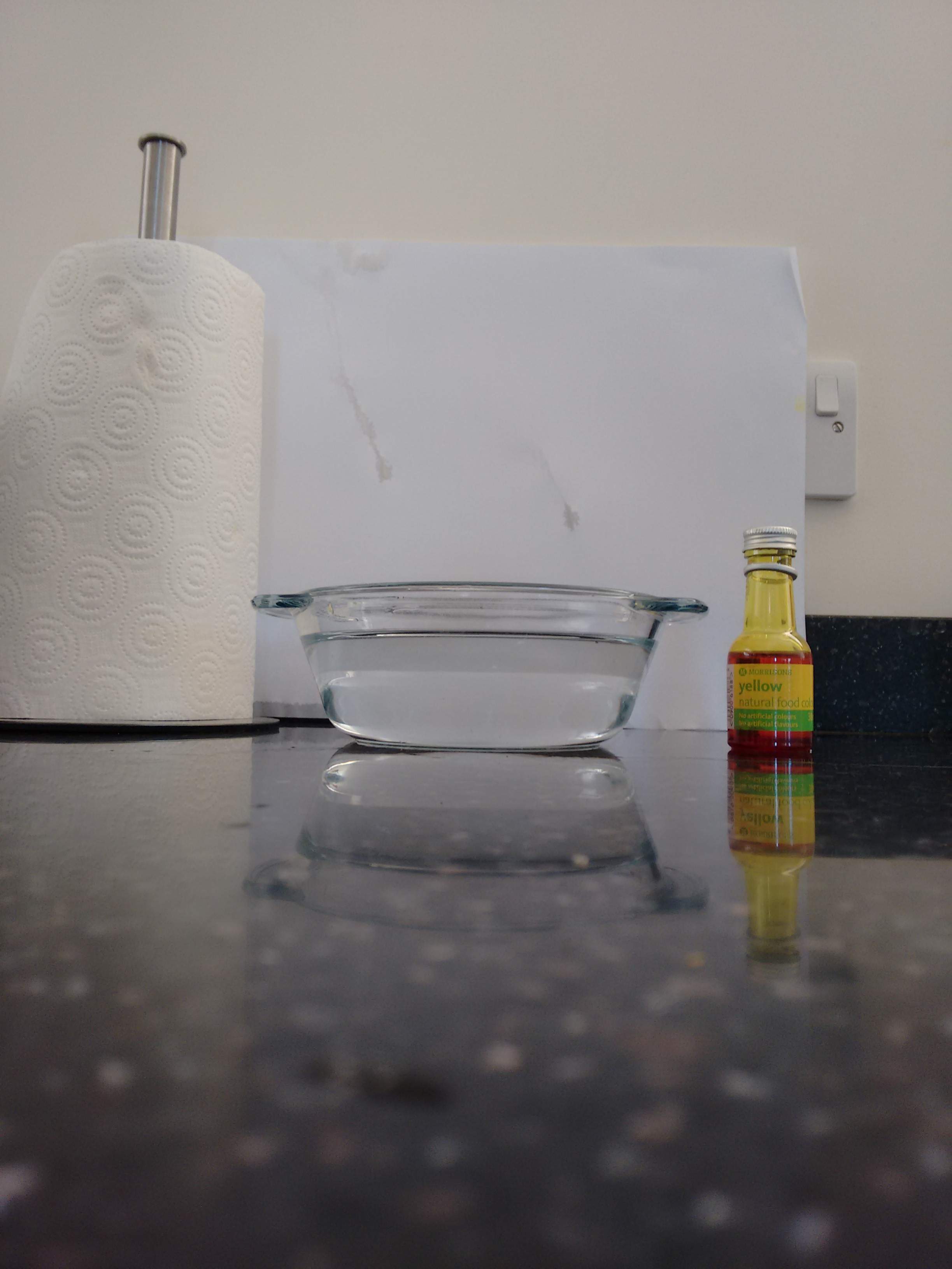

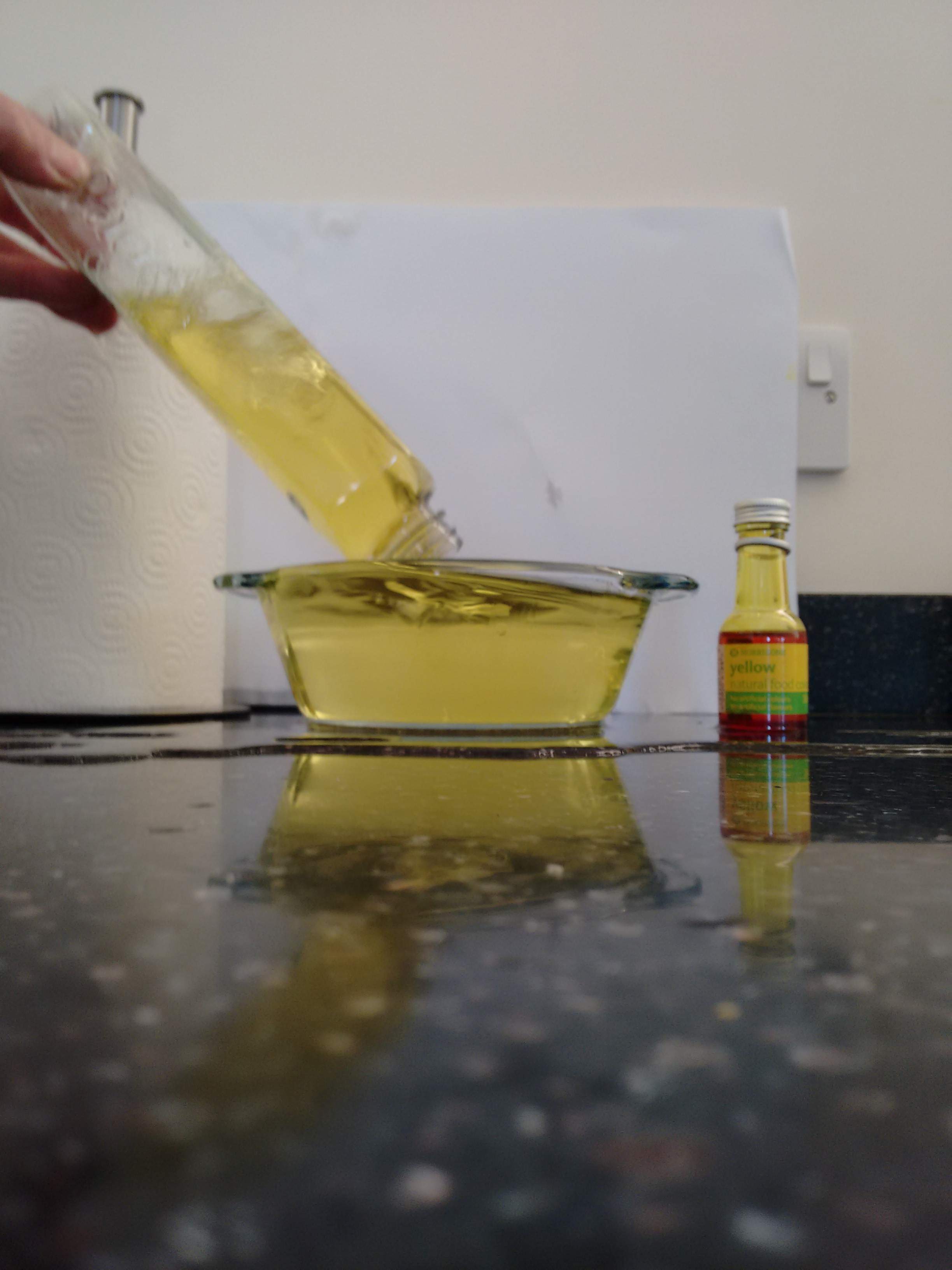

The Yellow Bucket
This was suggested by my good friend Joe. He and his brother were the ones who lent me the pipe and were the only people who thought this siphon idea might have a half chance of draining a pond. Now Joe didn't learn a great deal at school, probably because he didn't go that often, but he is smart and one of the worlds best a solving problems in a practical pragmatic way.
I should have put the bucket on from the start. It is to stop air leaking back up the outlet pipe. Without a bucket, air will not get back into the pipe when all is running full bore. If, however, weed starts to block the filter, the water flow reduces and air can come back up the outlet. The whole siphon then has to be primed again after clearing the weed.
With a bucket on and the pipe coming in at the bottom of the bucket, water covers the pipe. The magic of air pressure on the surface of the water stops the pipe from running dry. The hole half way up is another Joe idea to give a better indication of the rate of flow (and as SPYDERLK said, adds a precious few inches to the head of the water column).
Not clear yet? Ok, I can demonstrate the principle of what happens with a totally blocked filter :-
Imagine this basin is the bucket.
And this bottle is the siphon pipe.
(My wife insisted that I kept the food dye in the pic so there is no doubt about where the yellow water in the bottle came from.;) )
Just to set everything up, I have kept the top on until the mouth of the pipe (bottle) is below the level of the water in the bucket. Now I take the top of the bottle.
The water stays inside the pipe ( Same principle as used in many inverted water feeders for birds)
If there was no bucket, the water would run out of the pipe.
