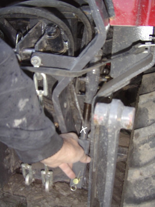

this is the piece that should be removed whenever the backhoe is installed or the 3 point hitch is not in use.
I was lucky twice, found it laying on the deck of my trailer once, and laying in the dirt another time. btw, does anyone know what size/thread pitch this is (for jam nut)? I'm guessing it's metric.
I also remove the top link for the 3 point when not in use, not sure that it is necessary but it doesn't hurt. :)
sometimes when the backhoe pin on the left side of the tractor won't go in, it is because the lower link on that side is bound up behind the pto side shield. I will get a picture next time and add it.

That lift rod, the threaded one, got bent on my tractor somewhere along the way. Do you think it was impinged on by the BH, and is that why you say to remove the end of the lift rod when it's not needed? Or is that it unthreads and works its way off over time? --Thanks, Scott
I don't know that it is susceptible to the same binding that occurs on the other side because the turnbuckle is a lot larger diameter than the rod on the other side, but the point was to remove that piece before it unscrews itself and falls out somewhere that you can't find it.
I doubt you could bend that rod trying to get the backhoe on, but maybe. the rod on the left side binding is just a nuisance that causes some headscratching to figure out why the backhoe mounting pin on that side won't go in.

I lost that rod (see pic about three post above) once in the past and cost me over 70$ to replace. It's bent from factory BTW. Now I still leave it on but I put a bungy cord (elastic cord) to prevent it from unscrewing whenever not in use. I guess this could be added to the original list of things to watch for.
