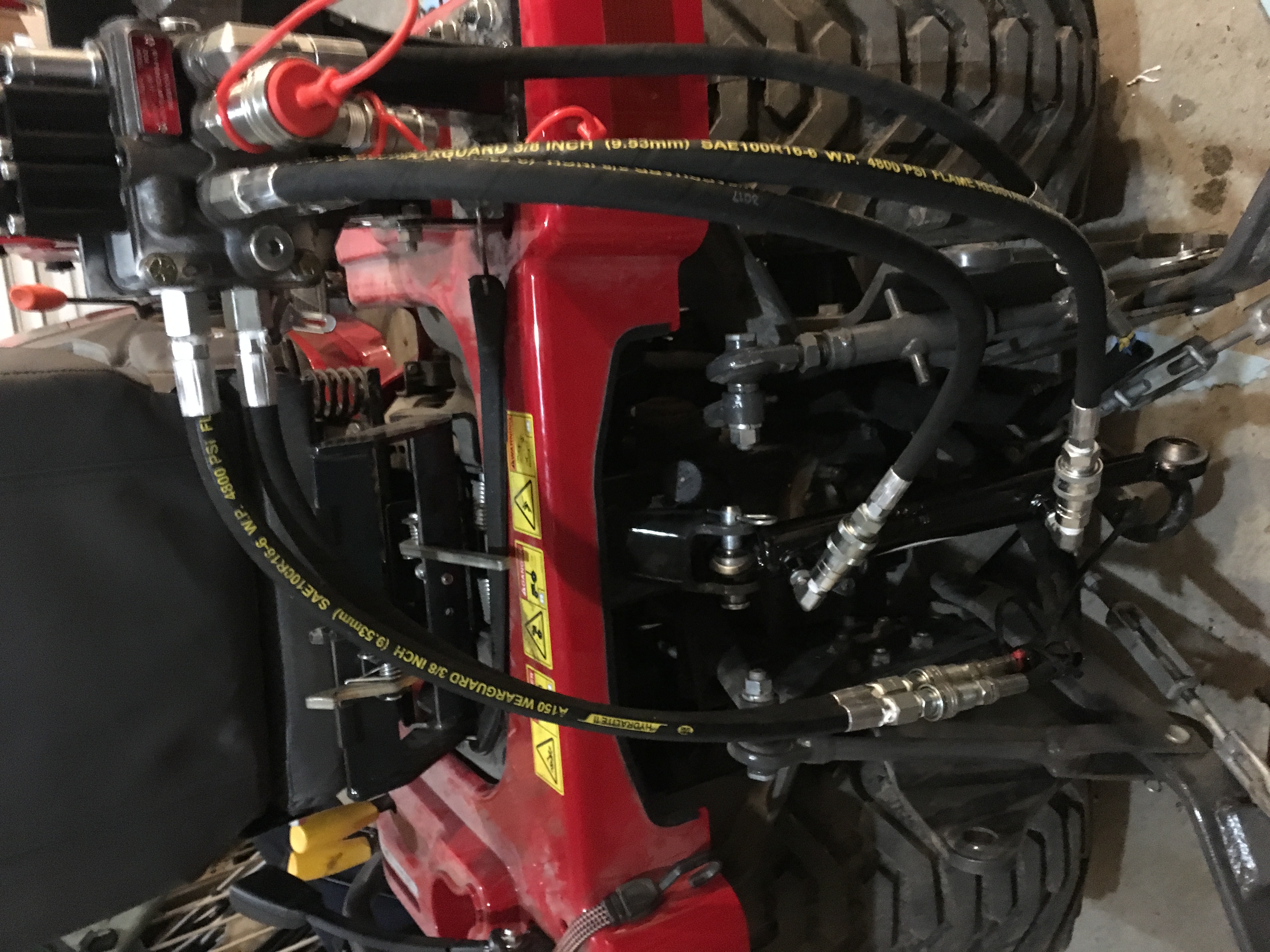

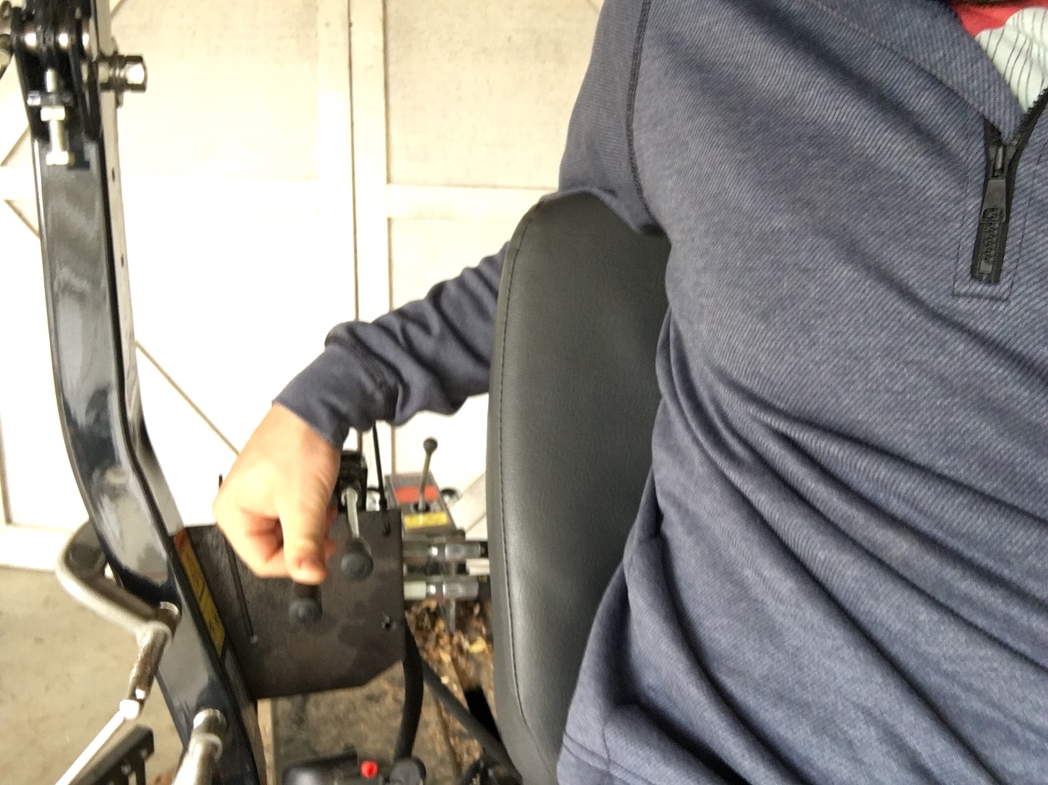

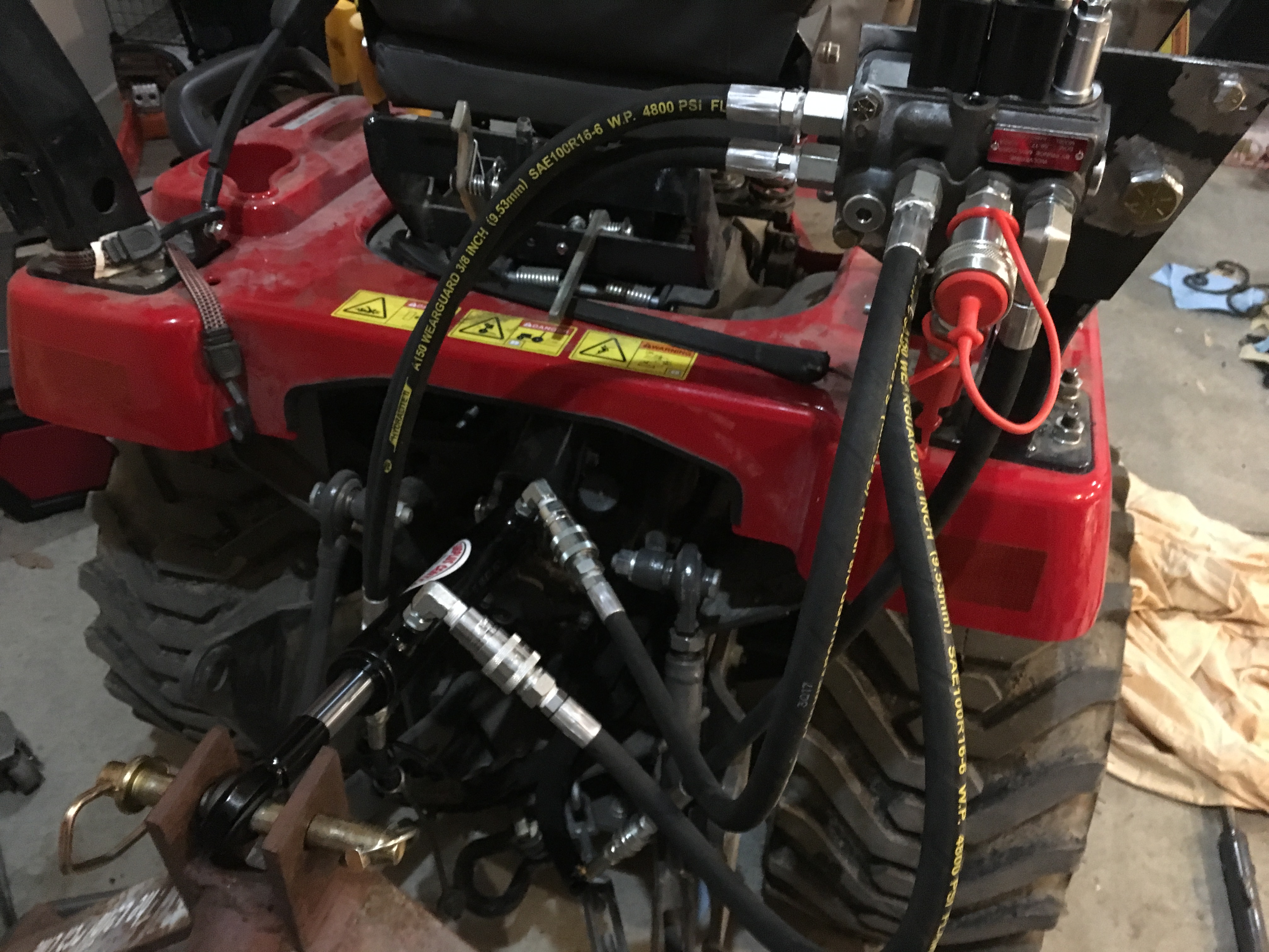

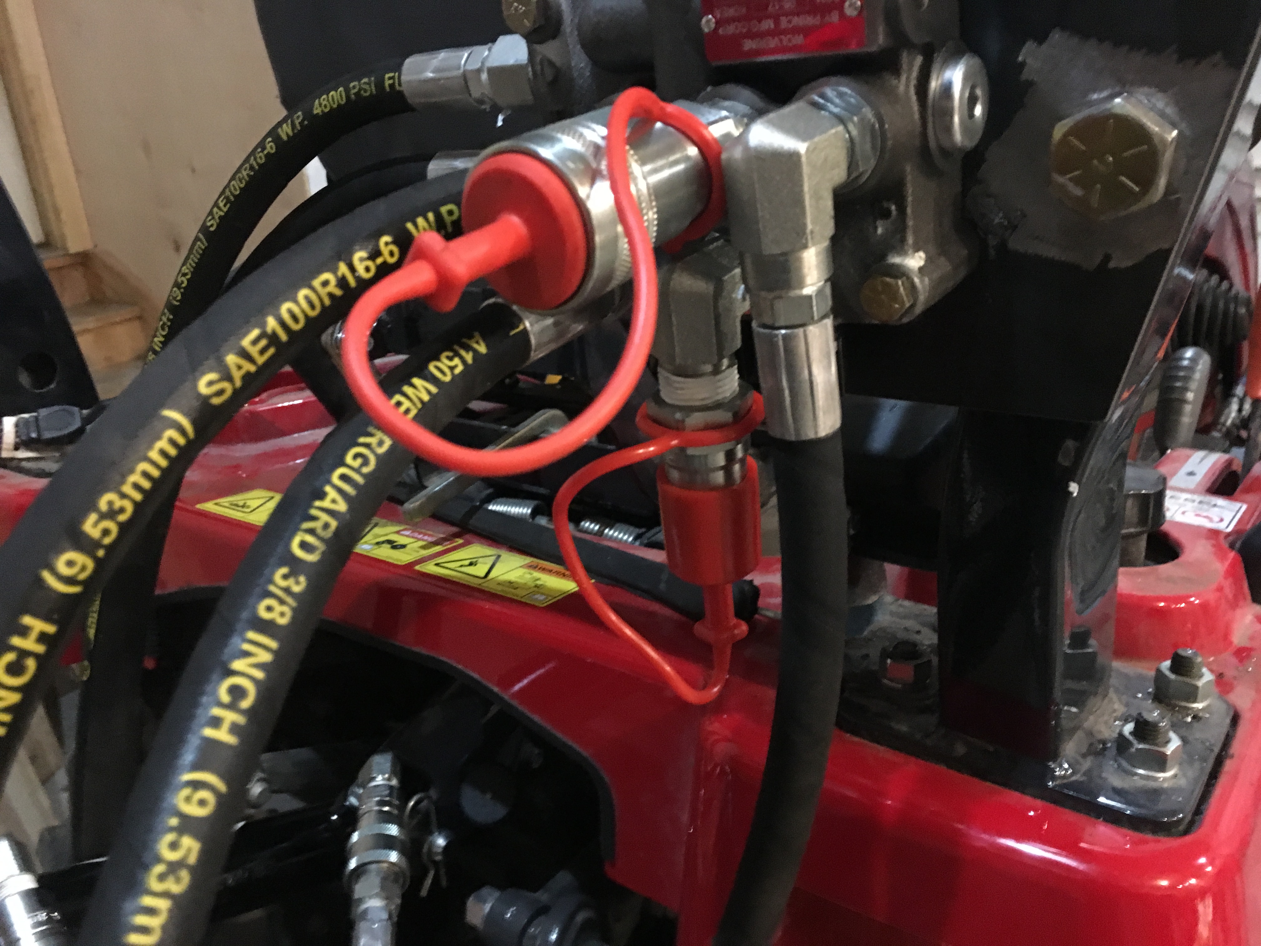

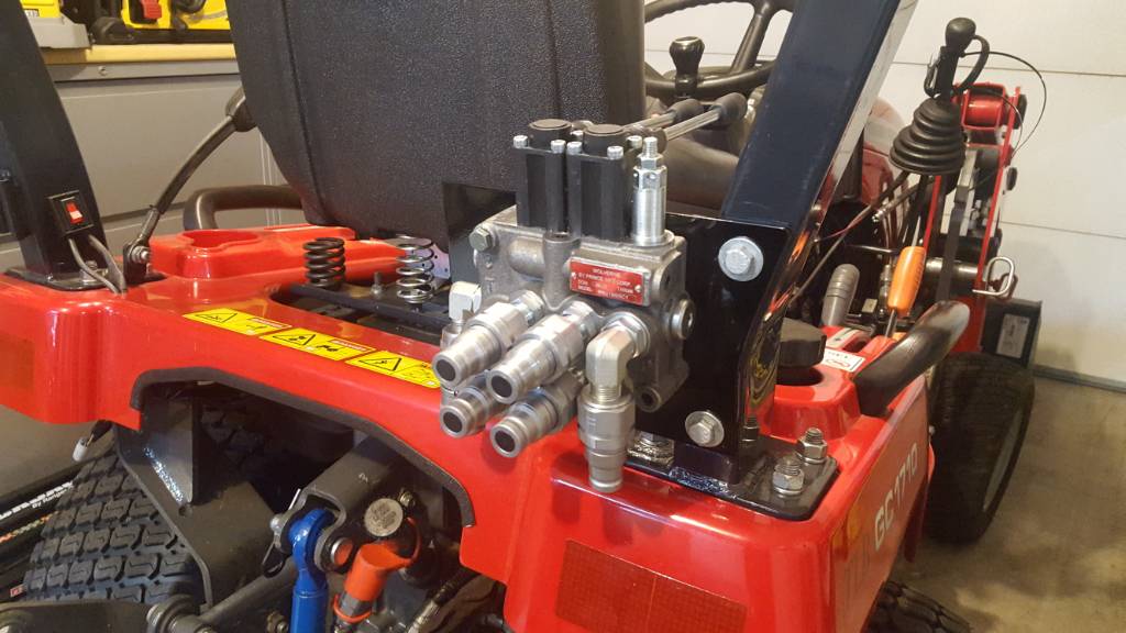

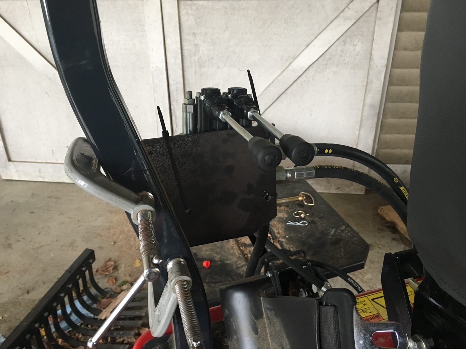

Prince valve, surplus center top link. Still looking for a tilt ram. The two spool for now will drive my back blade swing and toplink. Need to do some hose management, finish out the mount to the ROPS, and order a few more fittings. The mount to the ROPS will be quickly removable for backhoe ops. I️ should have it finished out next wknd. IMG_3370.JPGIMG_3371.JPGIMG_3375.JPG
   / Almost complete: 2 spool 3rd Function top-n-tilt for GC1710

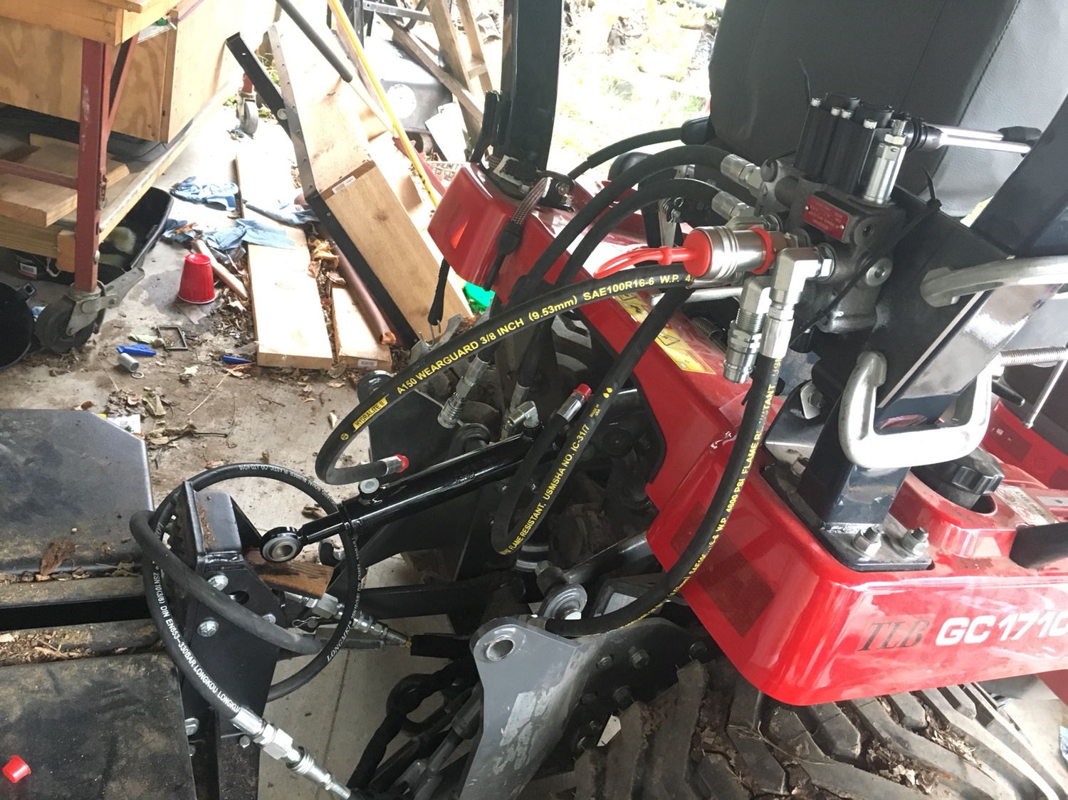

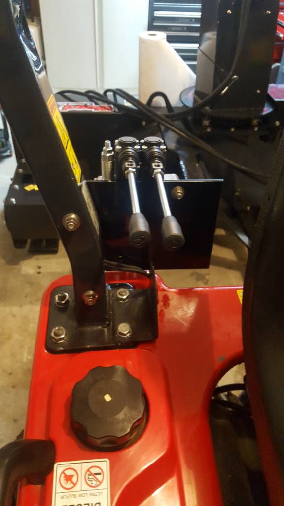

Installed and ready for snow, need to weld a few things, paint, some finishing touches, but it works, no leaks! The 2nd spool will angle the back blade for snow removal. I really needed the toplink because this back blade is so big I couldn't lift it high enough on my steep driveway to clear....fixed now! I'm making it a quick connect system on the ROPS so I can quickly remove, it will basically be a single hand grip 3/4 nut that holds it in place, the smaller bolt is just a locator "pin". I used 3/8 fittings on one spool and 1/2 fittings on the other just because of parts laying around...will come in handy if I wanted to test or power something I'll have options.

   / Almost complete: 2 spool 3rd Function top-n-tilt for GC1710 #6
I hope you bought a Nomex flame suit with your valves and stuff. When the ROPS police see you drilled holes in your ROPS they are going to come down on you hard!
By the way, nice job on the install!!!
I did wear safety glasses when checking for leaks the first time I pressurized it.....
As for the ROPs, I think the integrity is still intact, the 2” holes the factory drills for the lights on the other hand are ridiculous....
