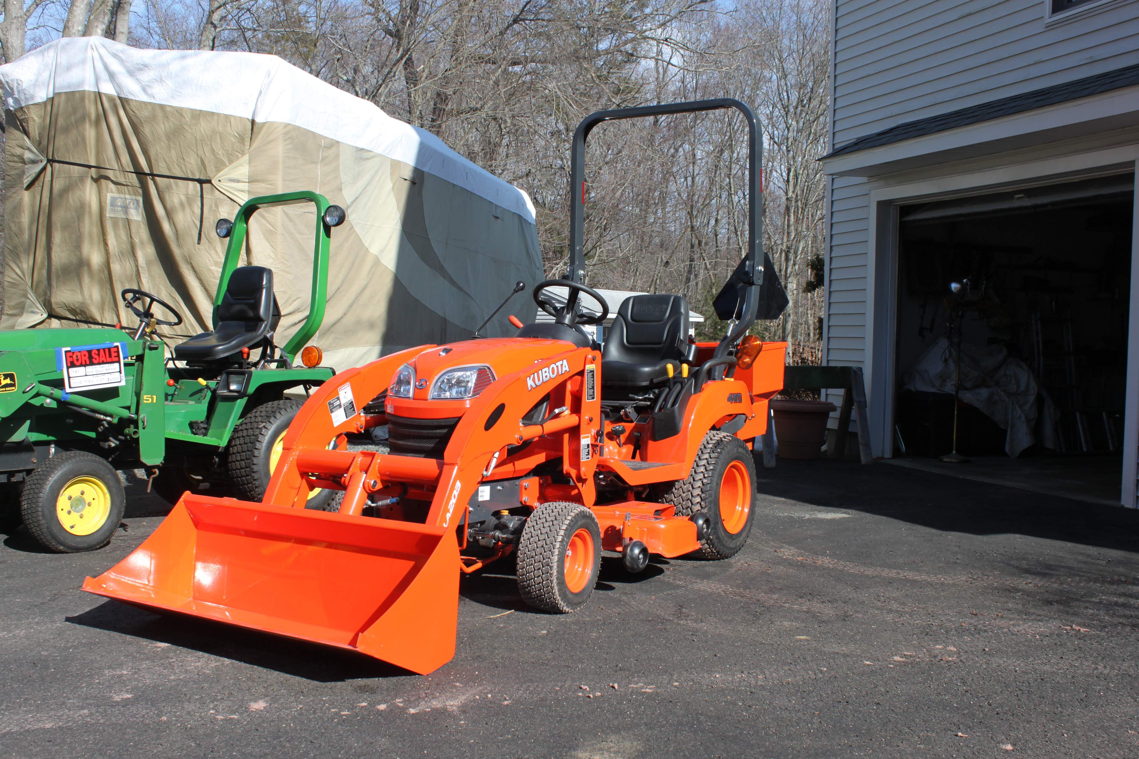

Tractor arrived to day and it looks as if everything has been corrected. Loader comes off and on easily now. Mower height adjustment works. No leaks apparent. Even corrected a small wrinkle in the deck matt that didn't bother me. They ran the tractor about an hour since I last saw it. I'm satisfied that the dealer did all the right things and I now have a good tractor.
And it fits in the shed!
Now I'm reading the books and trying to visualize how to get the mower adjusted and making a materials list for the periodic maintenance.
I think pictures should be attached if I did it correctly.

Congrats. You are going to love that tractor. I have done more with mine in the 8 months I've owned it than I did with my Cub in the 18yrs I owned it. So much to do and so little time to do it. Have fun.
/ Almost New BX1870 Owner #19
Tractor arrived to day and it looks as if everything has been corrected. Loader comes off and on easily now. Mower height adjustment works. No leaks apparent. Even corrected a small wrinkle in the deck matt that didn't bother me. They ran the tractor about an hour since I last saw it. I'm satisfied that the dealer did all the right things and I now have a good tractor. And it fits in the shed! Now I'm reading the books and trying to visualize how to get the mower adjusted and making a materials list for the periodic maintenance. I think pictures should be attached if I did it correctly. Wayne<img src="http://www.tractorbynet.com/forums/attachment.php?attachmentid=365272"/><img src="http://www.tractorbynet.com/forums/attachment.php?attachmentid=365272"/><img src="http://www.tractorbynet.com/forums/attachment.php?attachmentid=365272"/>
And look... the one next to it is green with envy! LOL

Looks real nice. Glad it all worked out for you. I see your in Orange CT. I'm down there a fair bit to see a doctor and my inlaws live there. I also go to Knights power equipment for parts for my old Wheel Horse. Guess you couldn't get a competitive price from F&W? I've stopped there a few times to look at what's on the lot. They tend to have a good bit of construction machinery - Kubota track loaders, excavators, and TLBs. I did buy a used snow plow for my BX from PA but bought my BX locally from Kahn's in North Franklin. Again, good luck with your new SCUT. Nice day today to put some hours on it.
