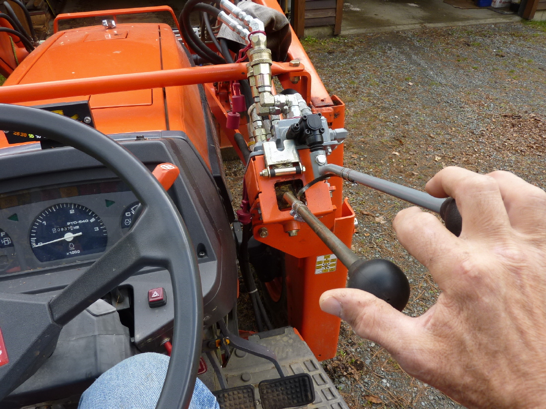

Hi all, I have been thinking about a third function for my loader, but don't really want to spend the $$$ for the electronic 'button' type. Is there any reason why an open center single valve couldn't be plumbed into the power beyond port then continue on to the rest of the system?
I was originally thinking of using one set of rear remotes, but that lever is next to and just below the seat. My loader control is on the loader frame. I was thinking having another lever up by the loader control would be easier to use / operate.

Sure. It will work, it has been done before. Some people even managed to mount that valve on a good location that doesn't take much effort moving the hand from the joystick to the lever.
Pros: You get the ability to feather the cylinders, instead of On/off like the solenoid valve setup
Cons: Just the fact that you need to move the hand from the joystick to the lever on the new valve instead of simply pressing a button but it's that big of a deal to be honest.
Don't forget to get the right PB sleeve/fitting for the new valve, so you can feed the rest of the hydraulic system properly. The Tank port will Tee together with the other tank port on the loader valve.

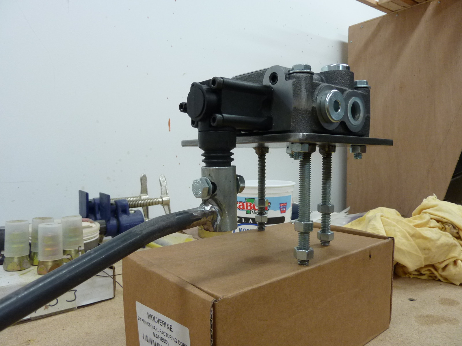

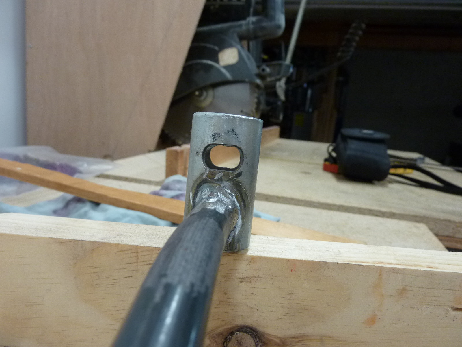

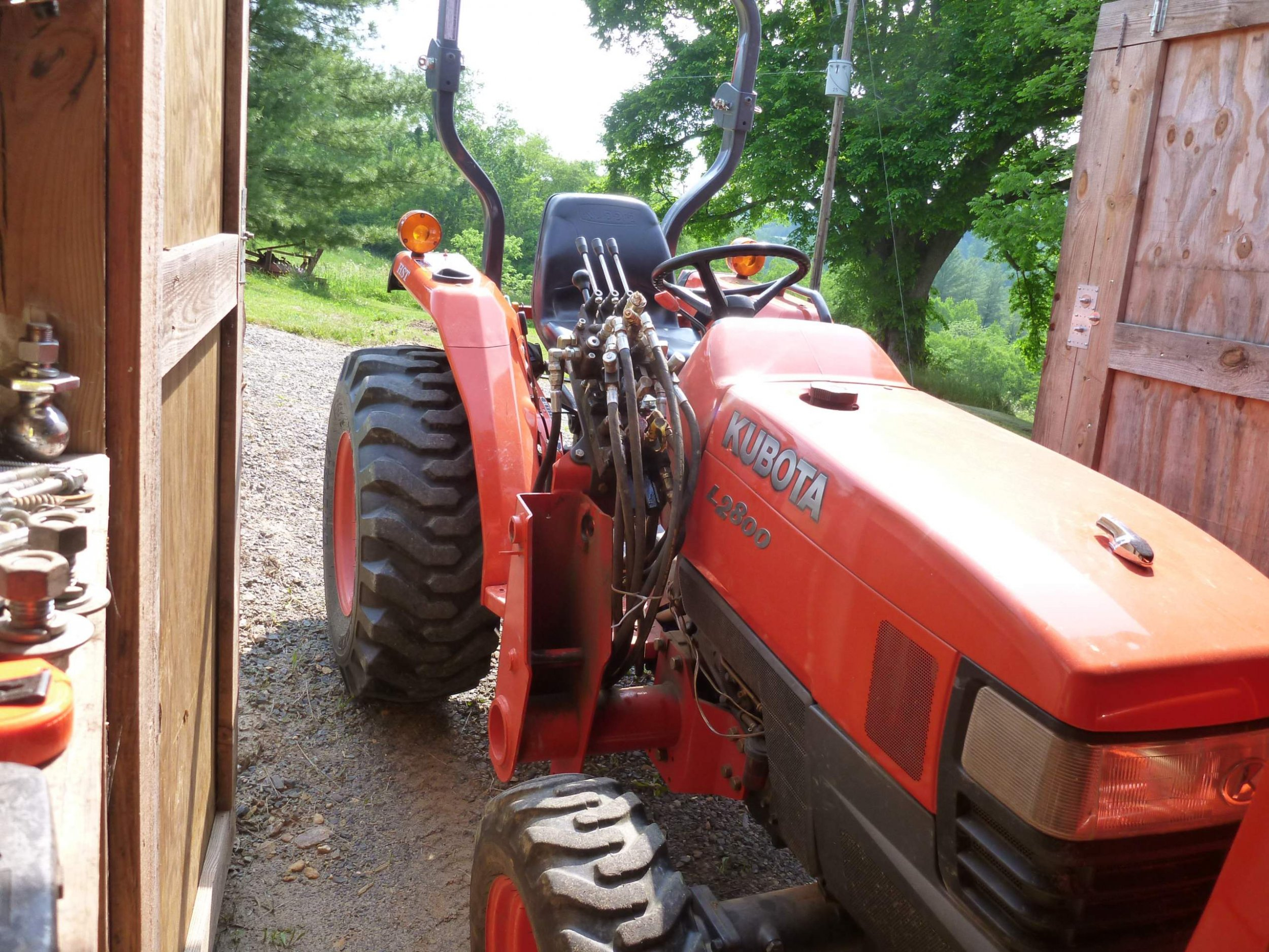

It's basically what I did, I mounted not a single spool but a 3 spool valve (other two are top-N-tilt hydraulics), as for the having to reach for another lever. It doesn't slow me down and cost wise it was very light on my budget. If pressing a very expensive button is your thing, no problem. I like to keep my money in the bank.

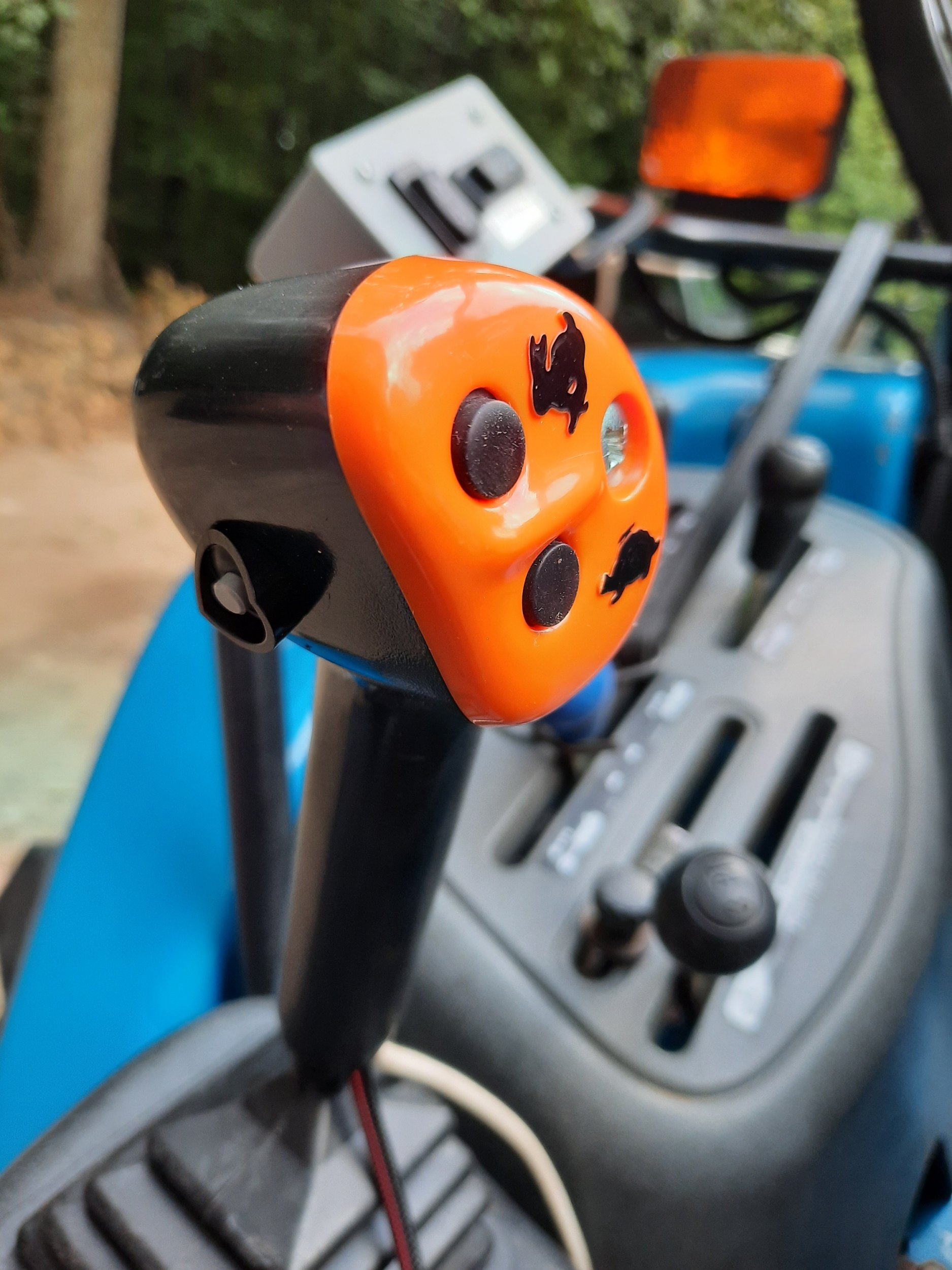

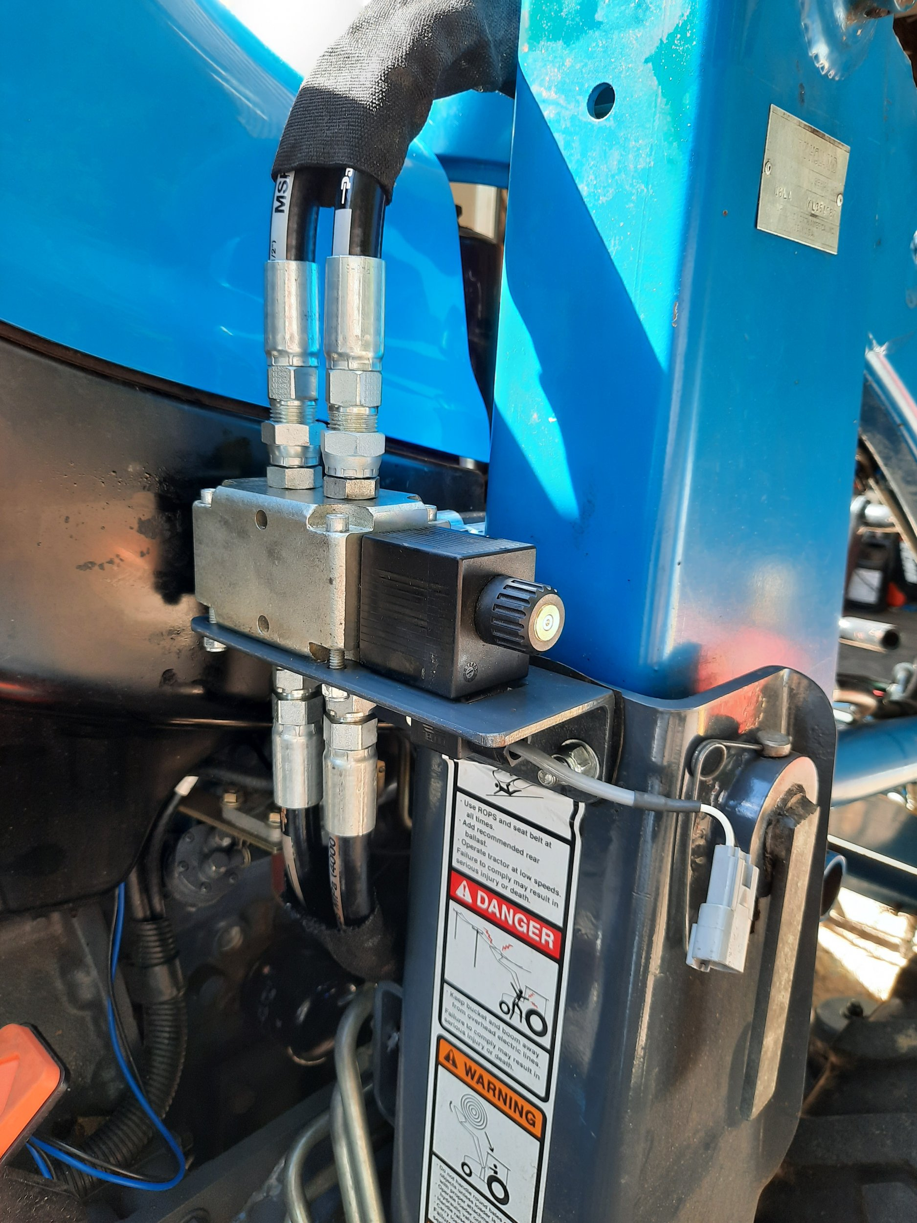

I agree with everything LD1 said.... especially the above ^^^ For our purpose I could never see where a true 3rd function would be needed nor would I want to have an additional lever to control our grapple or the tree post puller. Just push the button & never need to move your hand from the loader valve lever. And it was much less than doing a true 3rd function.

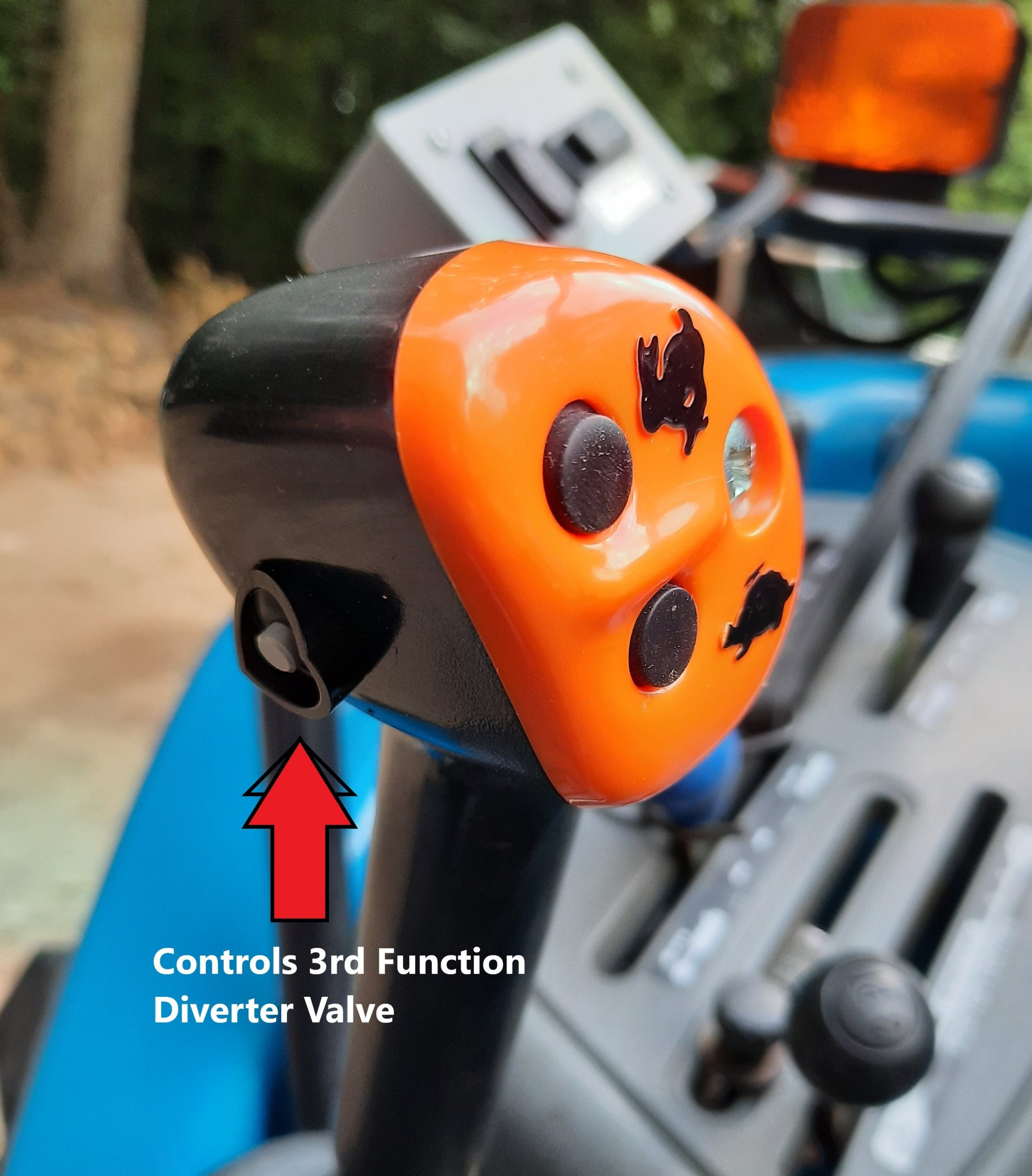

@dlctg that's a slick looking joystick handle with all those buttons. Did that come with the tractor or is it aftermarket?
Many 3rd functions use an electronic valve and two loader joystick buttons, one for each direction. The valve is usually priced a little cheaper than a diverter valve but depending on the install details the hoses may cost a bit more. A replacement joystick handle with two buttons instead of one might cost a little more as well. But they're roughly the same cost if you DIY or use the kit from Summit.
I'm still using a rear remote whose handle is close to the loader joystick. While this set up can feather I don't do it. I keep it on until the grapple lids stop moving.

@ericm979 - I only added the momentary switch for the 3rd function diverter valve. The other two are the HI / LO speed selector buttons for the HST.
We use the feathering feature all the time, especially with the tree / post puller (it will cut smaller saplings in half if it is closed to hard). Also it is nice to use on the grapple when placing / stacking rocks.
Our diverter valve came with a switch as part of the kit, but I didn't like how I was going to have to surface mount it, so I installed this one. It is in a very easy location to use without moving your hand from the loader valve controls. Arrow is the one I installed...
