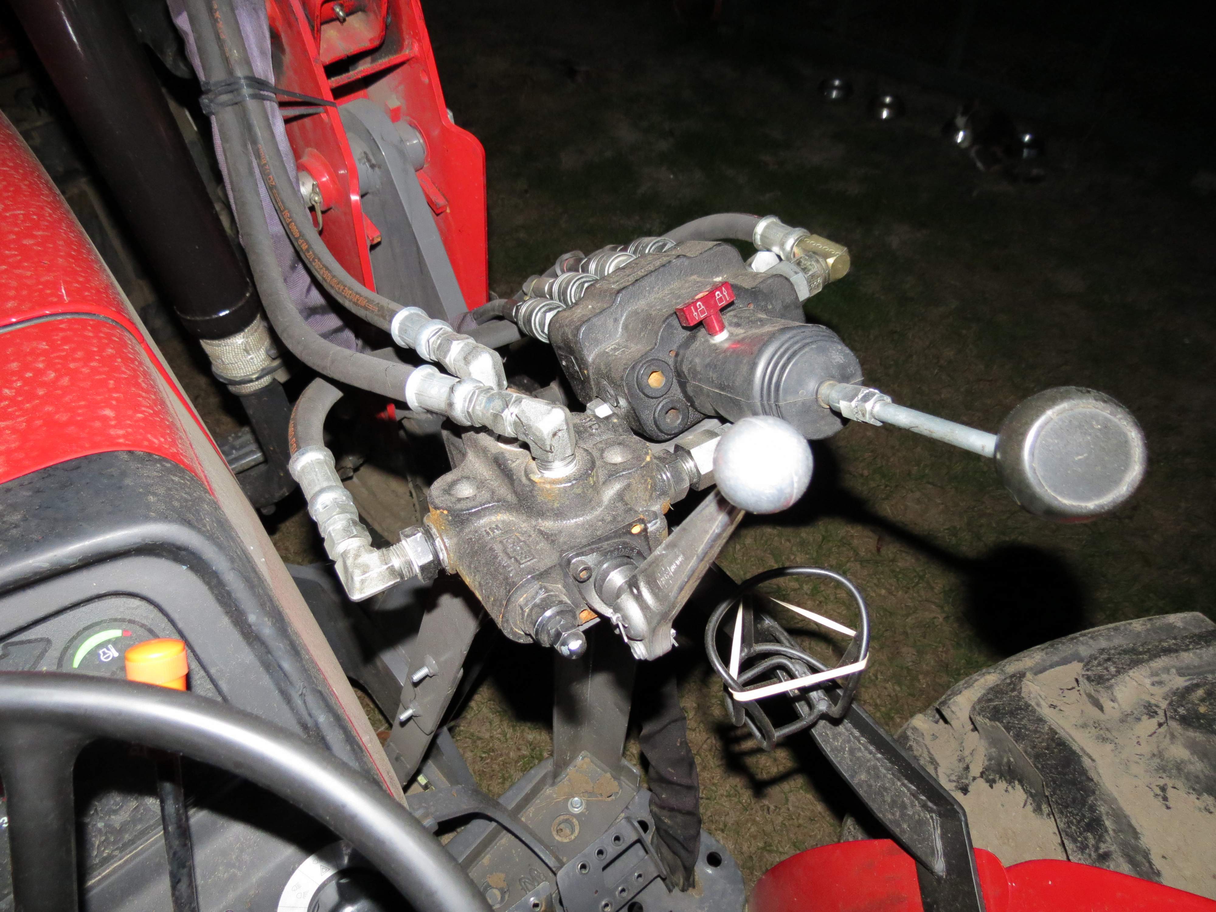

I'm wanting to add a 3rd function on my FEL for a grapple. I've got a L3710 with no remotes anywhere, so I'm starting with just the FEL valve (it does have PB). I like the kit the W.R Long has, but can I save $$ if I piece together my own kit? Would it be worth the trouble, or is it better to just go with W.R Long?

you can build your own for less than half the cost of the wr long. Without any electrical components which are expensive to replace and are the weak link in a third function set up.

Looks simple enough. Is it just plumbed in the PB line? Can you explain how you did it and what parts you bought?
Thanks

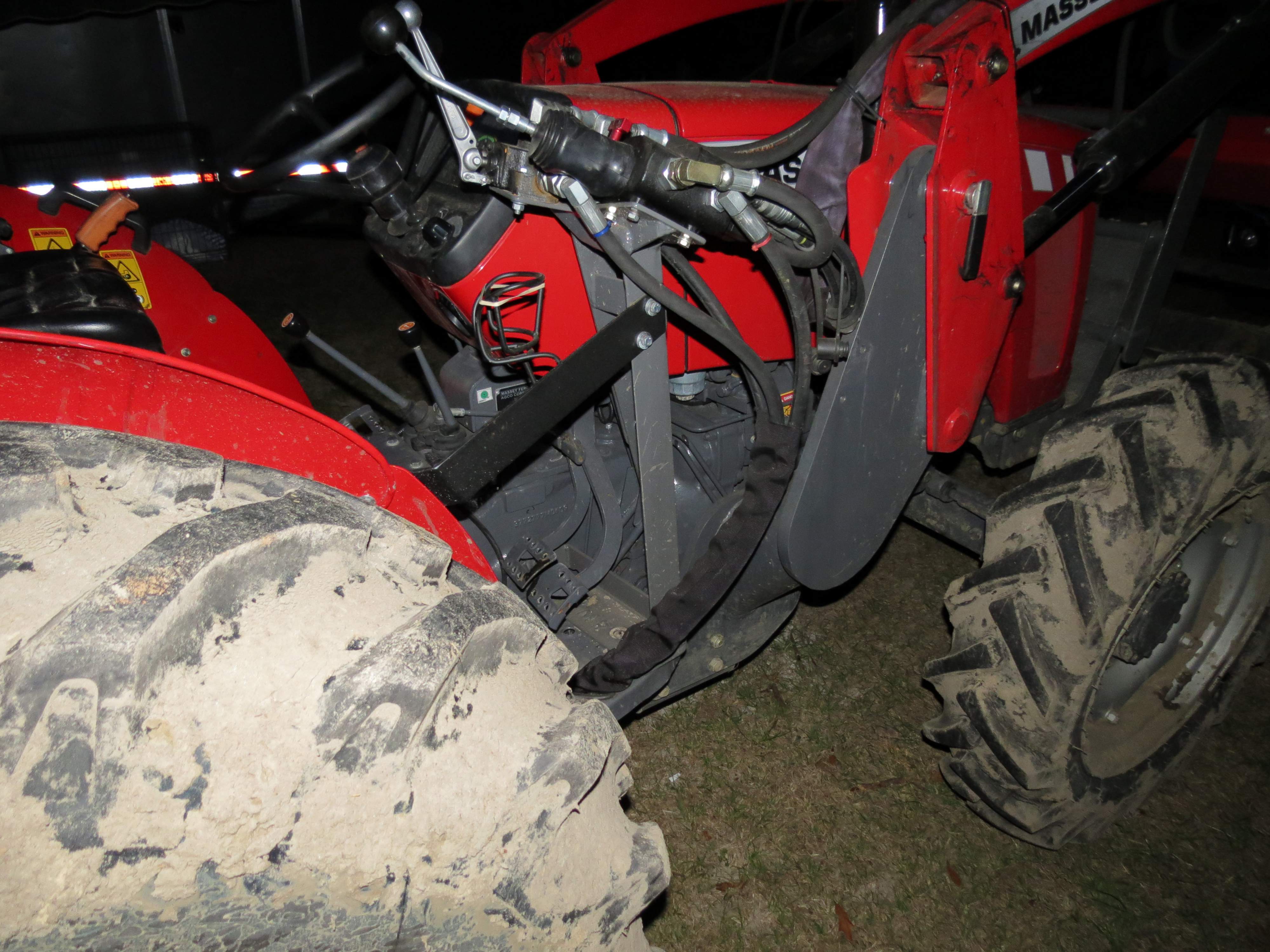

Like that 3rd func. valve install teampryor:D Room for such is an issue on some tractors, like on my jd790.
I agree on the electric over hydraulic stuffs as "just something elts to go wrong". But in some cases its easier to run wires and a switch as the only feasible way room will allow.
