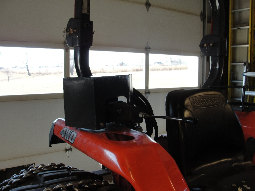

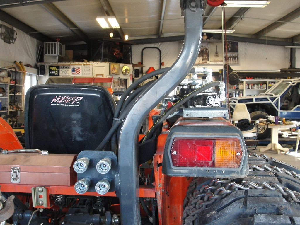

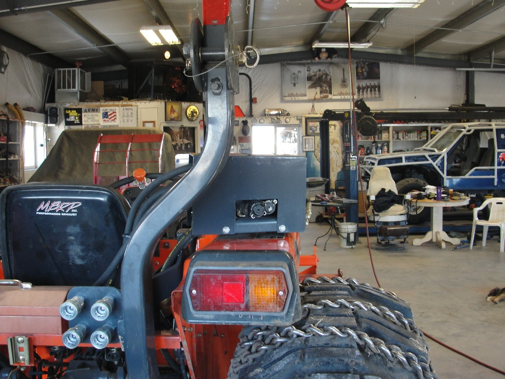

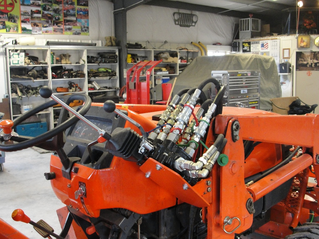

My previous tractor had the FEL valve located on the FEL frame. It was a joystick. I purchased a valve from Surplus Center that had a joystick with a push/pull valve added to the side. Worked great.
Then I took the original joystick valve and mounted it on the right tractor fender. Plumbed it to create two rear remotes.

I'm using a regular rear remote type valve mounted on the fender. I can feather with it. But I never do. I hold it down until the grapple lids stop moving, or until it looks like they have gripped as hard as I want. My grapple is a dual lid model so the lids move slower than a single lid would. But if your lid(s) moves too fast you can add a restrictor to slow them down.
I use my grapple for logs and brush mostly, but it's grabbed and carried all sorts of things. I leave it on the tractor all the time and use it a lot. I've never wanted to feather it for any task.

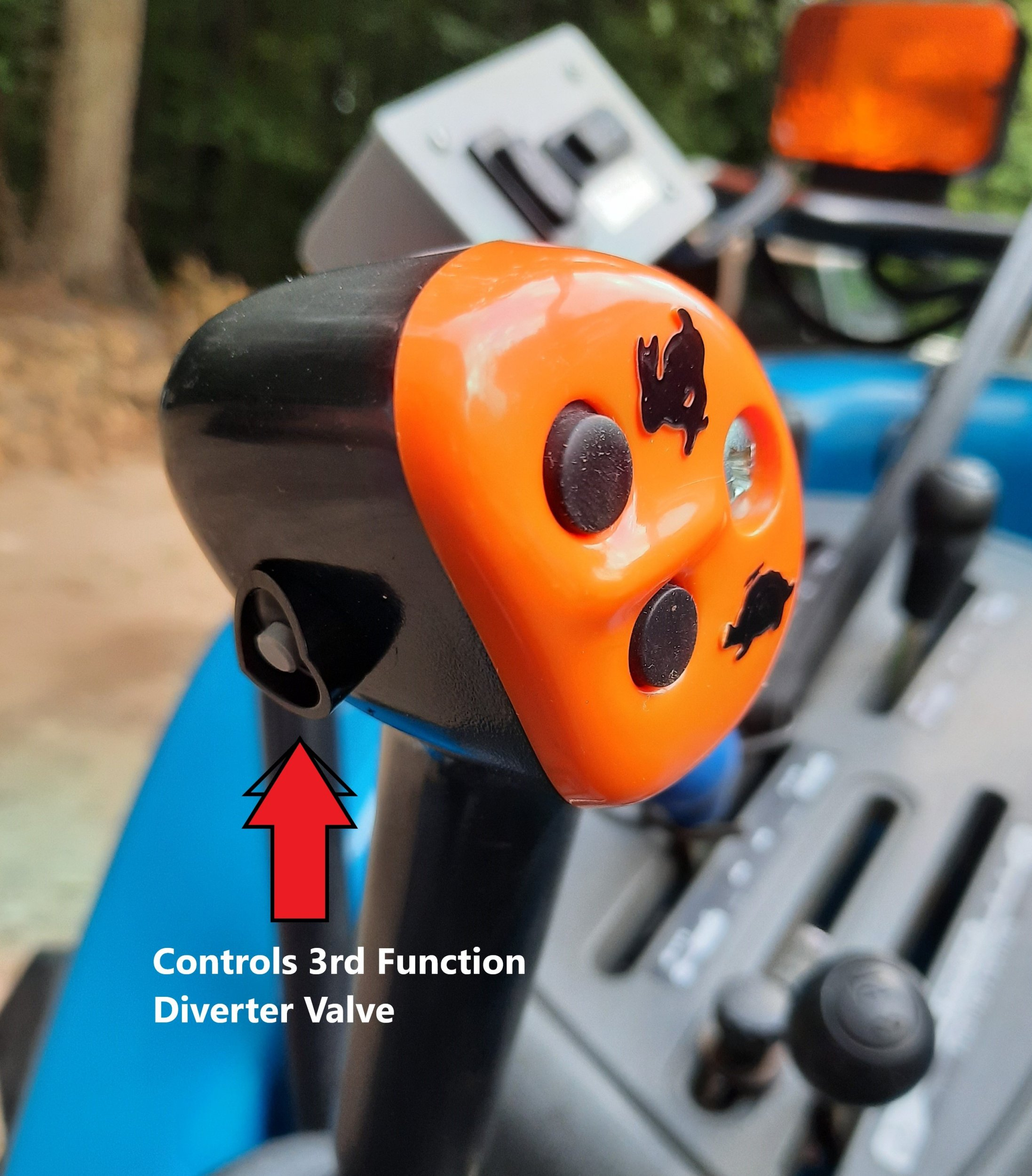

@ericm979 - I only added the momentary switch for the 3rd function diverter valve. The other two are the HI / LO speed selector buttons for the HST.
We use the feathering feature all the time, especially with the tree / post puller (it will cut smaller saplings in half if it is closed to hard). Also it is nice to use on the grapple when placing / stacking rocks.
Our diverter valve came with a switch as part of the kit, but I didn't like how I was going to have to surface mount it, so I installed this one. It is in a very easy location to use without moving your hand from the loader valve controls. Arrow is the one I installed...
dlctcg, can you provide me the make and part number for the switch you have for your 3rd function, also where you got it at?
I have a TC45DA and it has been that same joy stick and that’s the first switch I have seen that looks like it works good on that joy stick.

@dieselscout80 - I did search all over for a switch that we were going to be happy with, & that had a small enough switch body to fit in the joystick; that also could handle the elements & abuse... There are others but we do like how this one fit & works...
As to not feel like I'm hi-jacking this thread with a ton of switch info not relevant to the OP's post... I'll send you a PM on the switch & configurations there are a bunch of options...
