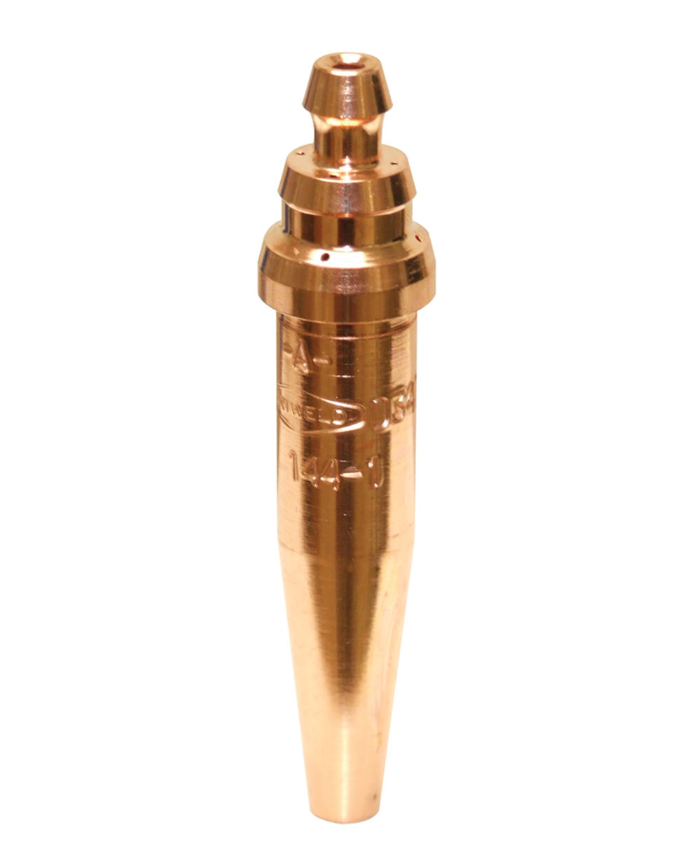

Post clear pics of your torch tip REMOVED FROM THE TORCH, side view, of your torch handle, and of the cutting attachment.
I like straight torches for cutting, but you should solve your tip problem first by knowing what your torch takes so if you get a straight torch later you can have matching tips.
Post your exact torch model number if you will have a delay posting pics and I'll attempt to look it up.
We'll figure something out. The Blueshield website is horrid but tip pics will tell the tale. The very few pics I see look like Airco tips. Tip designs go back many decades (I'll spare the welding history and patent war lecture) but here's an Airco-style (made by Uniweld) tip:
I am actually on vacation right now, so I wont be able to get pics of it for about 2 weeks. It is the DUO-2 light industrial kit, if that helps at all. The pic of the tip you posted looked a lot like it.

Ok I have done a lot of digging around, and I think I have determined the tip style of my torch. From what I can tell, air liquide torches are made by concoa, which bought out the airco torch line. Also, I have compared pictures of air liquie tips, and airco tips, and they are the same. I have also compared pictures or the torches and regs, from concoa and air liquide, and they are the same. So I am 99% sure my torch uses airco style tips.
Here is a picture of the air liquide tip.

Koike tips look very similar to Airco too.
/ alternative fuel gas #17
Airco, Koike, Concoa, and clones interchange as they are based on the same Airco patents. I've swapped plenty of Koike and Aircos and generics. I haven't bought any Concoas since Airco are so plentiful.
Grab some tips off Ebay etc and have at it!
Also, LOOK at the distinctive Airco tip base, because many Ebay sellers have no torch experience and YOU knowing what they are selling is an advantage.
If you look for a straight torch, the classic Airco corncob style (steel head preferred) are well regarded. Concoas sometimes turn up used too.
