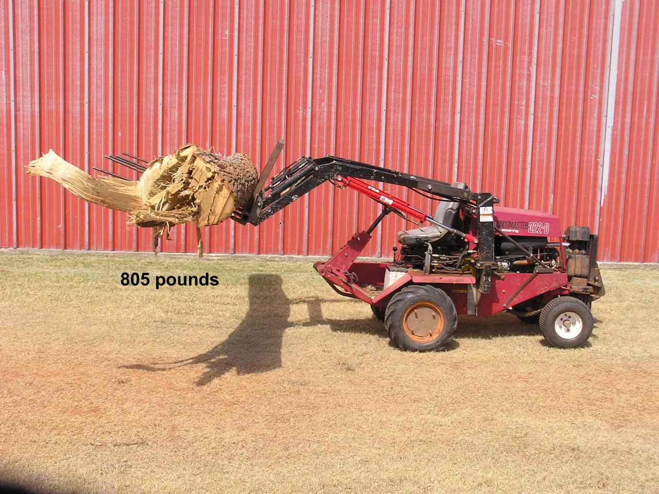

MultiMow, I am interested in your machine. I sold my Utility tractor soon after I bought my first compact telehandler, a Bobcat V518, seven years ago.

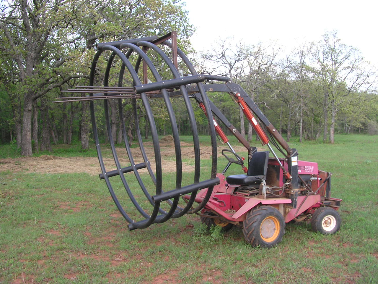

I recommend a non pivoting axle under the loader, like my put together machine:
I was trying to figure out what the heck that round attachment was.... :laughing:

On the Power Tracs, there's a wheel motor at each corner. The joints between the front and rear sections not only allow for side-to-side articulation for steering, they also allow for oscillation on the Z plane. I think its something like 12 degrees either way. That way, there's much less chance of any of the tires leaving the ground. If you don't allow for oscillation on an articulated vehicle, any time one of your tires goes over a bump, some other tire will most likely come off the ground.

   / Alternative "sub-compact" tractor solutions #36
Here is the front view, the diameter is 8'. :D
