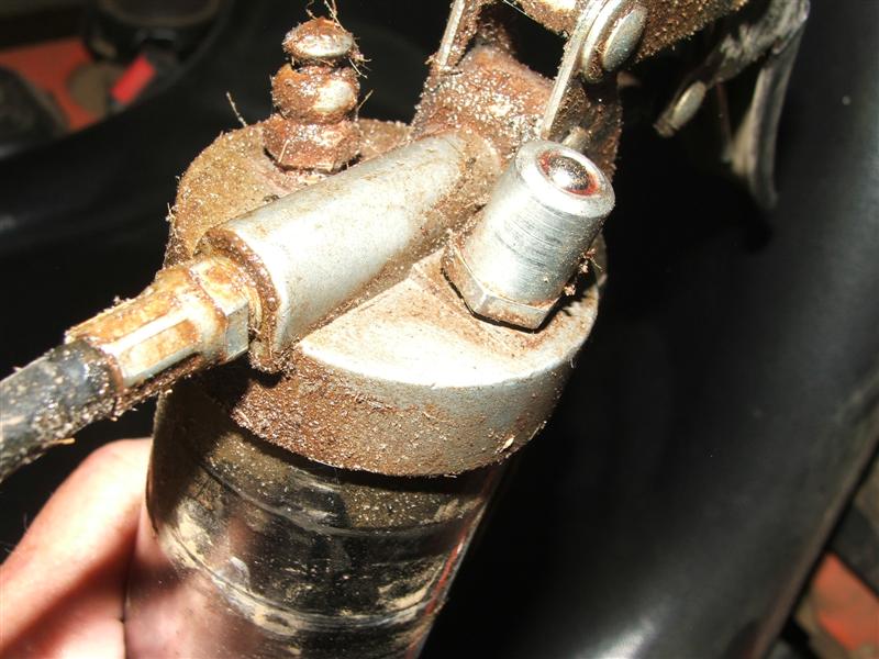

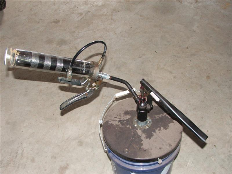

If your electric grease gun has the filler nipple and it is the correct size to fit the bulk filler, yes, NAPA auto parts stores can get the correct size nipple.
First pic is the nipple, shiny thing on the right, in the gun.
Second is the filler that the gun nipple fits into in the bulk filler.
Third is the gun connected to the filler, have to hold the gun into the bulk filler as you pump the handle on the bulk filler.

For the cordless grease gun you just have to add the filler nipple. There is a plug there as it comes.
