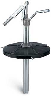

Can anyone guide me as to how to actually assemble this thing? It came without instructions. I assume that you fit the rubber gasket ring inside the hole of the thin metal top plate and then put that down on top of the bucket. then it seems you push the pump shaft down through it and secure it to the bucket with thumbscrews. Is that right?

Here's a picture that might help, mine also had a follower disc that had a hole in the center that fits on top of the grease in the bucket, I put the follower disc in the bucket and pushed it down to get all the air from between it and the grease, then insert the tube of the filler pump through the hole in the follower disc in the bucket till the tube reached the bottom of the bucket, I then slid the cover down the tube to the top of the bucket and tighetned the thumb screws around the edge of the bucket, also tighten the clamp screw on the tube. Hope that helps.
David, hopefully they will send you a complet unit, I will get you the part # for the grease gun nipple when I go to town this week. When I got my bulk filler from Northern Tool a few years ago, it was missing a part and when I contacted them, they sent me another complete unit, hopefully your seller will do the same.
