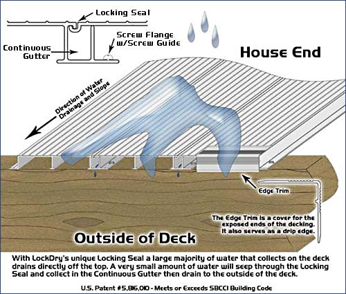

I've been considering aluminum decking to replace ours.
Our deck currently is about 3" of exposed aggregate over what should've been a layer of bituthene, and thus theoretically watertight, because part of the deck is over an enclosed area (and another part is over a hot tub area and thus the deck needed not to drip through there either). The reality is that it's leaked here and there, and there's evidence it's because the concrete people didn't pay attention when setting forms and destroyed the bituthene... anyways
so I've been looking at alternatives for this, because we're probably going to do a complete tear-off, and I found "LockDry" aluminum decking that looks pretty decent:
The concept looks good to me; for our deck besides the tear-off and repair of any damaged joists (and whatever other bad stuff we find) I may need to fur the joists for proper slope (depending on how the joists are sloped currently).
Does anyone have experience with this decking system?

I haven't gotten a price yet.
We got a bid for a different allegedly waterproof deck system which is basically a very thin texture layer of cement over thin plywood painted (every 5 years) with an epoxy coating, and that stuff was e x p e n s i v e and I have doubts it would hold up.
After that, I went looking for alternatives and found this. I'd guess it'll get warm in the summer, but not warmer than our present 3" of concrete (that gets hot enough it's tough to stand on bare foot on the really hot days) - and it'll have much less thermal mass as well which will help evening cooling a lot.
From what I can tell, everything's going to be expensive and I hate decks more every day. Regardless, this needs repair & replacement, so I'm looking for a good thing that's going to work, practically regardless of price, as I doubt there's much difference overall.
I'm sure it'll be cheaper than redoing the concrete, plus I have zero faith in this concrete system now...

[I was going to reply to this thread but decided not to hijack... ]
View attachment 719134View attachment 719135

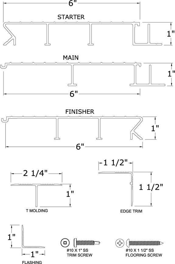

Reading the FAQ for the lockdry stuff, there's this:
6: How should LockDry decking run with the house?​
My joists run from the house to the edge of the deck, so I'll be looking at either (A) or (B) above.
Note here in (B) they say "Cover the deck with 3/4" pressure treated plywood to fasten to" (currently about $58/sheet here, ouch); they don't say not to put the aluminum directly over that. They do supply stainless fasteners, though.
