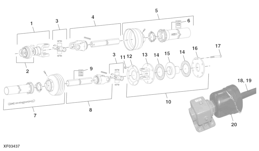

I have turned the PTO shaft to align the holes up to the shaft on the cutter gear box. They align perfectly from top of holes to bottom of holes but not from front to back. Neither the old bolt or the new bolt will move beyond the edge of the hole. It's not even a matter of a tight fit or getting half way and getting stuck. There should be a round hole to slide the bolt through but it looks like one of the two components is jacked at an angle. One one side it looks like the gear shaft hole is too far back at the front of the PTO hole and on the other side the Gear Shaft hole is too far forward in the back of the PTO hole. Is this a manufacture defect?
The original bolt has wear and damage at both spots where the holes would touch the bolt Is this normal wear? Notice how the PTO shaft has wearing on the front of the hole on one side, but on the other side it is at the back of the hole. Is this normal?

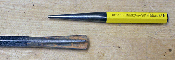

I have the same RC2072 for about 10 years now. I have a clutch to try and avoid shearing the 1/2" bolt. Have sheared it 4 or 5 times in pretty rough service anyway. I have replaced the stump jumper pan and even launched a blade. Bolt in tack blade split at the hole(Never found it either) Grade 8 is what I started with and what I have there now but grade 5 held up about the same. You just need a pointed taper pry tool to align the holes. There may be a little metal displaced that a rat tail file can clean up to. It's possible to gall the shaft and coupling it you are spinning it with out the bolt. My last break left the bolt in the shaft and cut both ends off. It still just required driving out the slug which aligned the holes and tapping a new one in.

It is obvious that part of the sheared bolt is stuck in the hole. Find a punch of equal or a bit smaller than the hole and try to drive out the stuck piece of bolt.

If punch fails, try drilling out the holes from both sides using a 1/2" drill bit.
