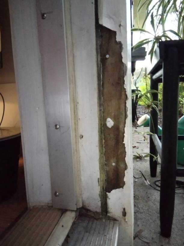

I wonder how it will or won't react to pressure treated wood?
When I had the rear door on my house replaced the wood framing had rotted at the bottom. They cut the rotten part out and replaced it with pressure treated then put the aluminum flashing back on. The flashing is now disintegrating. I am going to have to replace it with vinyl flashing I guess.

This is what happens to anodized aluminum flashing on pressure treated wood.

This is what happens to anodized aluminum flashing on pressure treated wood.View attachment 719458
Definitely ugly. The Dryloc is powder-coated and supposedly can go directly on pressure treated lumber.

Corrosion with Brown Pressure Treated is more of a problem for me than the Green Pressure Treated.
