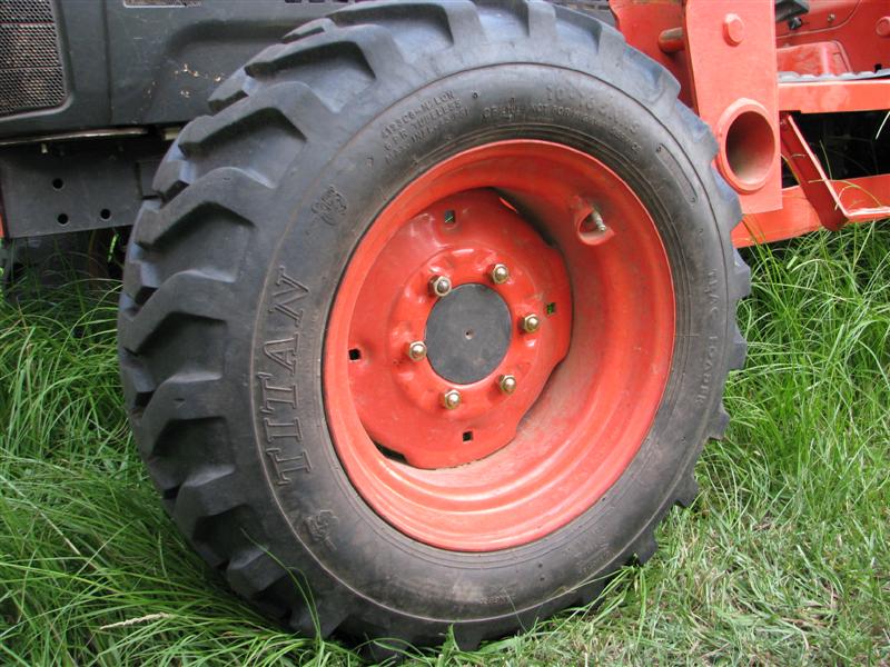

I had bush hogged Monday night and was making a counter-clockwise pattern so I was watching my line with the front right tire. Tuesday I started on another pasture and was going clockwise and watching the front left tire. I only made it about 300 feet when i noticed the wheel was wobbling really badly. I got off to inspect.

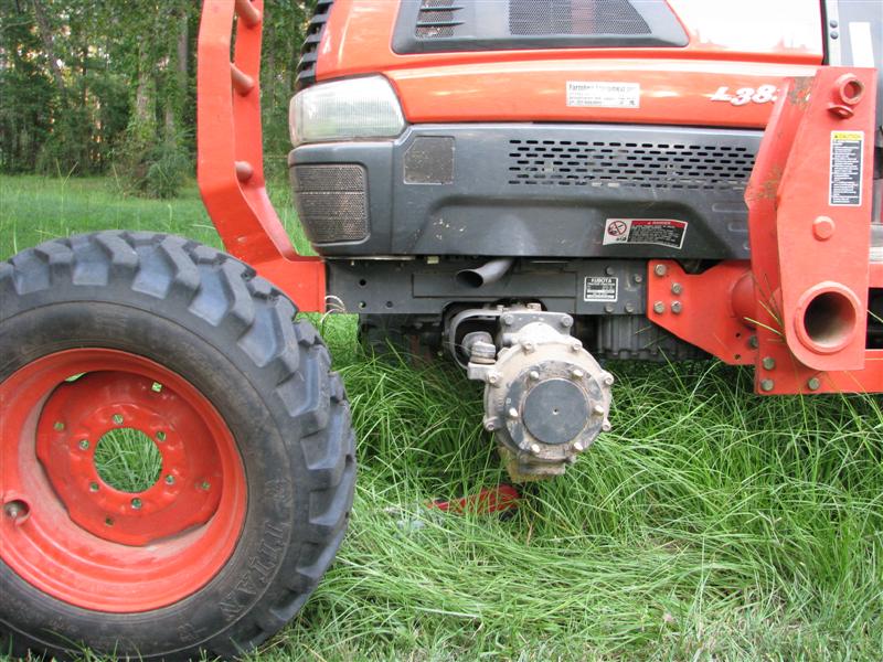

I guess I'm just lucky that sixth bolt didn't come off. I would have hated for the front end of the tractor to go down like that. Notice not only are the nuts gone but also the wheel studs. Of course I had taken the front end loader off to bush hog so I had to manually jack up the front axle. Five new studs and I'm almost back in action.

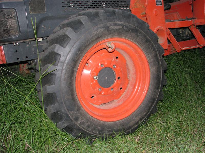

I had to fix a flat on the other front tire about a year ago so I double checked those lug nuts yesterday and they are all tight. These may have worked themselves loose over time as I will admit that I've never bothered to check their tightness in 300 hours. Five new nuts and I'm back at it.

I,m glad You caught it in time :eek: . You said the studs were missing , as in broke off . Kind off looks like it from the pics or did they unscrew ? . Bob
/ Always check lug nuts frequently #6
Look snapped off in ther pics...I think that maybe replacing the 6th one would be prudent, as it was no doubt stressed beyond normal, and is a prime candidate to fail next....
I assume they unscrewed, but I'm not sure. There was no damage to the threads and I had no problem screwing the new studs in. I didn't think about replacing the sixth stud.
